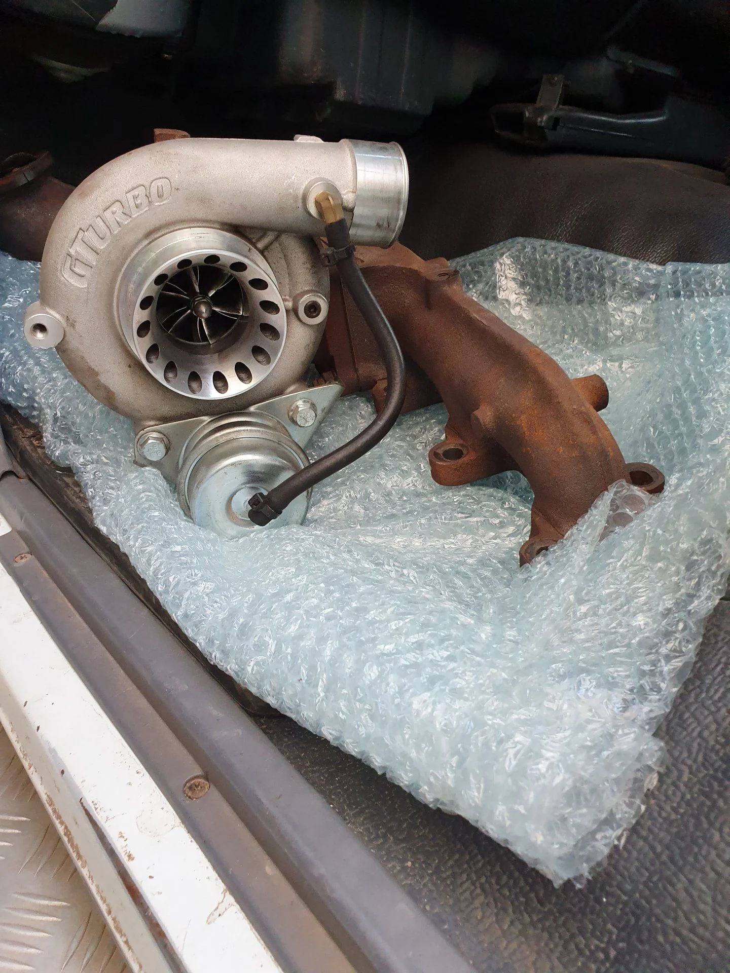

Today I spotted the vacuum hose is disconnection. Where does it needs to connect? Thanks for any advice. :)

Looks like it should go to the wastegate, but not certain from that photo

Has it been blocked off by a previous owner, or did the nipple on the wastegate actuator break off? The hose it supposed to deliver a boost pressure signal to the wastegate actuator so the wastegate opens (at around 10psi if stock). Without it, the wastegate would never open, allowing the turbo to boost as high as the fuelling level will allow (ie way too high!).
Has it been blocked off by a previous owner, or did the nipple on the wastegate actuator break off? The hose supposed to deliver a boost pressure signal to the wastegate actuator so the wastegate opens (at around 10psi if stock). Without it, the wastegate would never open, allowing the turbo to boost as high as the fuelling level will allow (ie way too high!).

So you've got a long vacuum hose that goes from the turbo compressor housing to the wastegate actuator, but it's broken in the middle and a chunk of metal in one of the ends at the break? Or what exactly?
Vacuum hose should be connecting the turbo compressor housing nipple to the wastegate actuator as shown in the pic earlier in the thread. If someone was installing a manual boost controller, it would go in the middle of that hose, which I'm wondering is what's happened here at some point.
