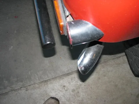

Here is a closeup of the exhaust. One exits on each side of the vehicle, behind the rear tires. I have been over every inch of the exhaust and have not found any leaks on the exhaust itself. The fragrance is definitely a problem.

Once I saw what was happening, I installed two extremely dorky exhaust tips which have a little bend in them. I aimed them out the back at an angle and now, with the leaned carb, I can actually drive without watery eyes. I suspect it will be even better once I put the top on tonight!
I can't make my camera load, but I'll try to add pics of the exhaust tips for your viewing pleasure.

Finally, here are pics of the cheesy pipe ends which seem to have really helped. Good luck.
