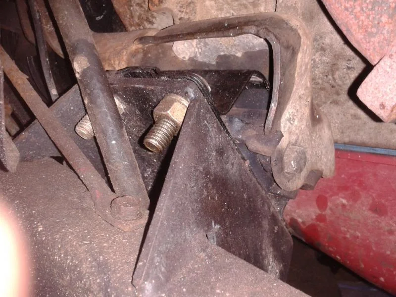

Mine
Hey Lane, I did a little more traditional mount using GM motor mounts, I think they were $12 a piece. My motor does sit low in the frame though.
Do you still want some help to do your carb this winter?
