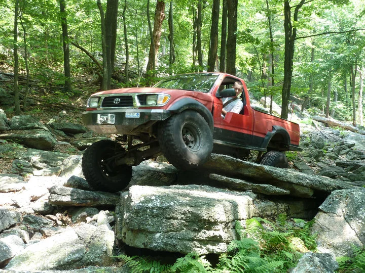

Going back to 2007, 95 Tacoma I built on FZJ80 axles. Took the truck apart about 10 years ago to fix some things and its still sitting on jack stands.

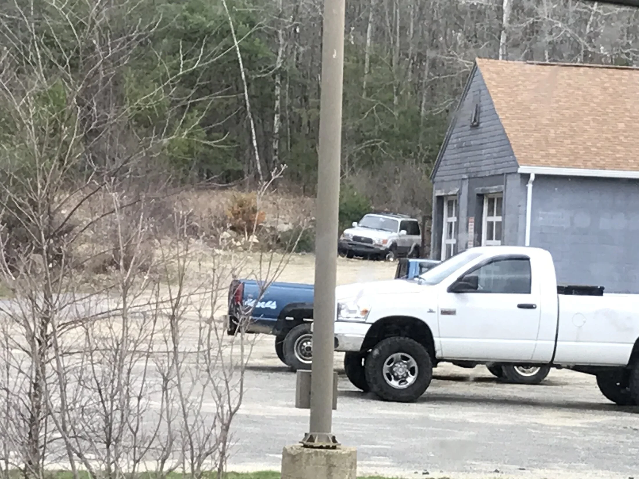

2020 during the beginning of COVID I spotted this 80 sitting behind a shop nearby.

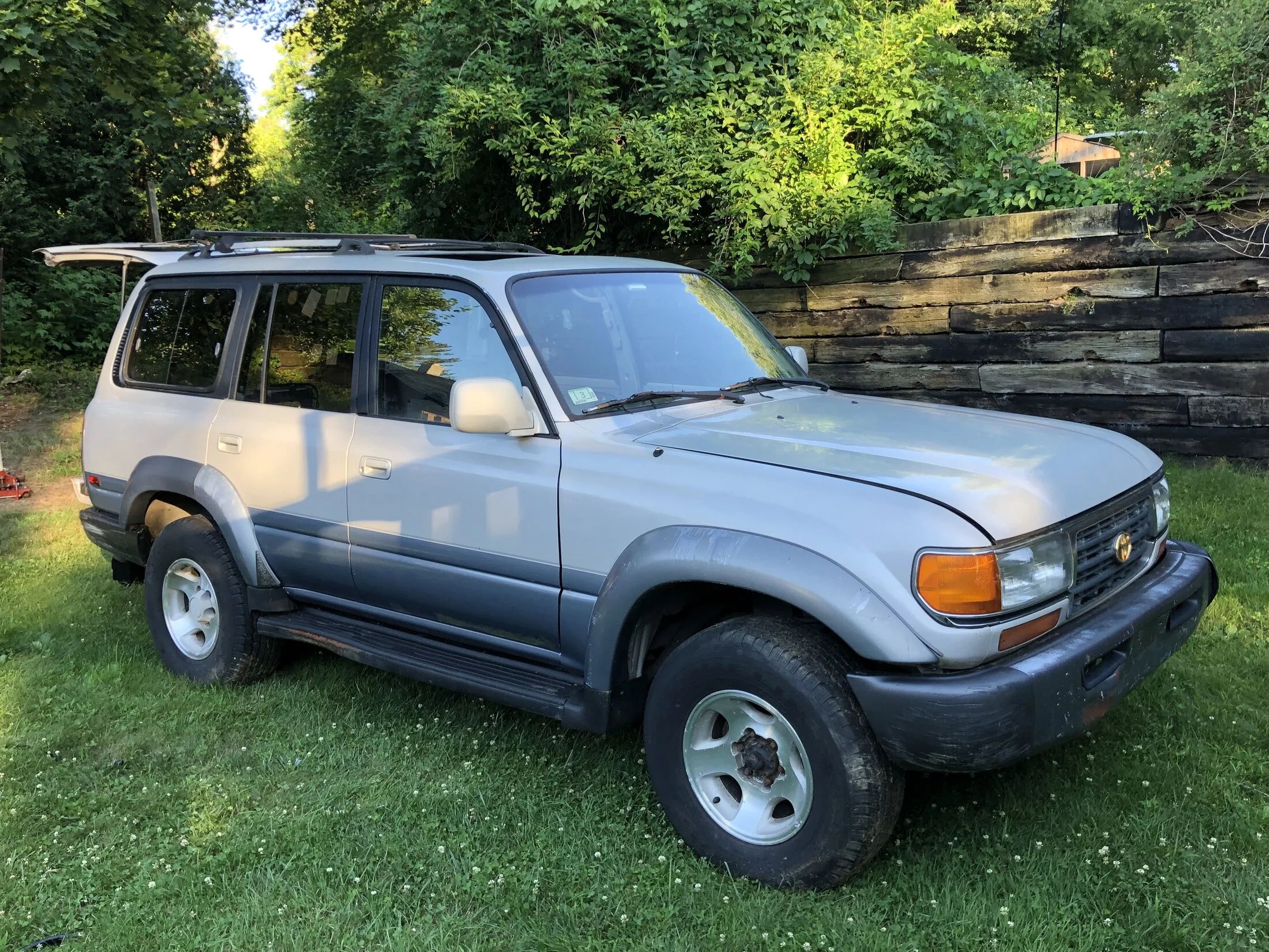

2 years later I finally stopped in to ask about it. It was a total mouse house but underneath was pretty clean especially for a New England vehicle. It had been sitting for 13 years and the owner of the shop didn't even remember why it was parked. They called me back later in the day and told me the owner didn't have the title and it was just going to be sold to a scrapper.
Told them I'd buy it as parts and picked it up a few days later for $600.
First order of business was evicting all the mice and cleaning up thier mess. I ended up somewhere around 20.
Before getting too far I wanted to make sure it ran. Drained the tank and replaced the fuel pump. Used vinegar to clean the inside of the tank before putting it back in. Fired right up and didnt miss a beat. Not too bad after sitting for 13 years.
Disassembled the HVAC box to clean the mess made from the mice. Refoamed and painted all the doors while it was apart.
After a bath it didnt look too bad.

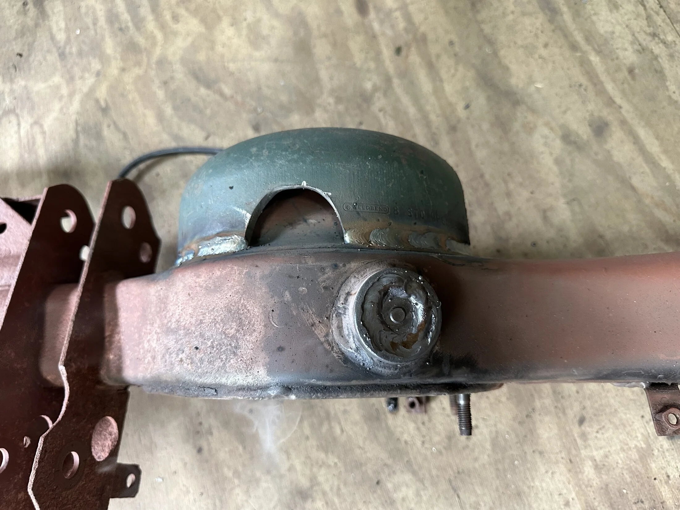

Swapped in the rear elocker diff. Had a couple of elocker motors from Tacoma diffs laying around. Built a housing to convert the rear elocker motor to that style.

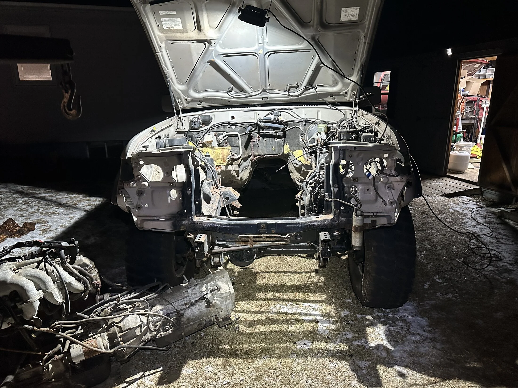

The ultimate plan for this 80 was to 2UZ swap it down the road. Ended up finding a 06 Sequoia locally for $1200. That made the project progress a little quicker.
Posted my drivetrain for sale figuring it may take a while to sell while I worked on getting the Sequoia stripped. Ended up with a buyer right way. January in New England isnt the best time to be stipping 2 vehicles but I got it done before heavy snow.

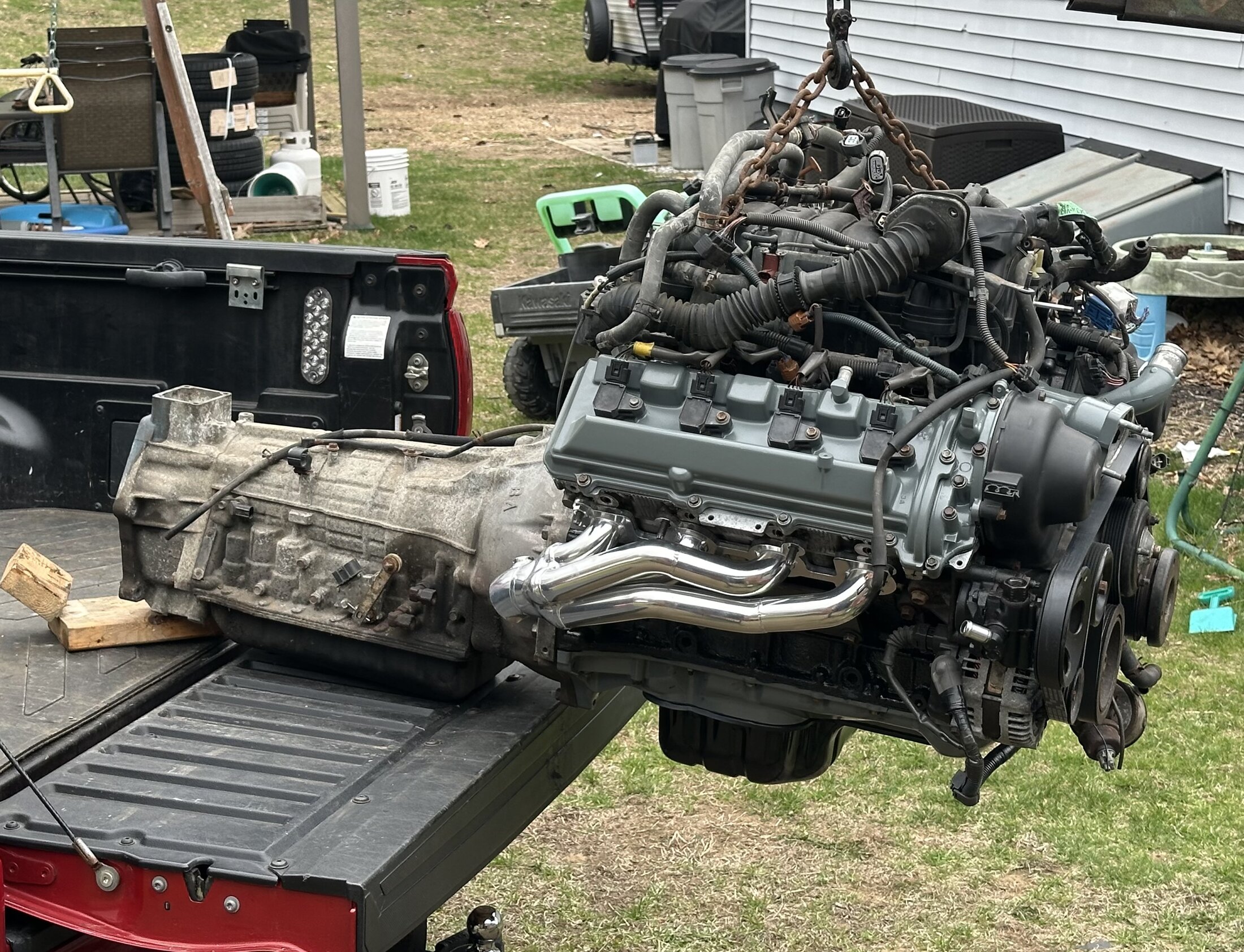

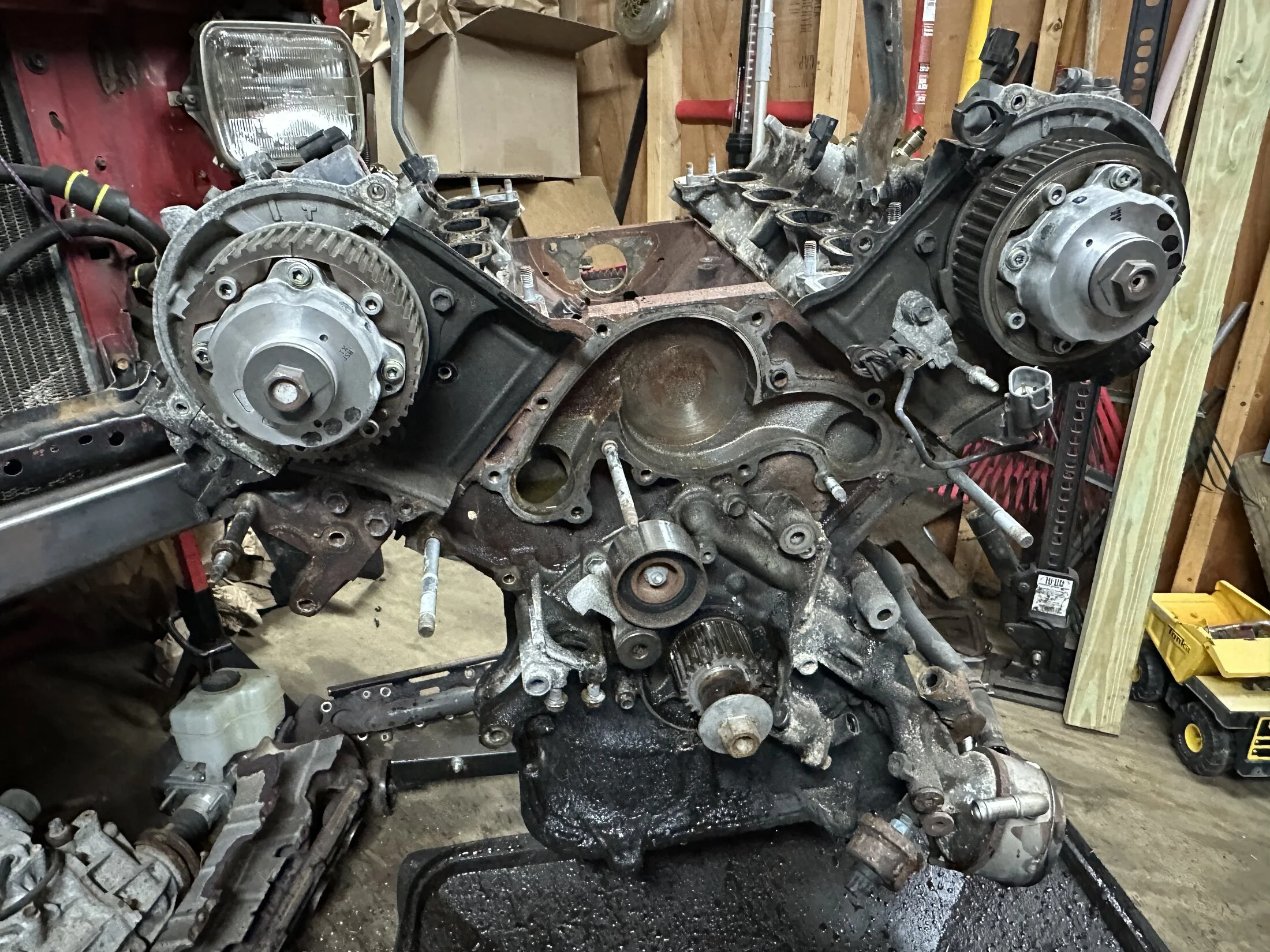

Tore the 2UZ down to clean it up and reseal. Drove up to Cruiserparts to get an A750 transmission and 2UZ Land Cruiser oil pan. Tapped the air injection ports for plugs and installed pre VVT Doug Thorley headers for 4runner/GX
Built motor mounts to fit the factory frame mounts. The way the 4runner manifold tubes are made placement a little more difficult. OEM manifolds are narrower and would have fit better.

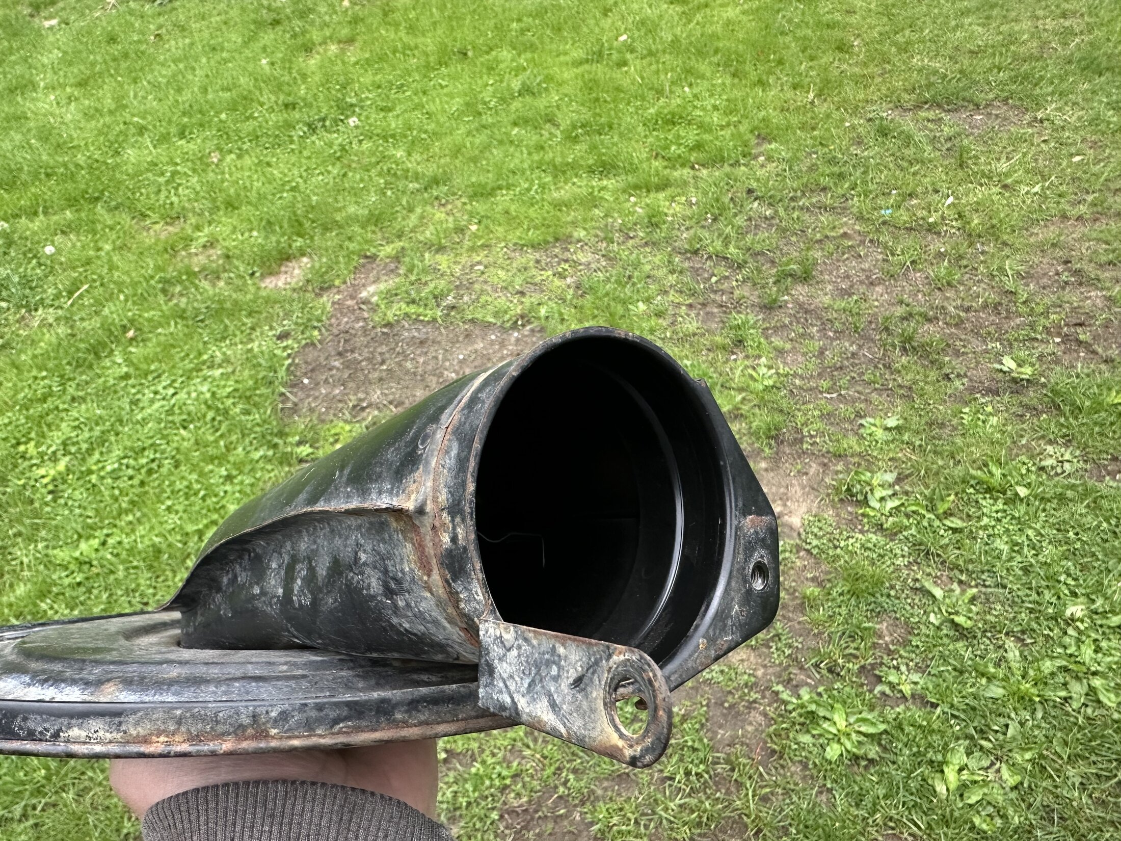

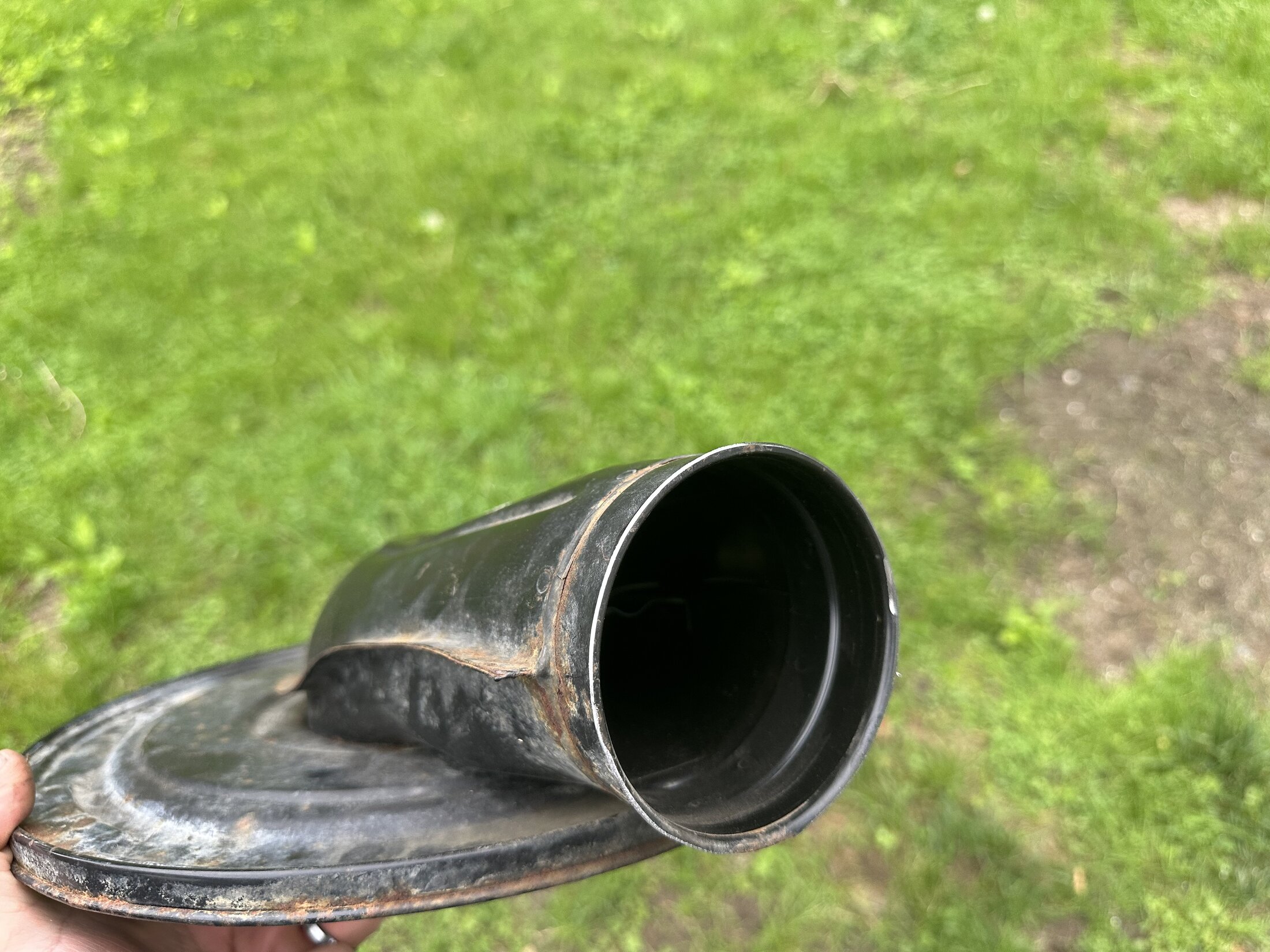

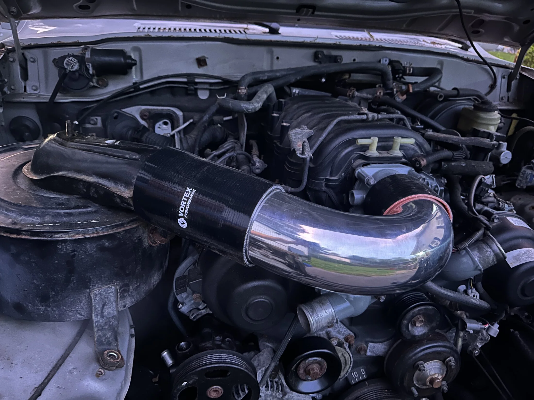

Cut the brackets off the air box lid to fit the intake tube.

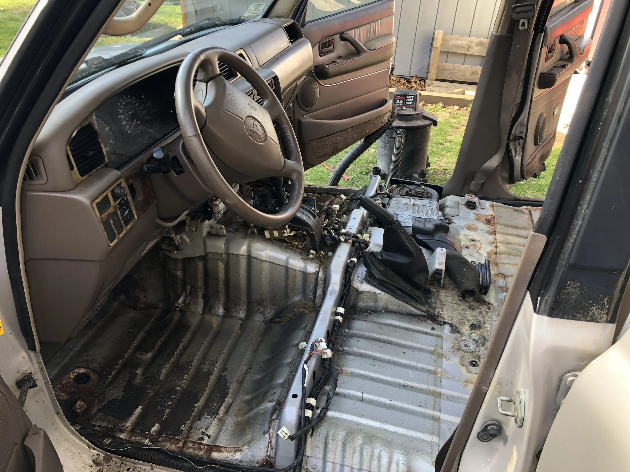

Removed the ABS pump and hopefully made enough room for the charcoal canister.

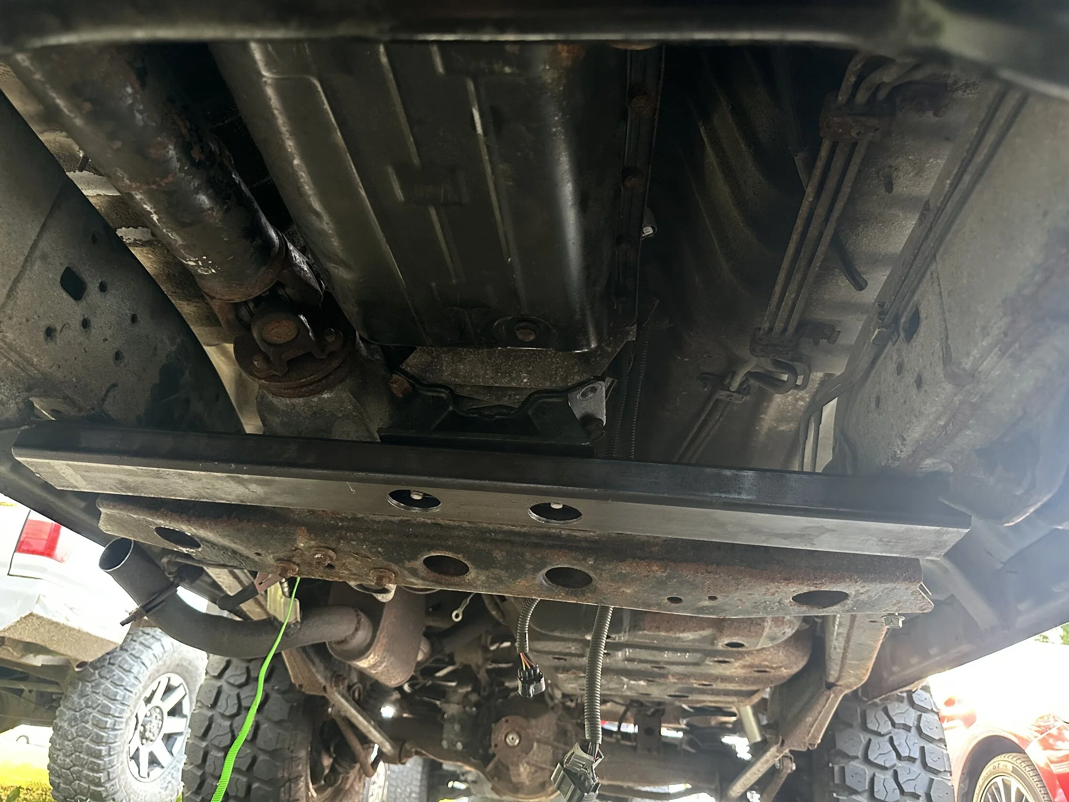

Started on a transmission mount crossmember.

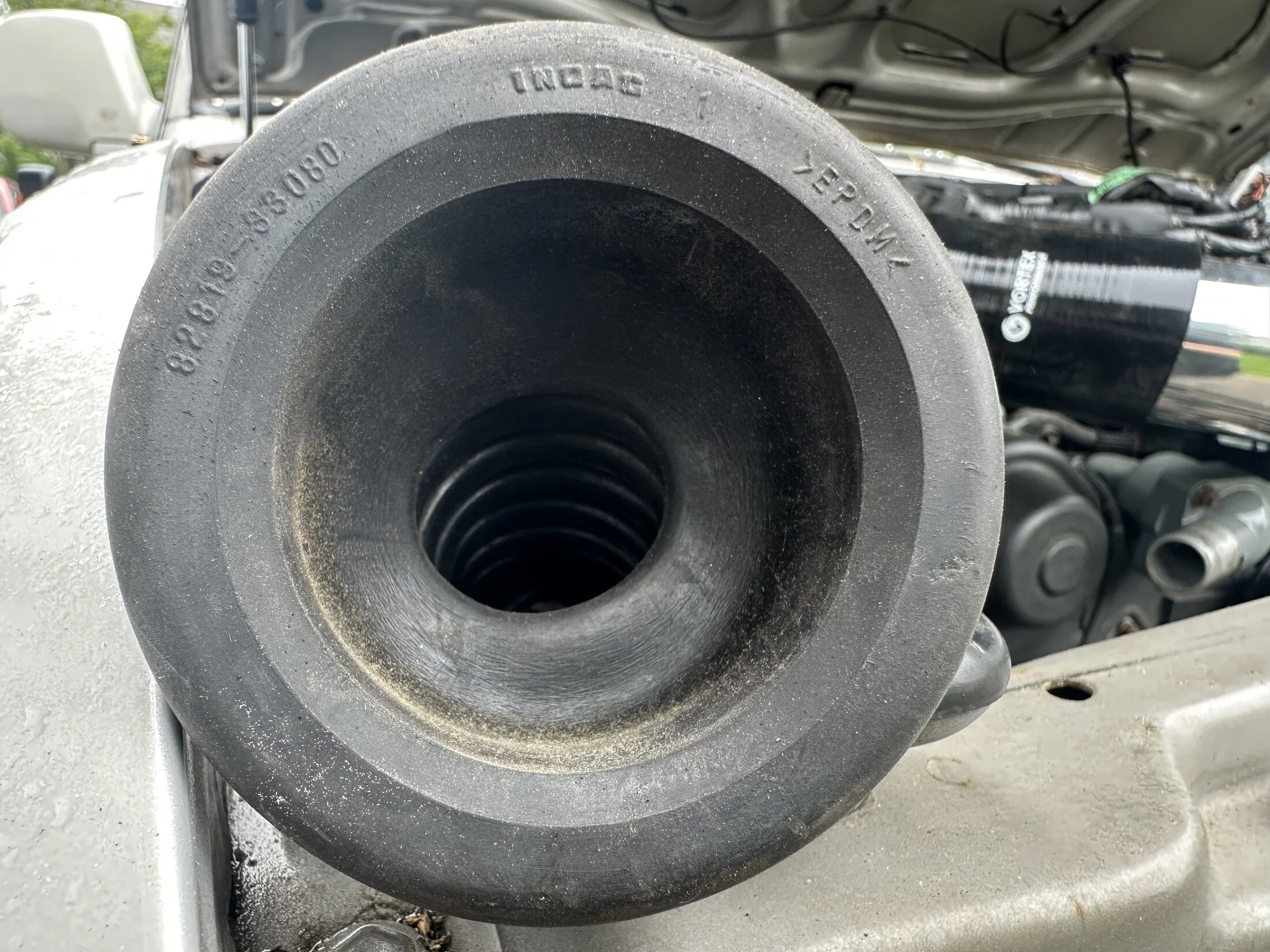

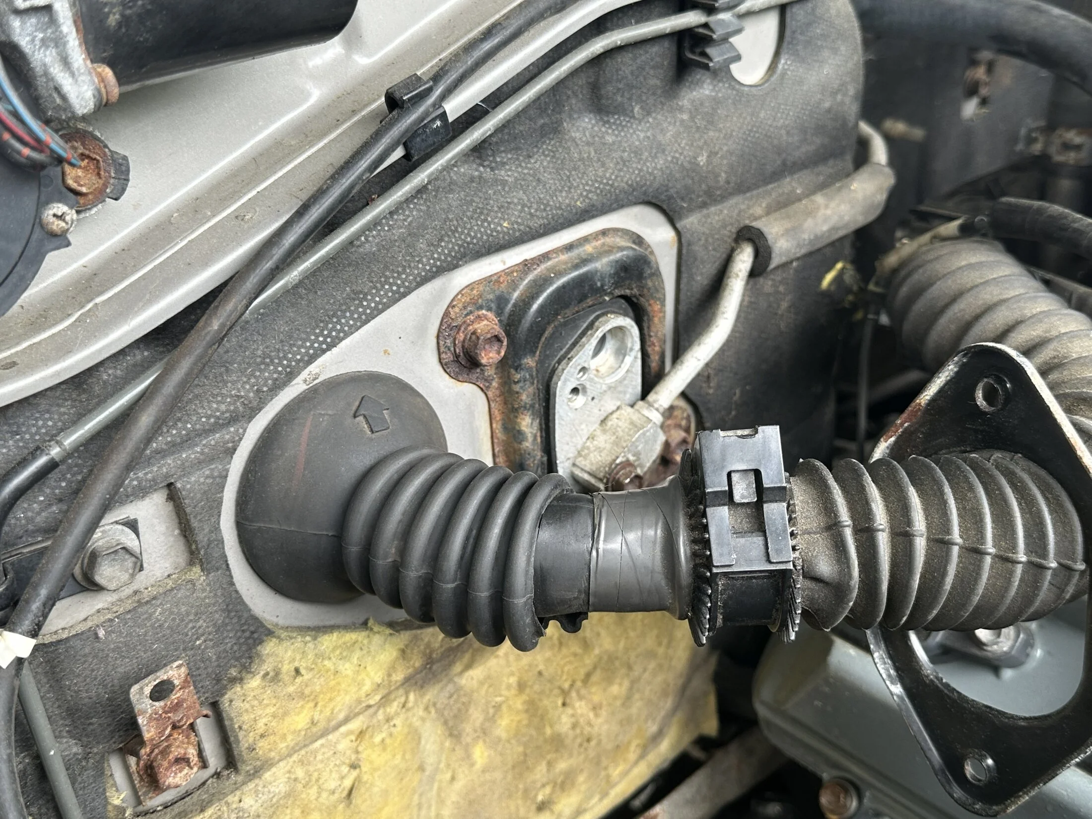

Found a firewall grommet from an early 90s Camry. Fits the firewall hole and around the harness pretty good. Was a little tight getting all the connectors through it.

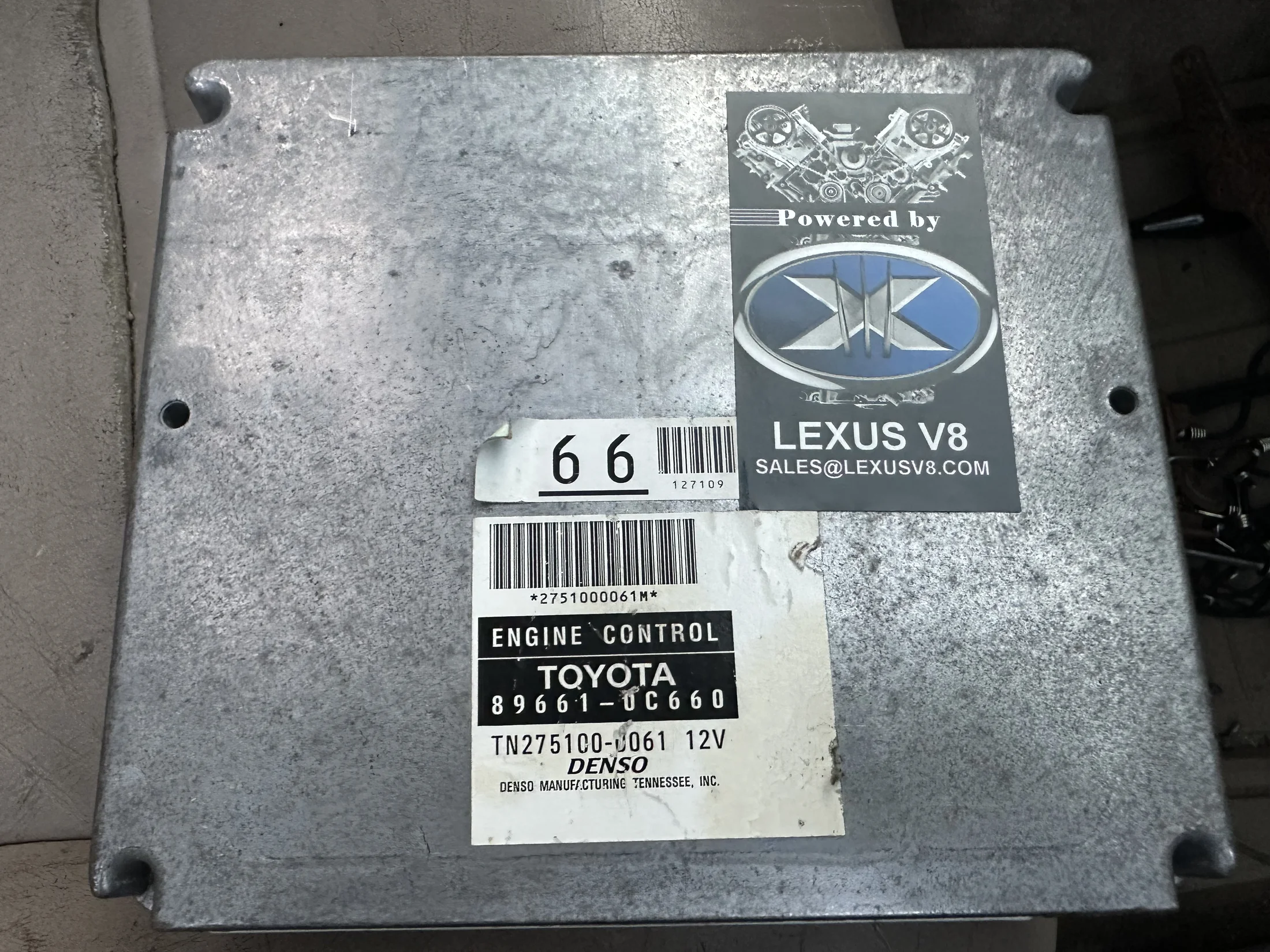

The brackets from the 1fz ECU bolt on to the 2uz ECU and locate it with just enough clearance to not hit the glove box when closed. Will need to widen the mount about 1/2”. Once that is done I may be able to position it better for more clearance.

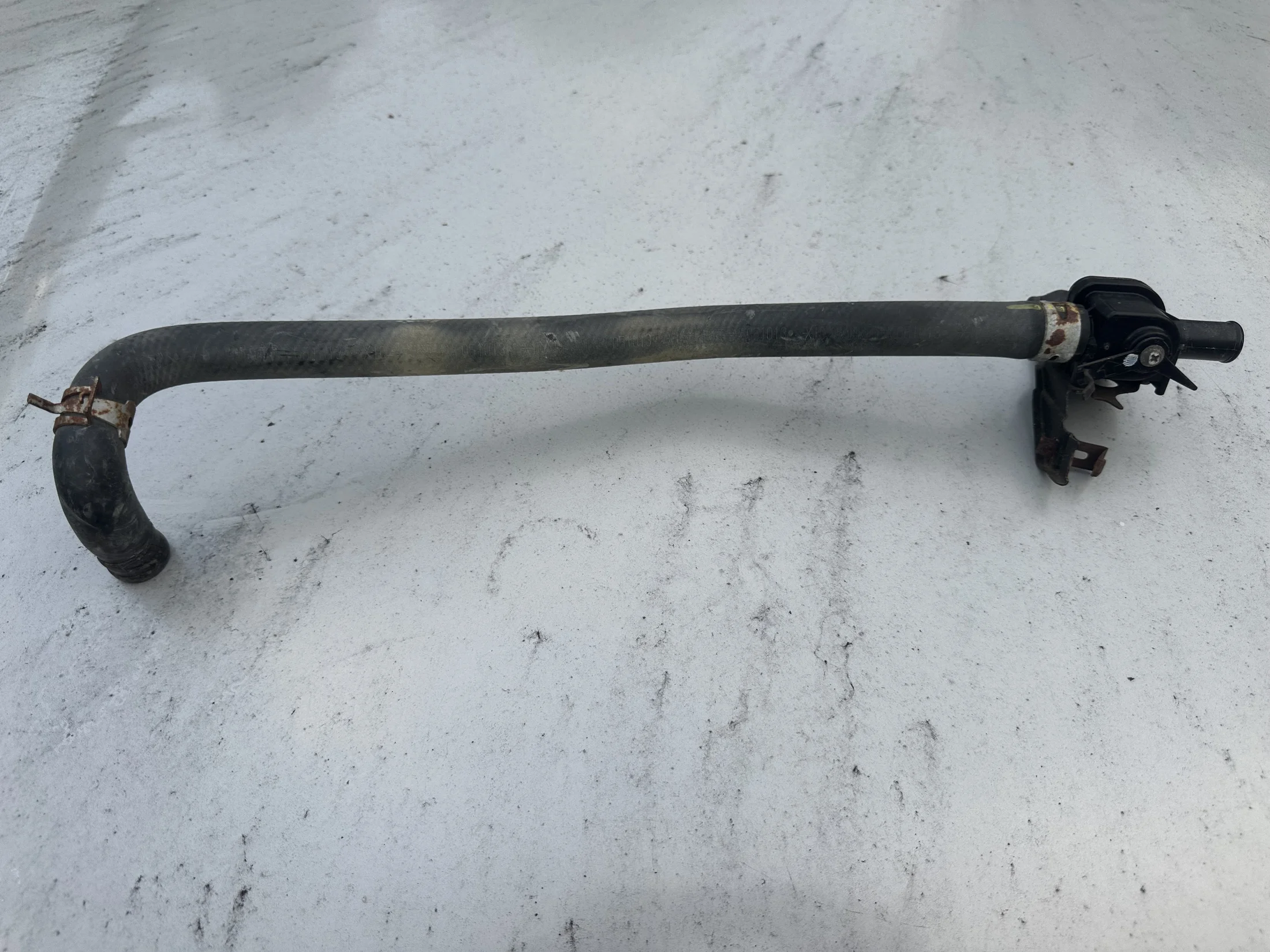

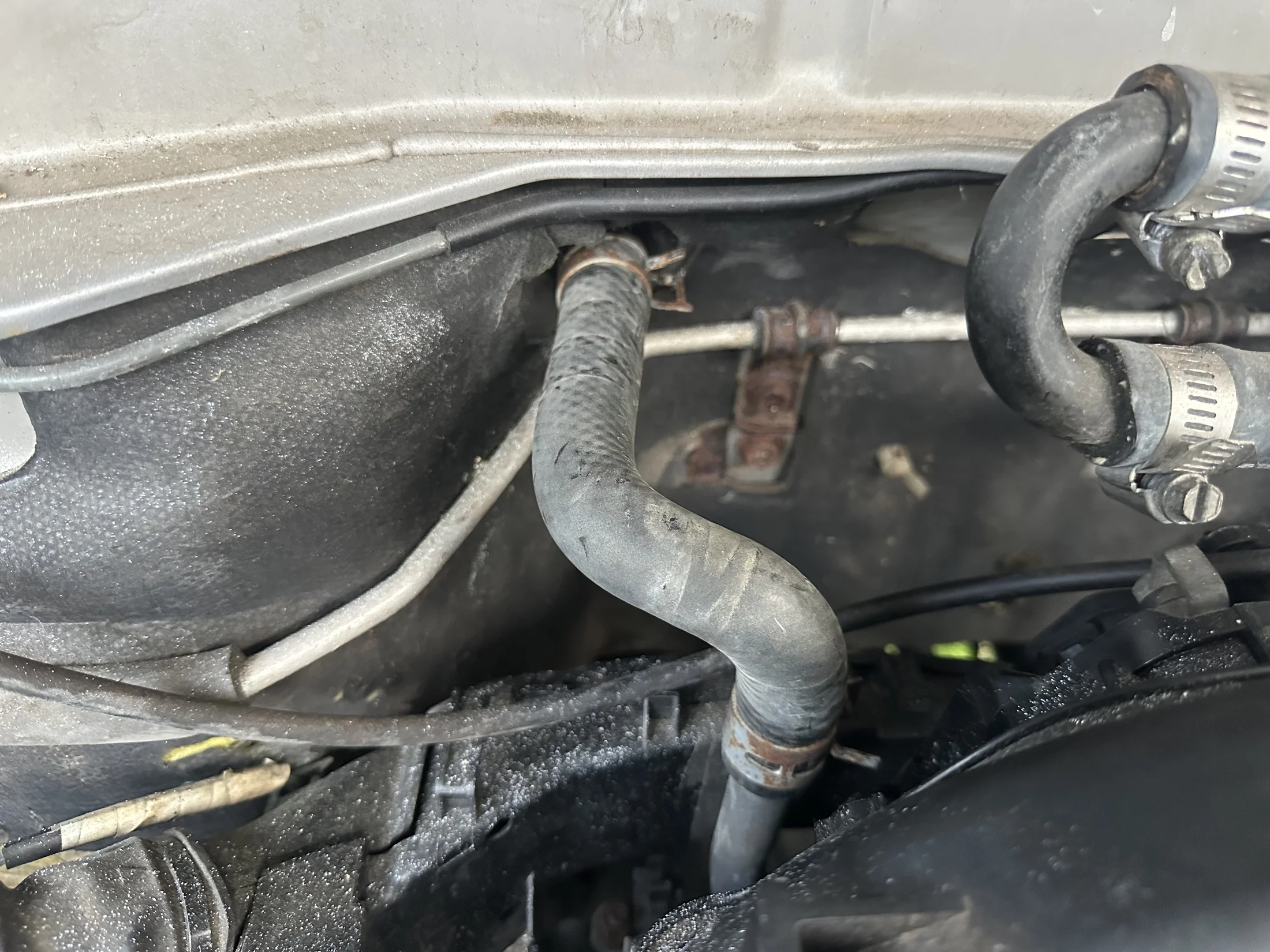

Been slow going, messed up my back and been taking it easy the past few weeks. Another hose from the sequoia worked good, just needed to cut and twist it. Need to order a new water valve before it breaks.
