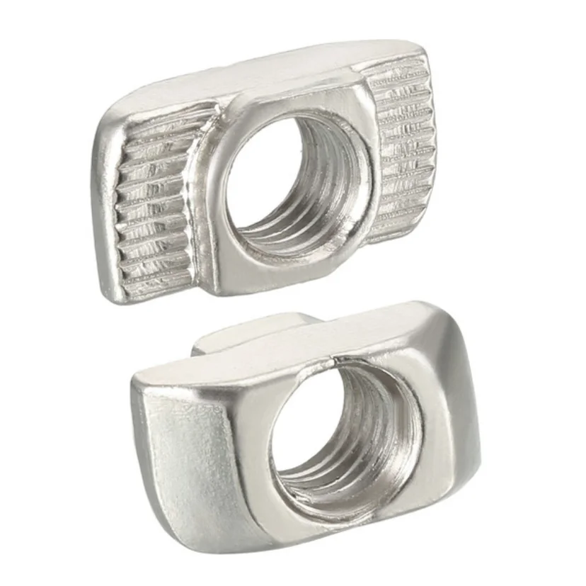

These. T-slot nuts. They’re designed to be dropped into the slot, turned 90 degrees, and then bite up against the underside of the slot.
They’re sized exactly for the dimensions of the slot extrusion in 80/20 and Bosch rail, but I’ve had luck using them in Yakima Aerobars. You just have to be a little more careful to ensure they’re perpendicular to the slot when you tighten them down.

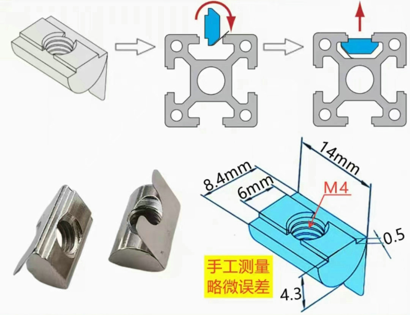

A “shrapnel nut” (above) might also work, but again, it needs to fit the extrusion so you may have to buy a few and experiment. These are designed to be dropped down into the slot sideways, and the built-in leaf spring rotates and pushes them up against the underside of the slot. They’re a little better than the first type because they stay put on their own.
Thanks! I'll get some options and give them a try.
