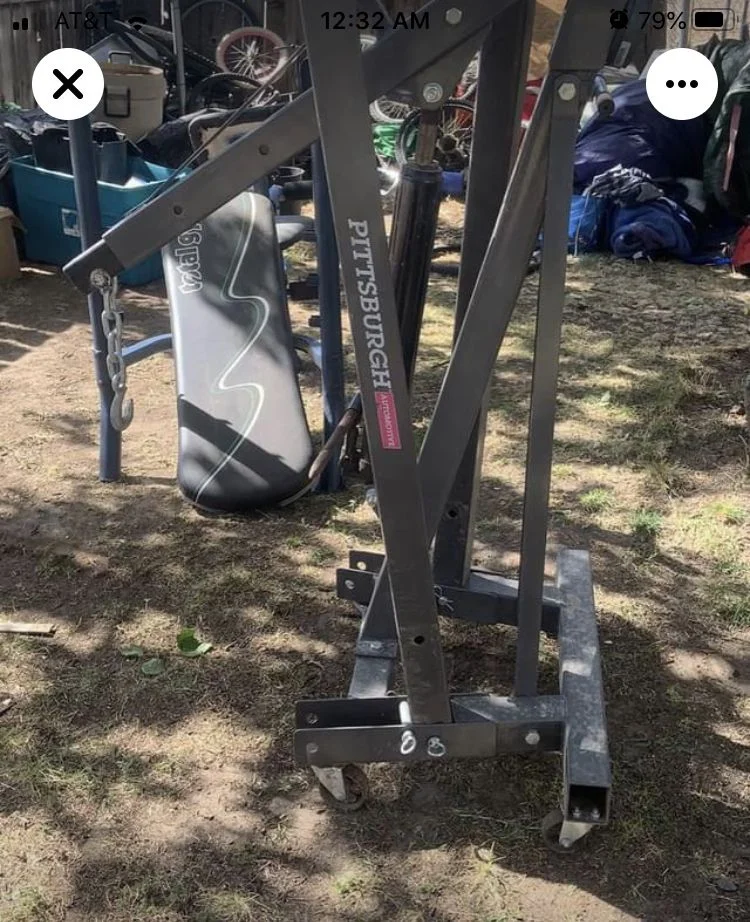

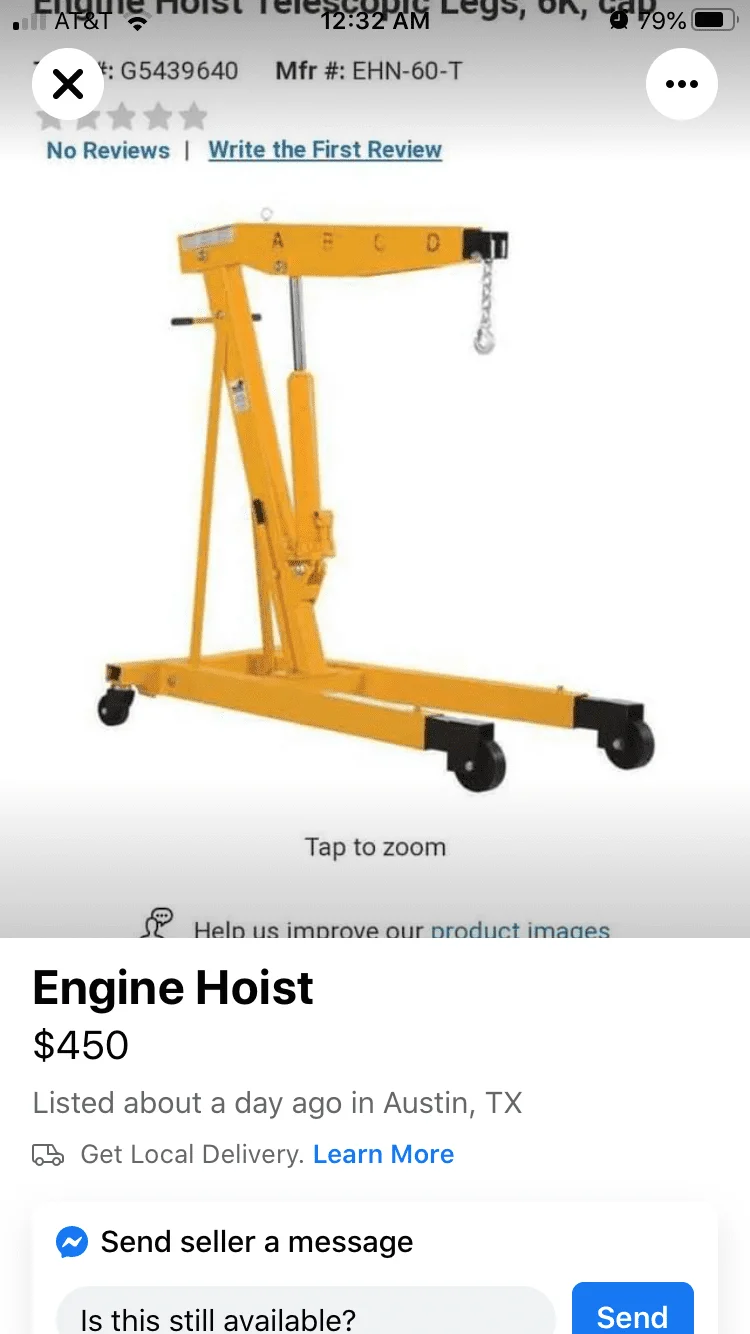

two pics from Fb marketplace.

If you are set on buying an engine hoist that yellow engine hoist is a very nice unit and will meet all your needs both now and in the future. The Harbor Freight (Pittsburgh) folding engine hoist above that - not so much IMHO.
