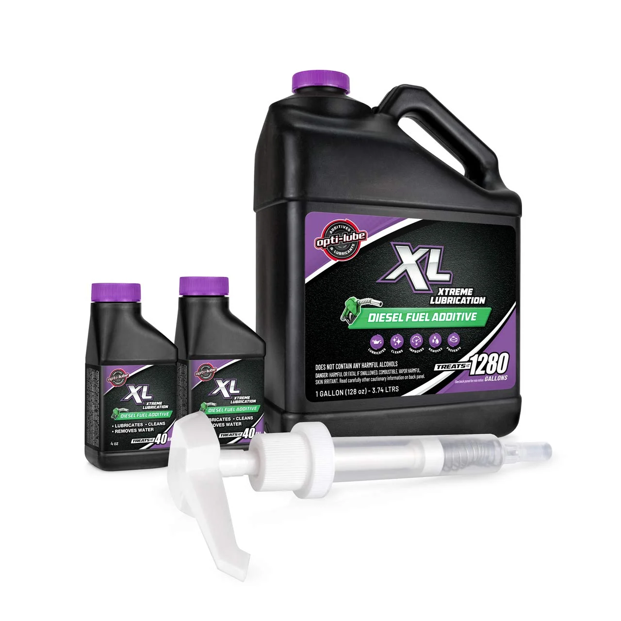

I'm not waiting for it to happen. I add 4 oz to each of my two tanks at every fill up. I don't drive it every day and a big pump bottle will last nearly a year. Comes with little bottles for easy use - 4 actuations of the pump = 4 oz.
