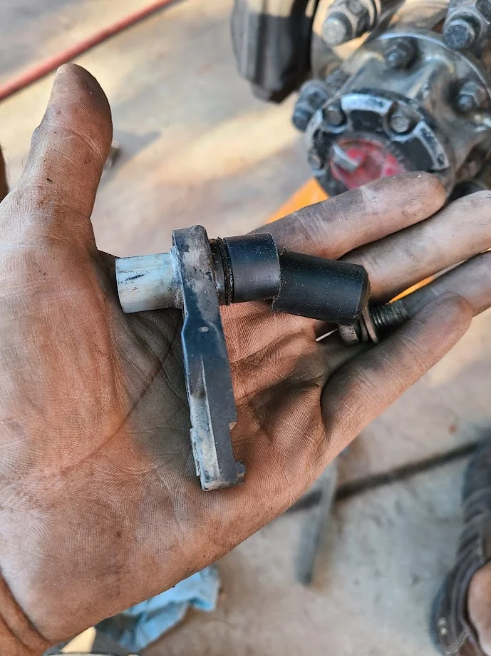

The ABS sensor is just a smooth magnet. The toothed part is the ABS sensor ring back of the birfield. Here's mine cut in half ;)
All kinds of metal particles will stick to this magnet and cause ABS activation w/o warning.
