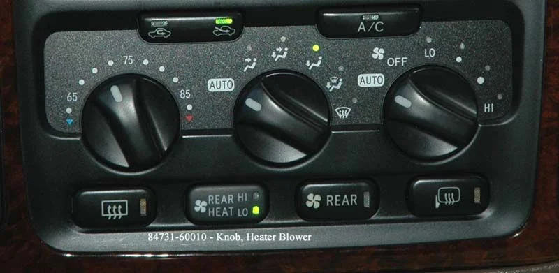

If you yank the panel with the defrost switches and rear heat, you'll see the blank space is pre-hard-wired for a switch not normally used in the US market.

I purchased the switch cover for the non-OEM rear heater from Slee a few years ago. The connections are under the driver's side seat...two circuits for the 2-speed fan we didn't get. But everything is in place...you just need the snap-on switch cover.

Wait...you got the rear heater working or You used that switch for something else by taping in under the seat?
I used the switched heater circuit for something else: Using one circuit to switch my Sanden OBAv2 clutch.

Regarding the rear heater switch circuit: Everything is in place, relative to the 2-speed fan circuit, including the circuit behind the blank switch location...except the plastic switch cover. Pry off the blank cover and snap/press on the active switch cover/button.
