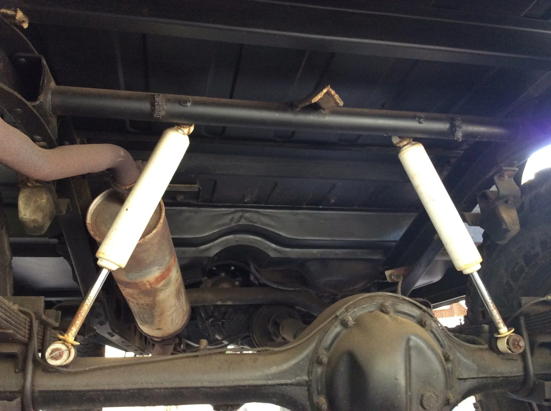

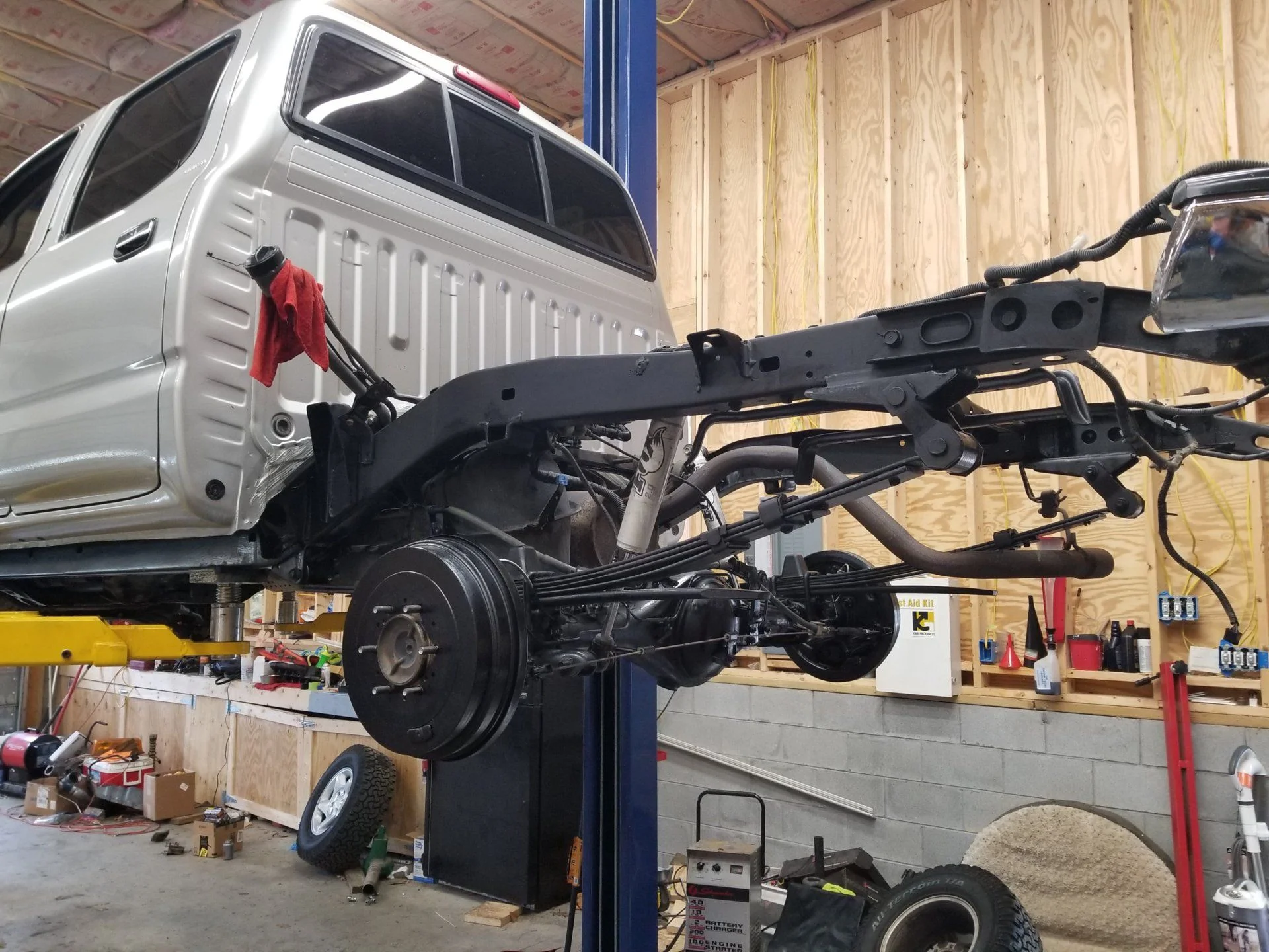

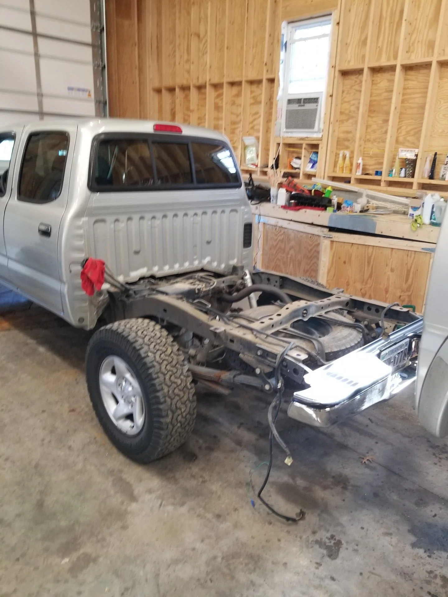

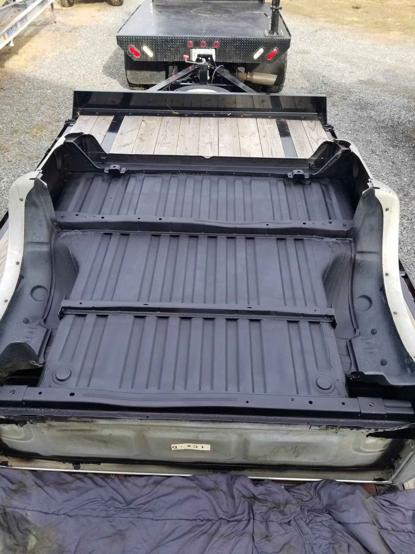

You could POR15 the exterior parts of the underside
and use the Eastwood internal frame coating inside the frame and rocker panels. I just did a thorough job on my 1st gen Tacoma. I am very pleased with the results and could probably park it at the bottom of the Chesapeake bay and it not rust! Ha

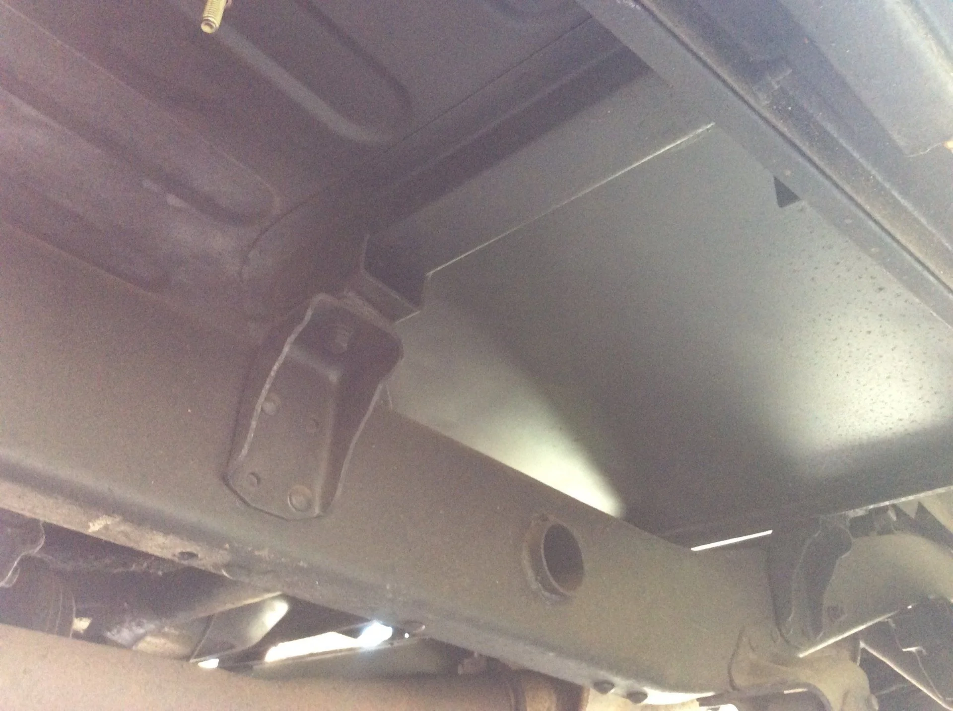

Eastwood’s Heavy Duty anti rust is a similar product to fluid film, but comes in a rattle can and sprays on like a paint. Its finish is like a half dry paint as it maintains an oily-⎌greasy tackiness and just like Fluid Film maintains a tacky moisture barrier to water,oxygen, rust.
In California I’ve run it for 3years and it picks up a bit of dust and dirt while maintaining a tacky coat next to the underbody. I figure I will apply a recoat at the 5year mark......but at this point on the 40 it basically looks like a frame off resto underneath. the best part is that it’s a very thin application and layer so it really appears to only pick up dust and maintains an even look vs goopy look. I had good luck getting it sprayed inside the frame on the 40 to get a little internal frame coating as well as axle housings which were rusty. In areas where you don’t want a lot of overspray you can spray it into a cup and use a paintbrush to paint on hard to reach spots without spraying things like the shocks, Muffler, bushings or whatever you don’t want coated.
It comes in black and amber colors and is likely quite a bunch cheaper than Fluid Film and is diy vs paying someone else to do it.

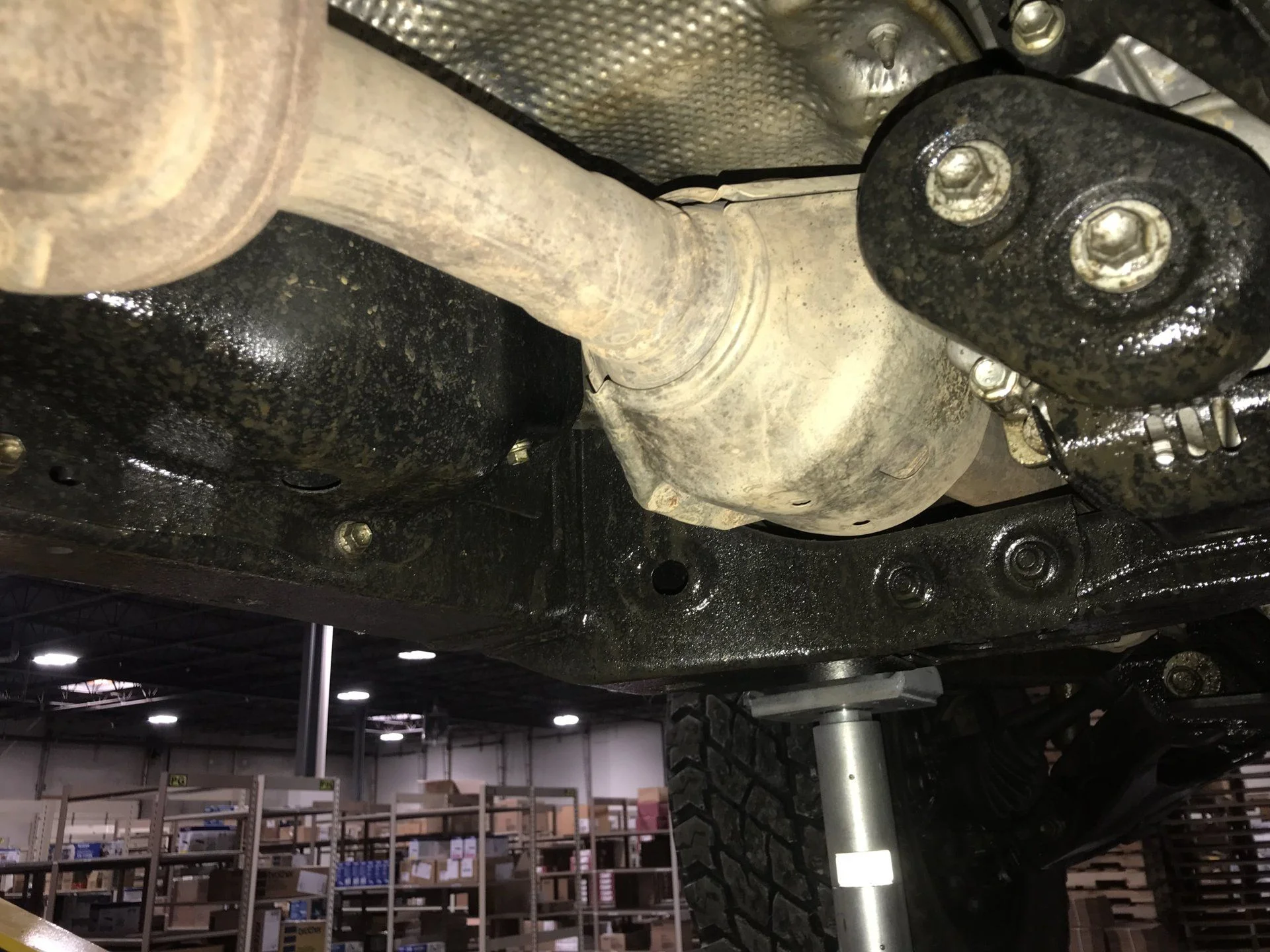

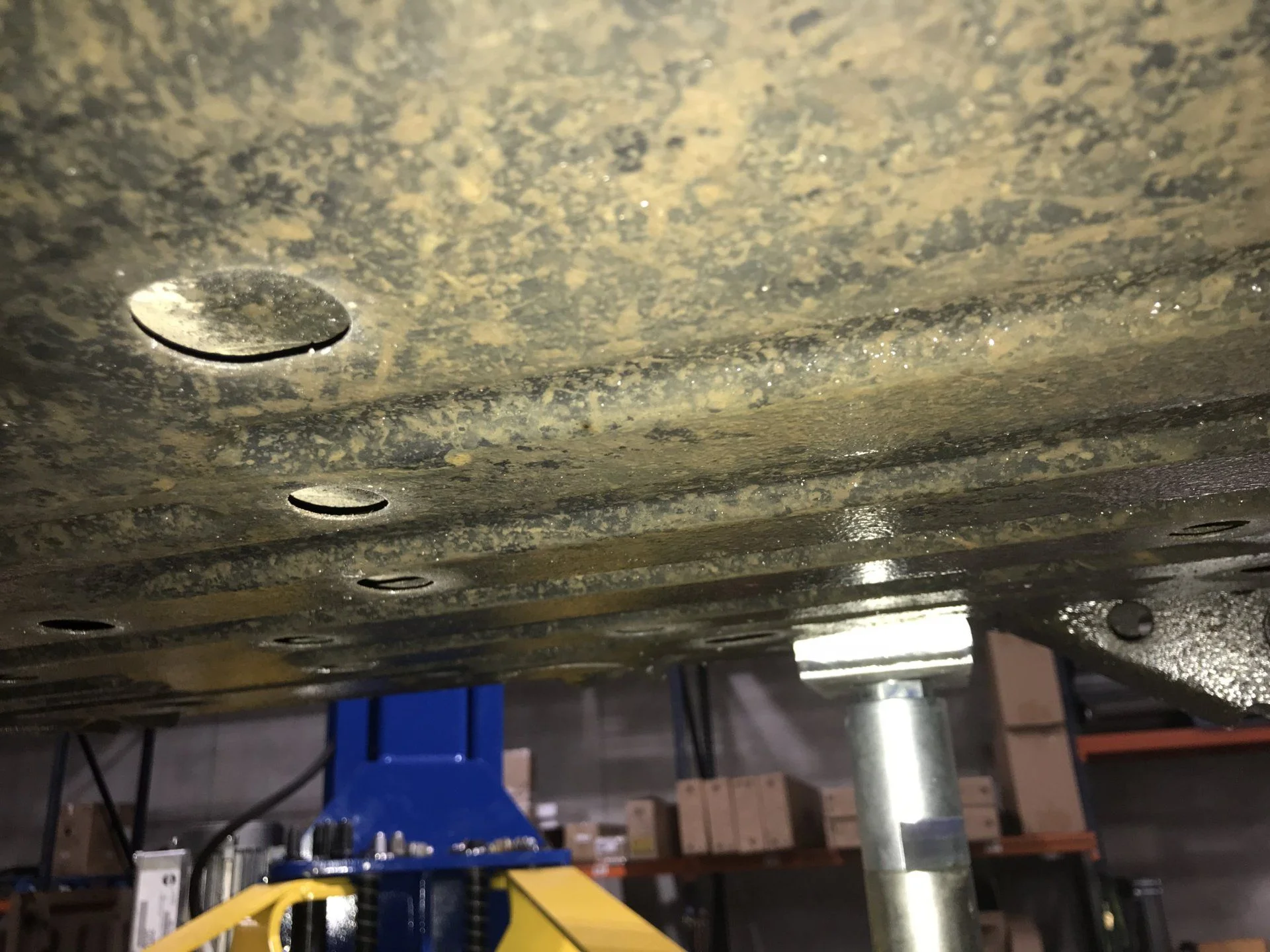

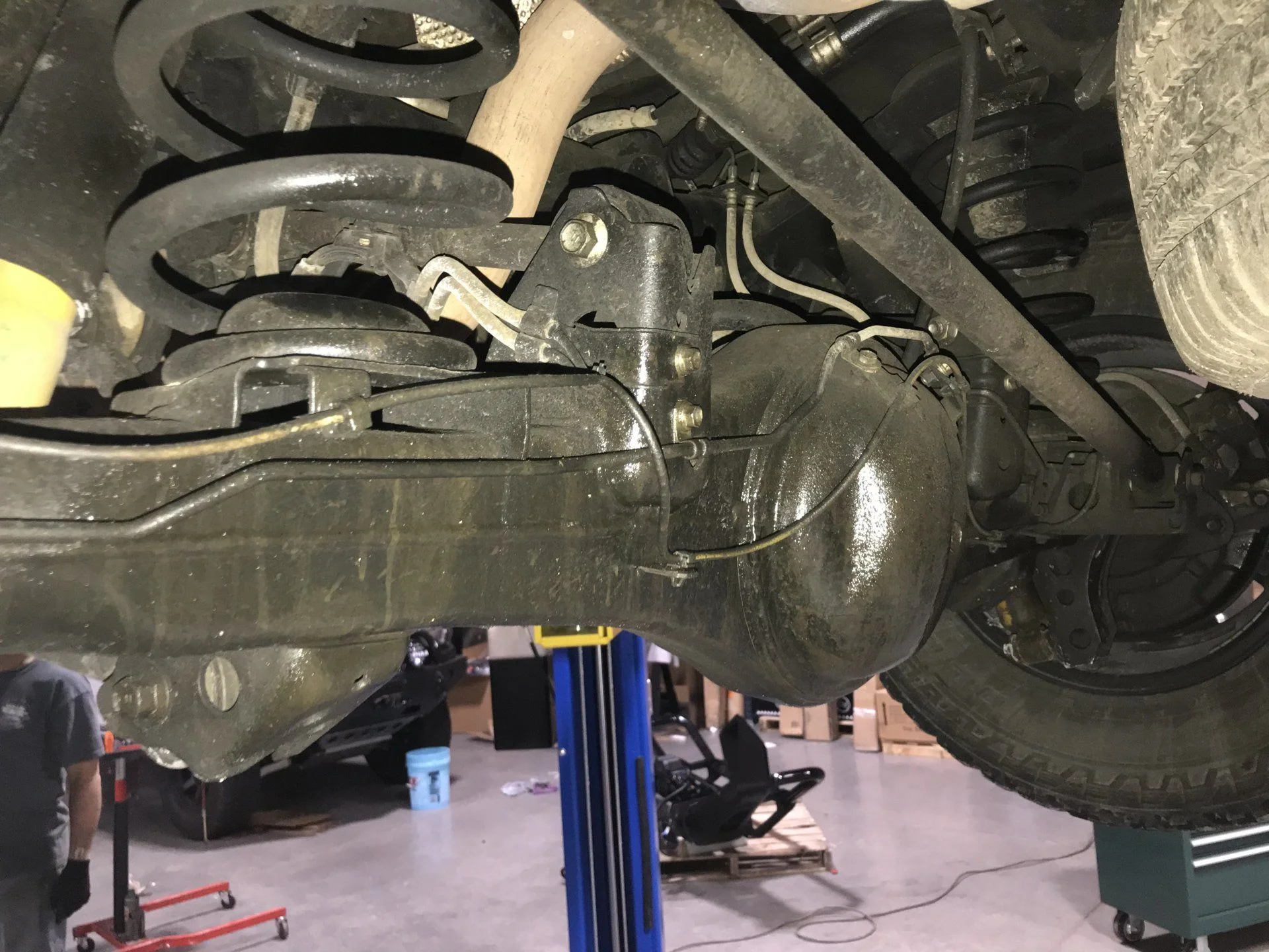

That looks good! ^^^ The first time I Fluid Filmed the 200 I sprayed damn near a gallon underneath... that was a bit “much”. I’ve refined my technique and I’m confident I’ll be able to keep that cancerous rust from ever starting. The salt trucks are ruthless here in Chicagoland though. Here’s some pics of my 200 with FF applied (two coats). The mud is from two wheeling trips and was thin splatters, I went right over it with the second coat. The dust and dirt that gets picked up tends to further insulate the metal and once sealed in oil it’s harmeless.
Aren’t 200s mainly plastic like the Highlanders???? ;)
That Fluid film looks like someone sneezed on it. Lol. Looks very well protected from salt - How much is Fluid Film for a typical undercoat job??? (Ive never priced it and couldn’t say if its closer to $50 or $500)
And how often do you need to reapply in harsh Chicago conditions?
