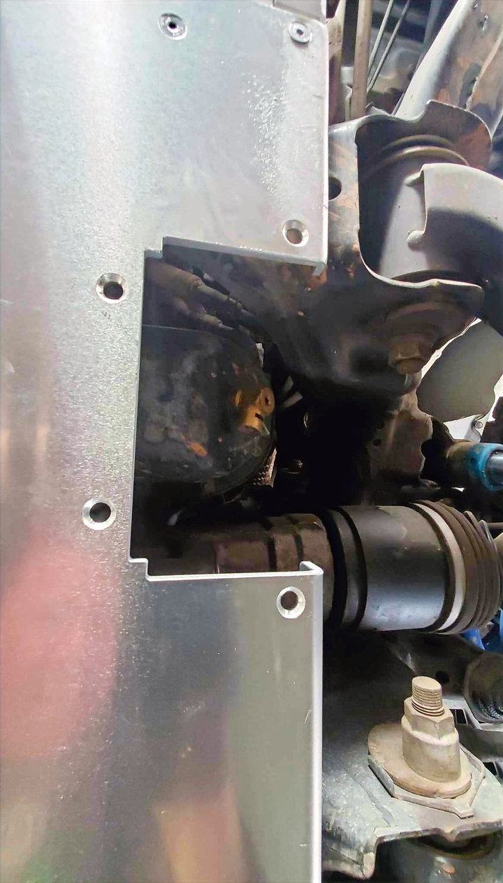

The E&E skid system has an extra plate that fills the gap to a stock bumper.
This is one of the reasons I just ordered myself a set of E&E skids for my 2015 LX. That, and the ridiculous engineering and feather-like weight.

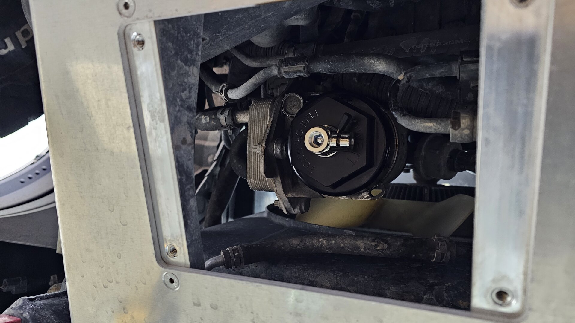

Access panels provide plenty of room for oil changes with my skids. Recommend a fumoto valve for the oil pan and @bjowett oil filter housing. This set up makes oil changes clean and easy.
Next best option might be an oem toyota aluminum oil filter housing with a Motivx tools drain adapter.
