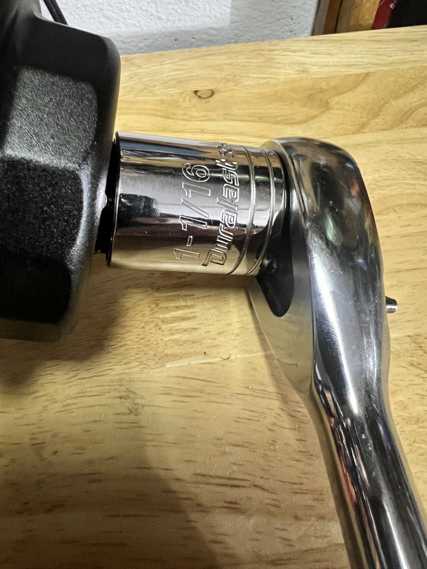

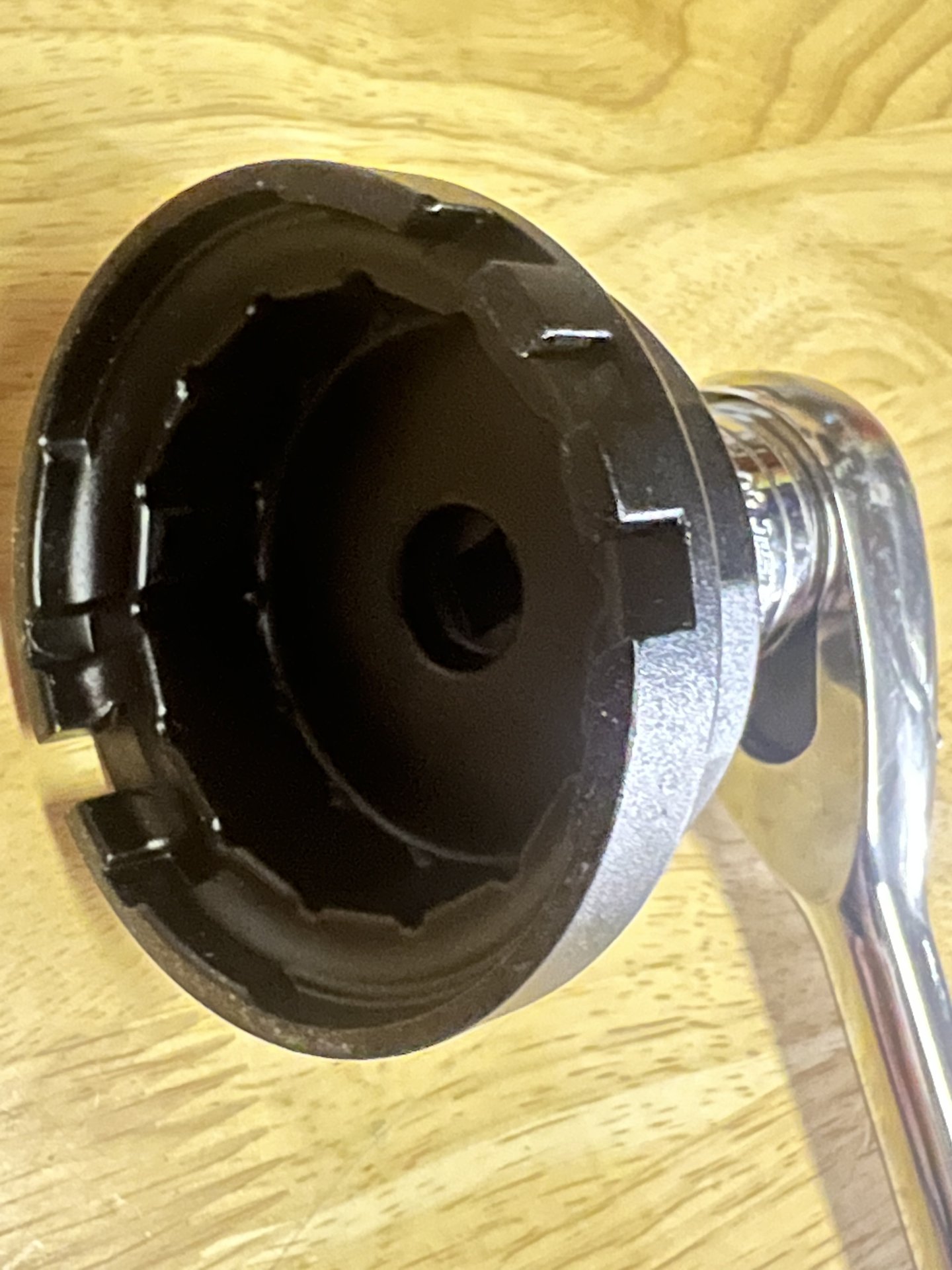

Just kidding. Alright I’ll help you out.
You need this filter housing adapter, a 1-1/16” socket, with a 1/2” ratchet.
You gotta make sure the adapter has the right notches.
The cap is this one.
Motivx Tools Oil Filter Wrench for Toyota Camry, Tundra, Tacoma, 4Runner, RAV4 and More - 64mm 14 Flute Precision CNC Machined Aluminum Oil Filter Removal Tool https://a.co/djRuveu
Looks updated from my cap and the socket size may be different. But you get the idea.

This is true. You can use 3/8” drive but if it is on that tight, the square opening will get deformed. If you really need to torque on it to get it loose, then the socket with 1/2” drive is the way to go. This is from experience.
Good to know. Thanks.
