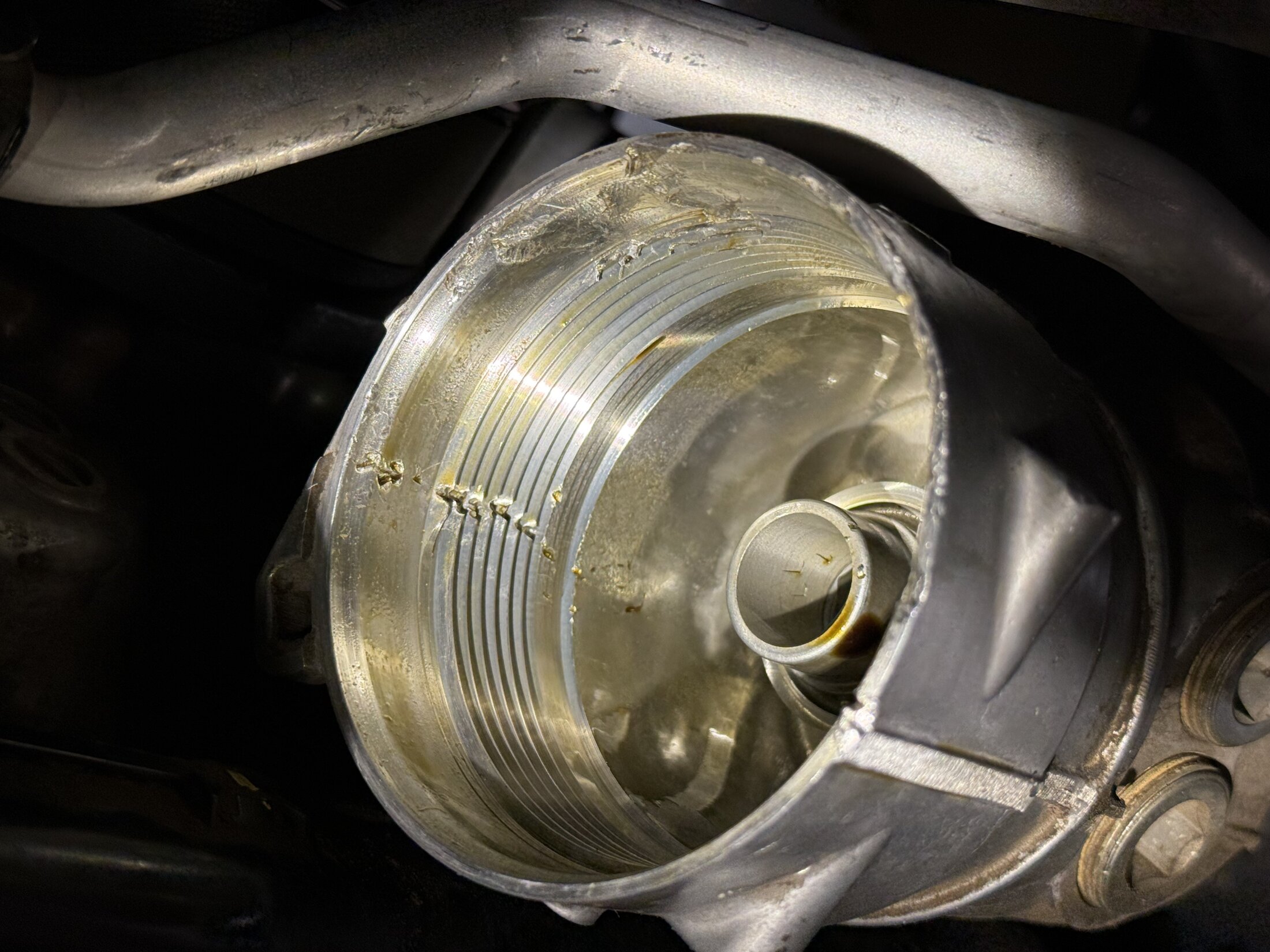

The PO of my wife’s new-to-us 2022 GX460 evidently went to war with the oil filter housing/assembly.
I can’t believe that it was sealing. Has anyone replaced this engine side oil filter adapter/housing?

I don't even understand how that's possible. The cap is plastic and would have likely exploded before they did anything to the housing.
Isn't there a metal "upgrade" cap from a different Toyota model that fits? I wonder if the PO had that installed and went ham fisted on it.... Or maybe he tried to install a metal cap that wasn't correct fitment. As you say, I don't see how the plastic one could damage anything without first breaking apart.
I have the metal cap. There's no way it can do that by itself. That looks like someone took a screwdriver or a chisel to it. Maybe they were trying to break the plastic cap out because it was broken and stuck in there. Or they had the metal cap on it and it was cross threaded. But holy hell, that is a hell of thing to damage.
Yeah - my guess is that the OEM plastic cap was damaged due to being previously over torqued and/or a low quality removal tool. Once damaged someone definitely lost their zen and got way too aggressive removing the broken cap.

My first “hmmmmmm” moment was when I noticed an aftermarket Dorman metal cap. Upon removing the cap I beheld the carnage. I also ordered a new OEM plastic cap. (And the two o-rings that go between the new adapter and the engine front timing chain cover.)

Here is that abused adapter…

All good, so skids / engine covers back on and as good as new. I still can’t imagine how this happened. Was it the PO? Was it the dealer who took it as a trade? The dealer did show an oil change on the carfax and apply a mileage reminder sticker. Can’t believe they would sell a vehicle with knowledge of an issue like this.
