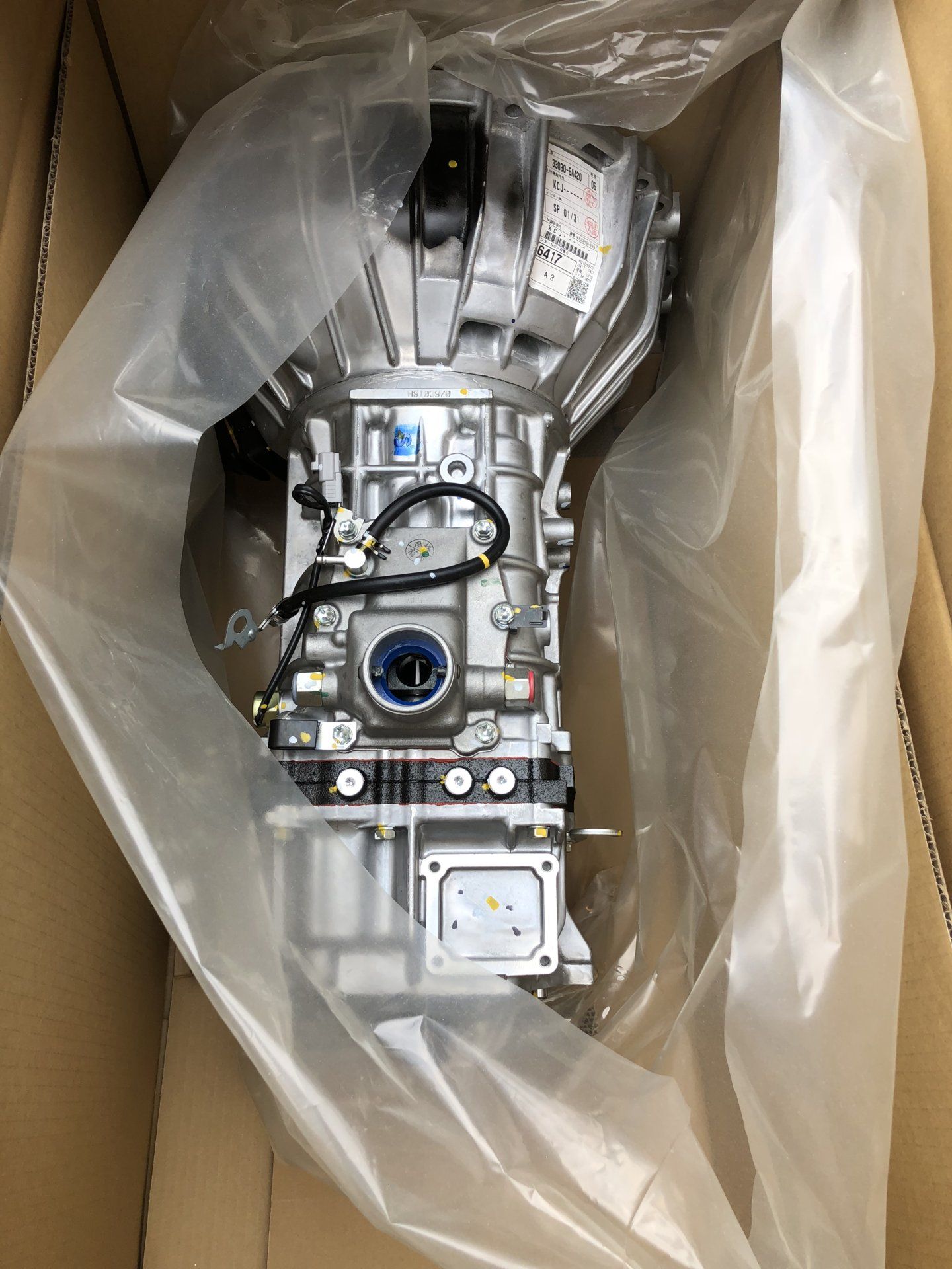

I recently purchased a new in box H151F. When I pull up the part number I get the notation "Un Spec".
Does anyone know that that means? Any help with the bellhousing in terms of which engine it is for?

33030-6A211 is the replacement for 33030-6A050 which is from a 92-99 FZJ7# series. Typically 70 series have H150. You can also check if it's H150 by checking the part #s of the internals and looking at 1st gear. Typically the indicator is that 1st gear has a single synchro in H150 and triple in H151.

Cool and thank you. It was advertised as an H151F. My bad for assuming it was.

They're basically the same. Just different gear ratios in lower gears. 4th and 5th are the same.

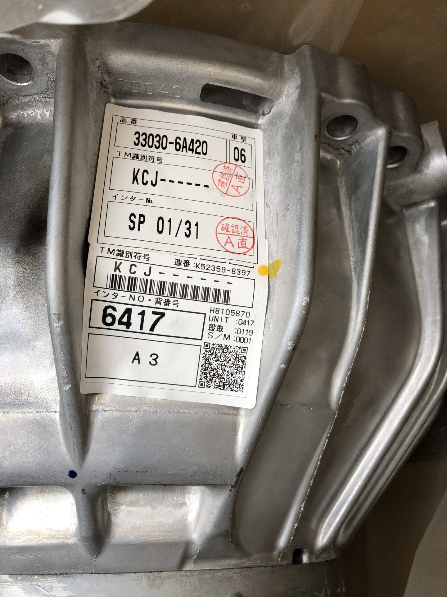

Which now supersedes to 33030-6A420. H151F new behind a 1FZ iteration is now discontinued from Toyota. Only H150F’s are still available.
And UN is short for Unit. As in Transmission Unit. Has nothing to do with spec. Spec is never associated with a part number or description.
It’s internal part people shorthand.

The reason I thought it was "Un Spec" is because it is the only trans I look up that has "UN" in the description and I have looked up 10+. So obviously my bad there. I had definitely suspected it was a 1FZ H151 with matching bellhousing because of where it came from.

ASSY: Short for Assembly
UN: Short for Unit
In the Toyota parts nomenclature world.
The reason this is called a "unit" is because you get the bellhousing, clutch slave cylinder, throwout bearing, fork and boots all in one part number (hence the letter in the suffix number)
An "assy" would be just the transmission itself, for example, 33030-60450.
