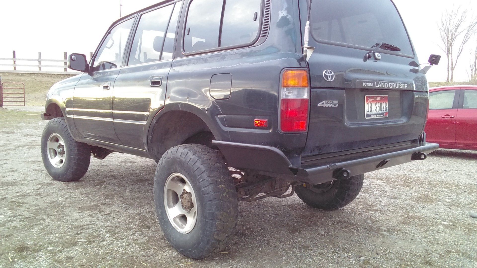

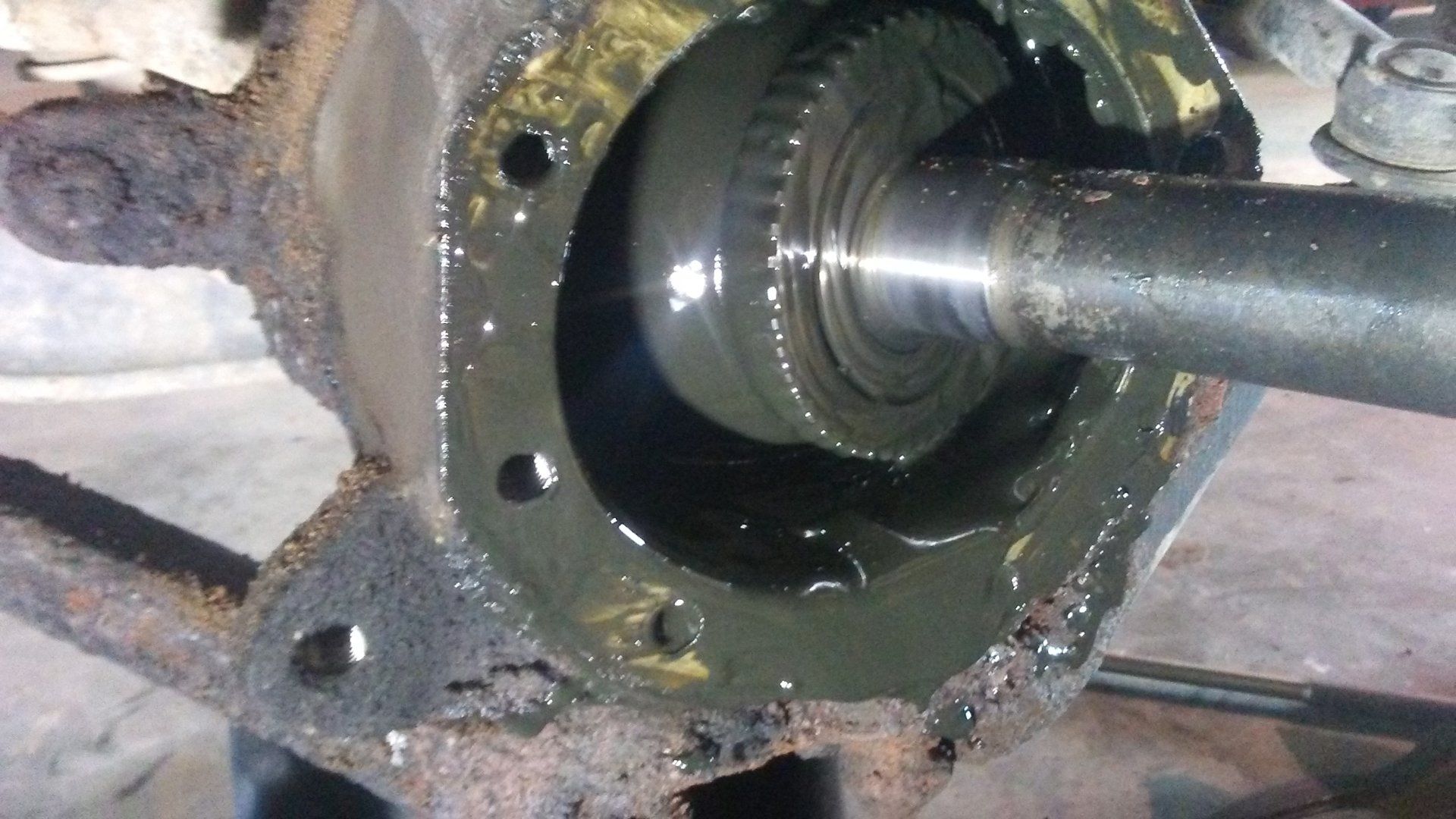

Ordered a 4x4 labs rear bumper and they happened to have one sitting on the shelf ready to ship. So it has been sitting waiting for me to finish cutting the frame. Also need to put on my extended brake lines and ARB breather kit. Also looks like I need to replace an inner axle seal and my oil pump cover. Will be excited when it feels like I'll be done with baseline maintenance and have the 37's on and it drives decent
After I get the bumper on, 37's balanced and mounted, and other maintenance I may be selling it. Just maybe
