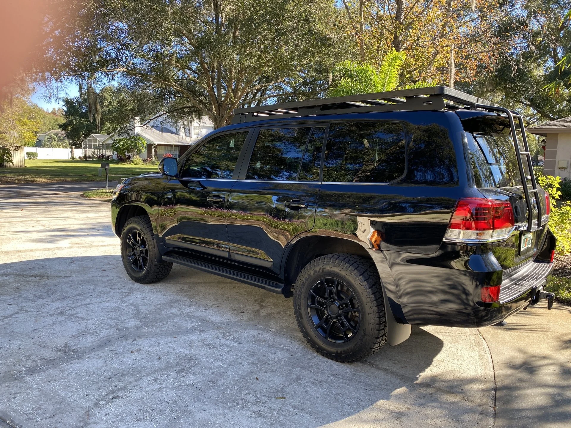

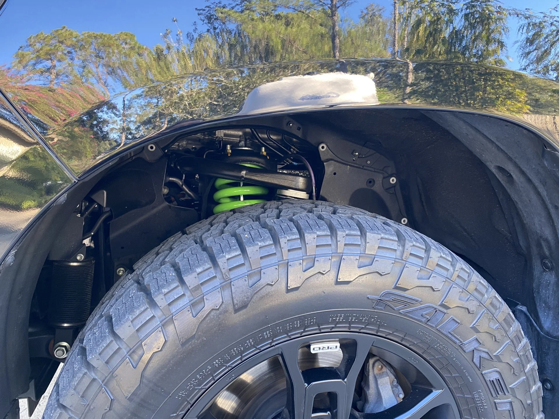

I have the setup you’re considering, and it does start out close to 2” of lift. UCAs weren’t a necessity, but I changed them anyway since the truck was going to be in the shop. Here’s what you can expect.
