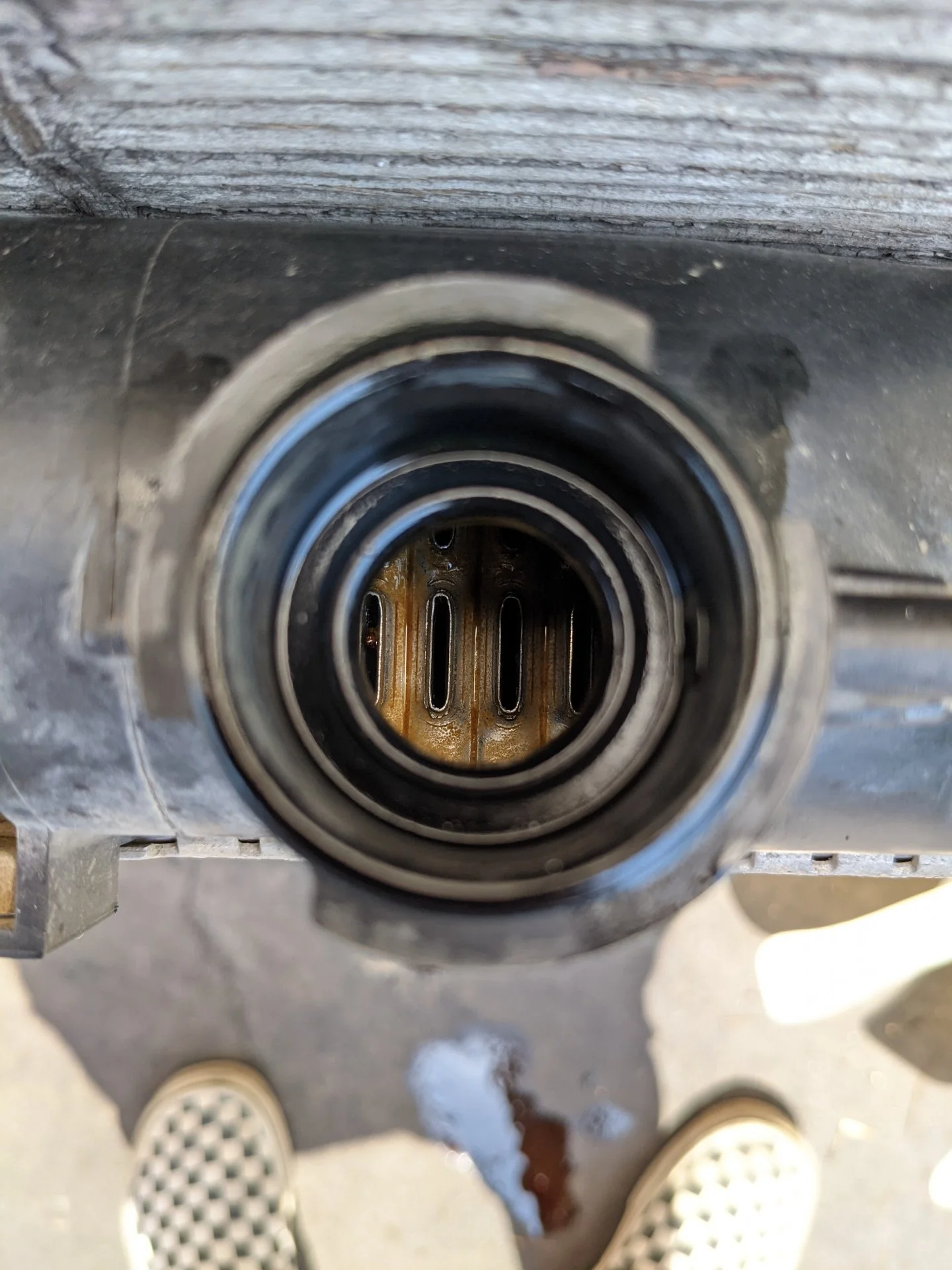

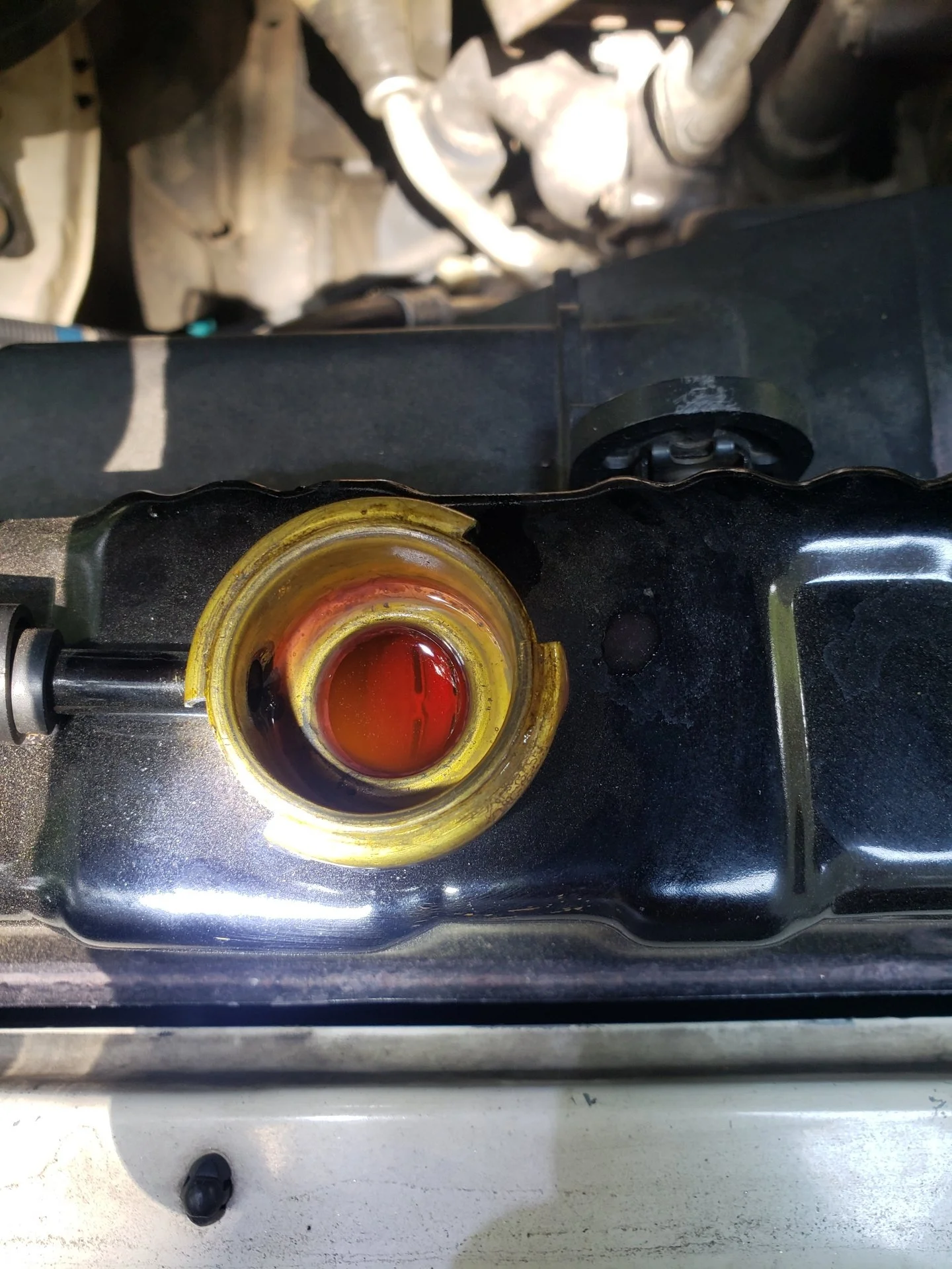

Now onto what I've noticed when looking inside the filler neck of both radiators.
They are both double row and have the same dimensions - YET the TYC has much larger channels for the coolant to flow through, I take that its cooling capability is better than the denso due to being able to flow coolant at a higher rate.
