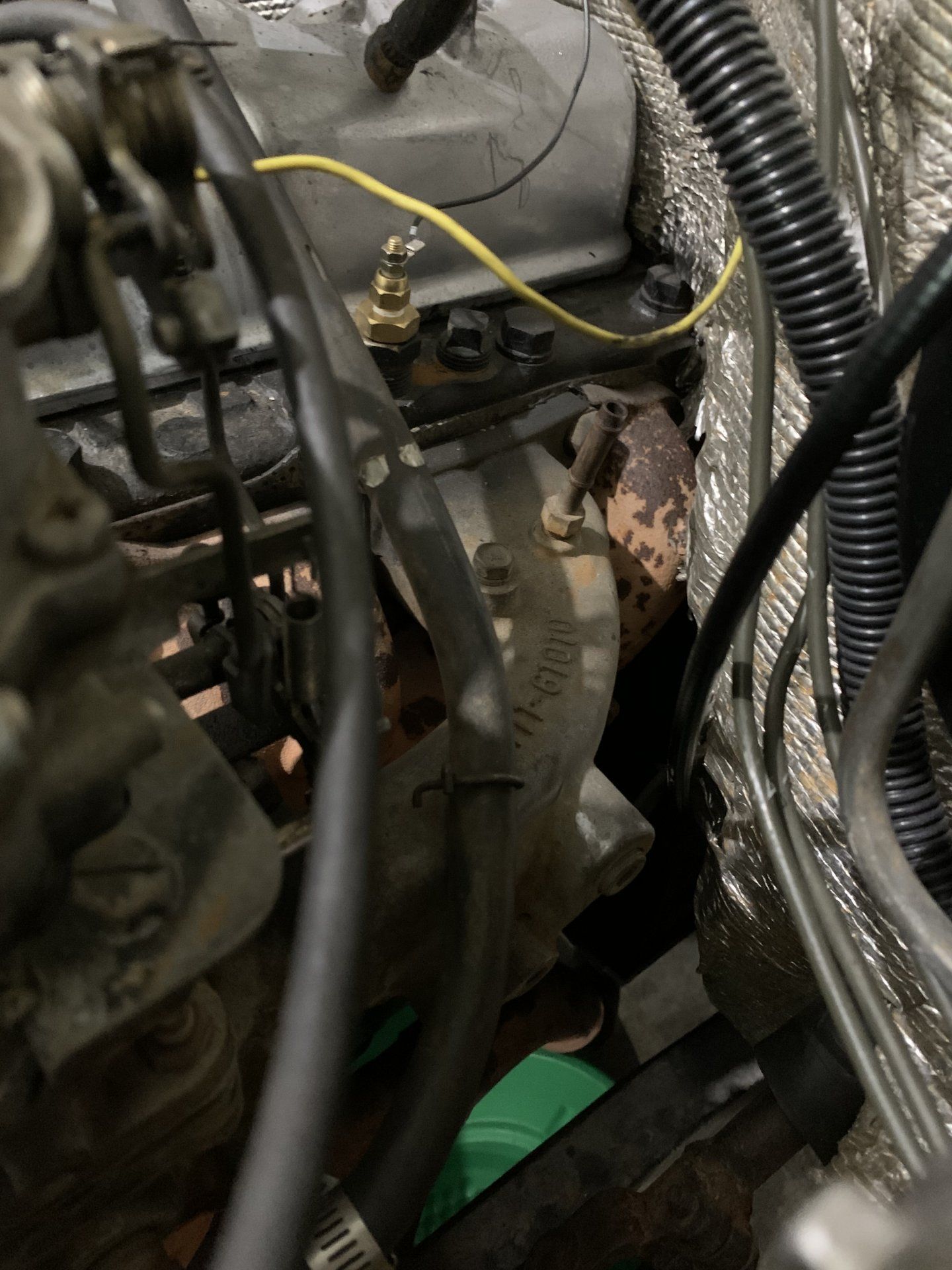

Any tips on removing the square plug from the 2f to add the heater barb? A 14mm open wrench fits, but I have not been able to budge it at all. Have tried heat yet but will remove sending unit if I do. There isn’t much room to use leverage and I have never seem a square socket.
