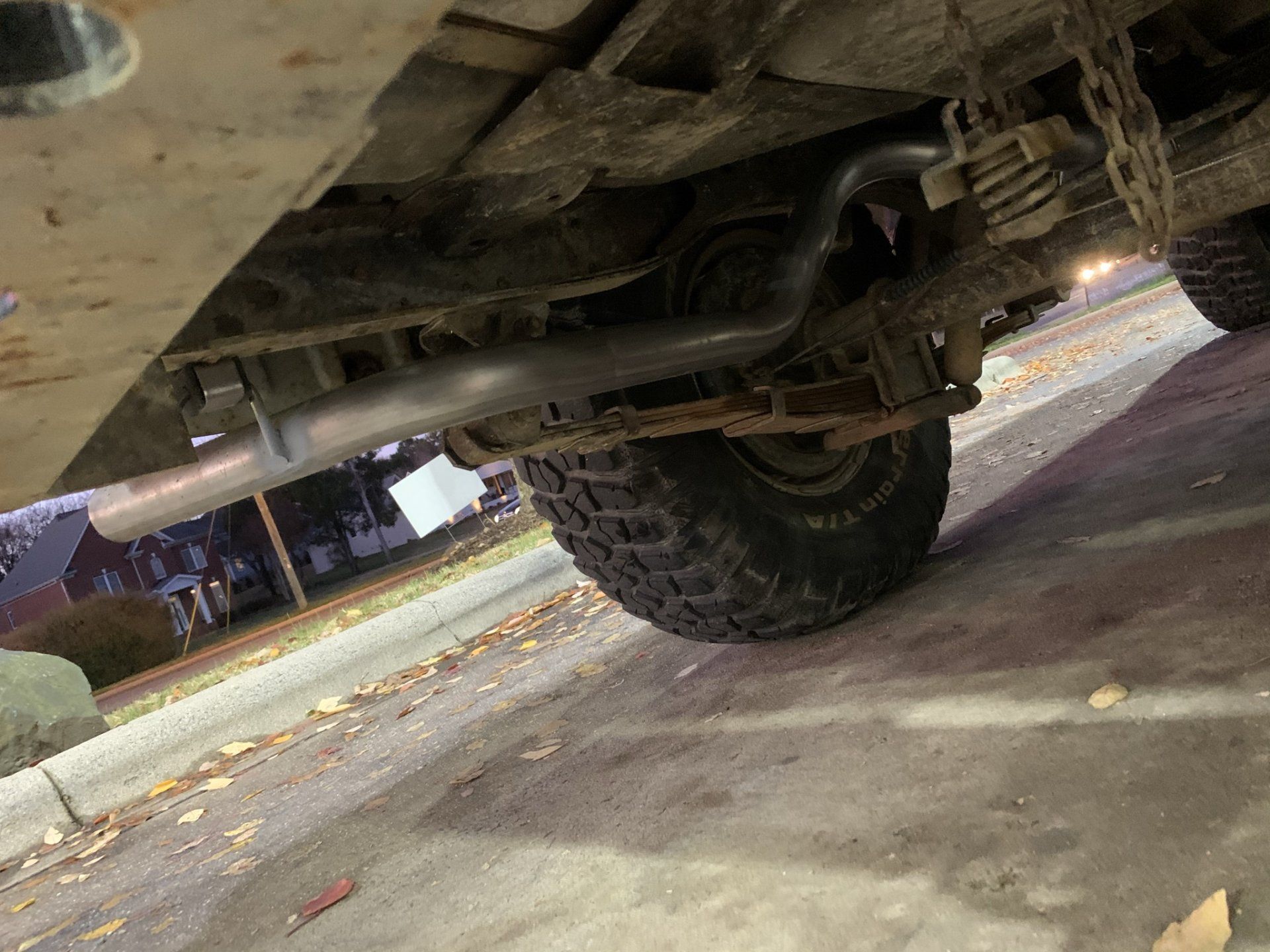

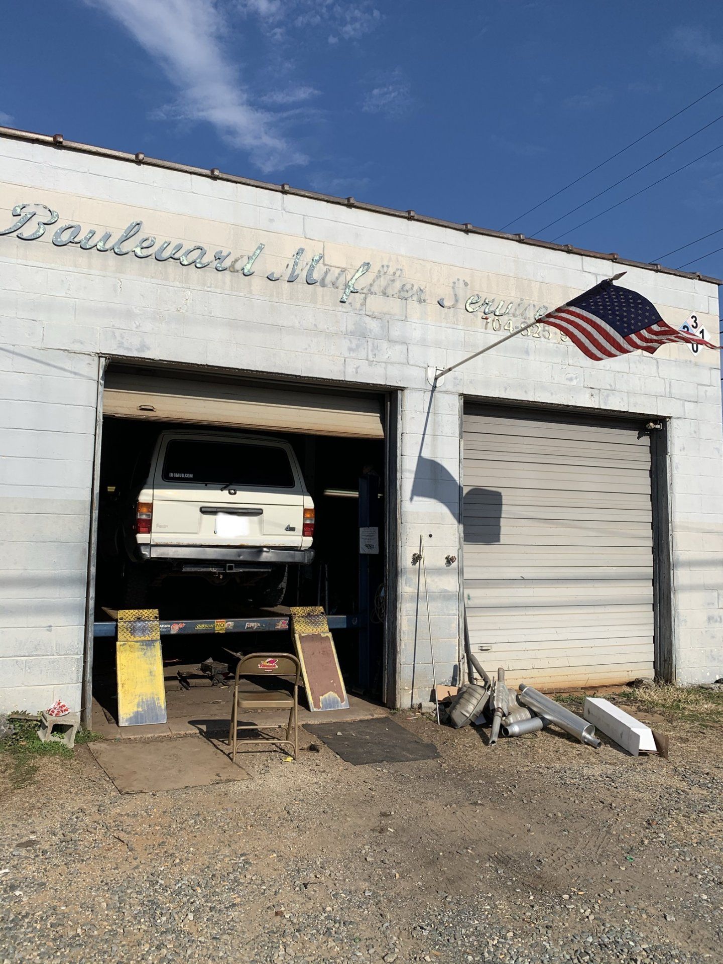

Belmont Exhaust Spa:
got a great recommendation from @roadstr6 to hit up Buck at Boulevard Muffler in Belmont for a custom exhaust. He is an artist and loves his trade... well he loves cars, speed, and good stories. In a two hour span I was in and out, and about thirty mins of that was he and I chatting with his buddies who came by with awesome cars and trucks to drool over.
Against the mud grain, I opted for his quieter than stock option, since my son sleeps above our garage and since for years I’ve been disturbing my neighbors and going def in the process. We routed it out the drivers side behind the rear spring... I originally palnned to route it through the leaf spring to keep it closer to the tire but my springs are too old and flat. He knew to keep it above the frame rails, and selected a thin and long muffler from a hero, yikes.
I’m super thrilled with the result and even stoked about the very fair price. Will need to take the forty there soon also. Very fun to hear some of his stories and to have gotten to learn a bit about metalology and tube bending in the process. Now I get to enjoy the wonderful tweety-bobber pop music that my kids crave...
Had him move my bumper back and over a bit to ensure my unicorn bumper corner doesn’t melt... jk don’t worry, no bumpers were harmed in the process!
View attachment 2525225View attachment 2525224Had him move my bumper back and over a bit to ensure my unicorn bumper corner doesn’t melt... jk don’t worry, no bumpers were harmed in the process!View attachment 2525226
View attachment 2525227View attachment 2525228
yeah I had him do some work , it was cheap and done well

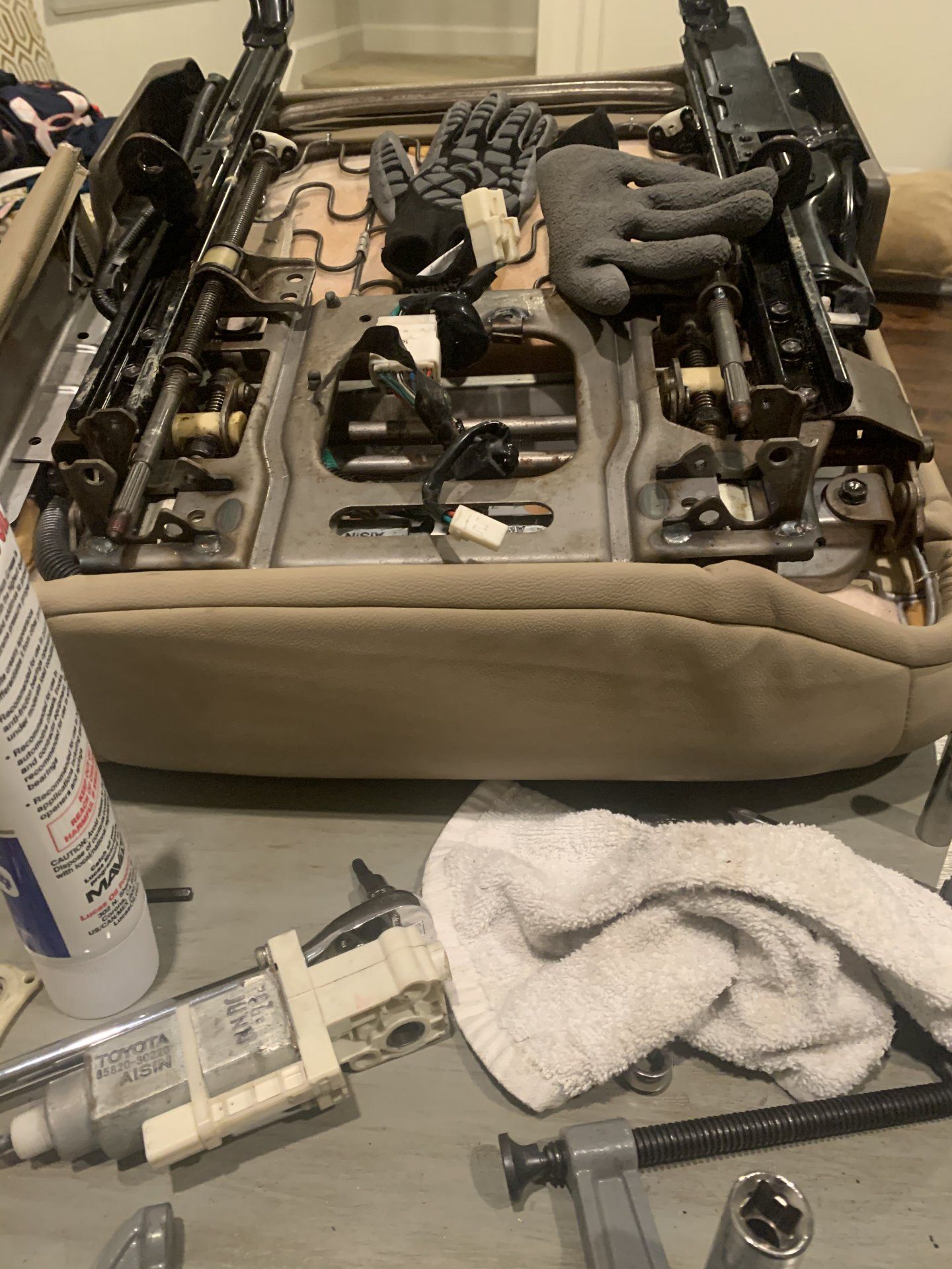

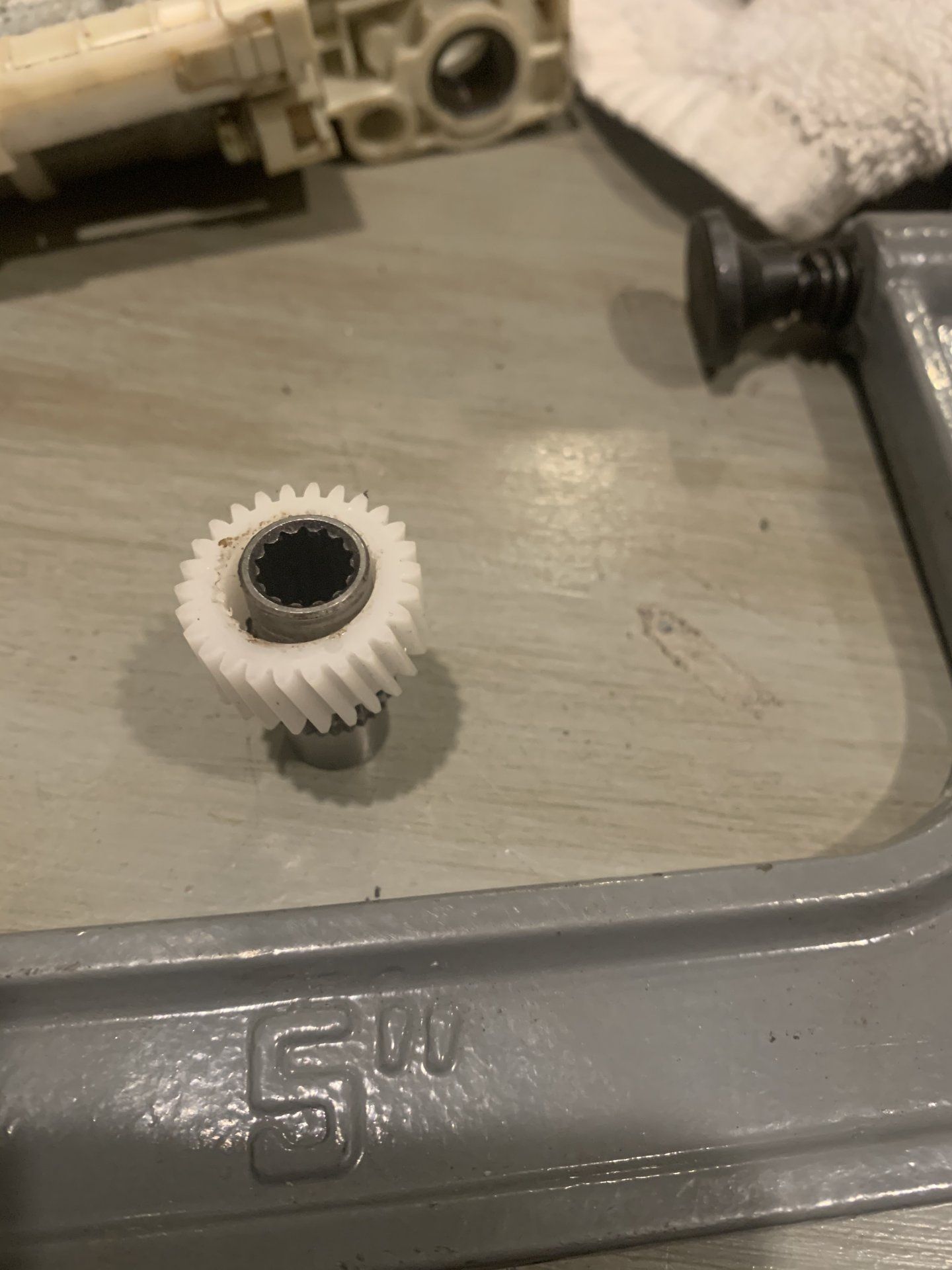

I installed two new gears in the seat this evening.
I am still waiting for new cap and two more spare gears to arrive in the mail from Gamiviti.
If they get here tomorrow I will install the seat and see if it works. One thing that I saw on the video that Gamivit made is that he test the seat out first before bolting it down to allow the gears to and the seat to adjust. I will follow the way he does it in the video and hope the seat works. That’s the only difference in how I have done it I. The past.
Fingers crossed for ya' Del. I feel the frustration!

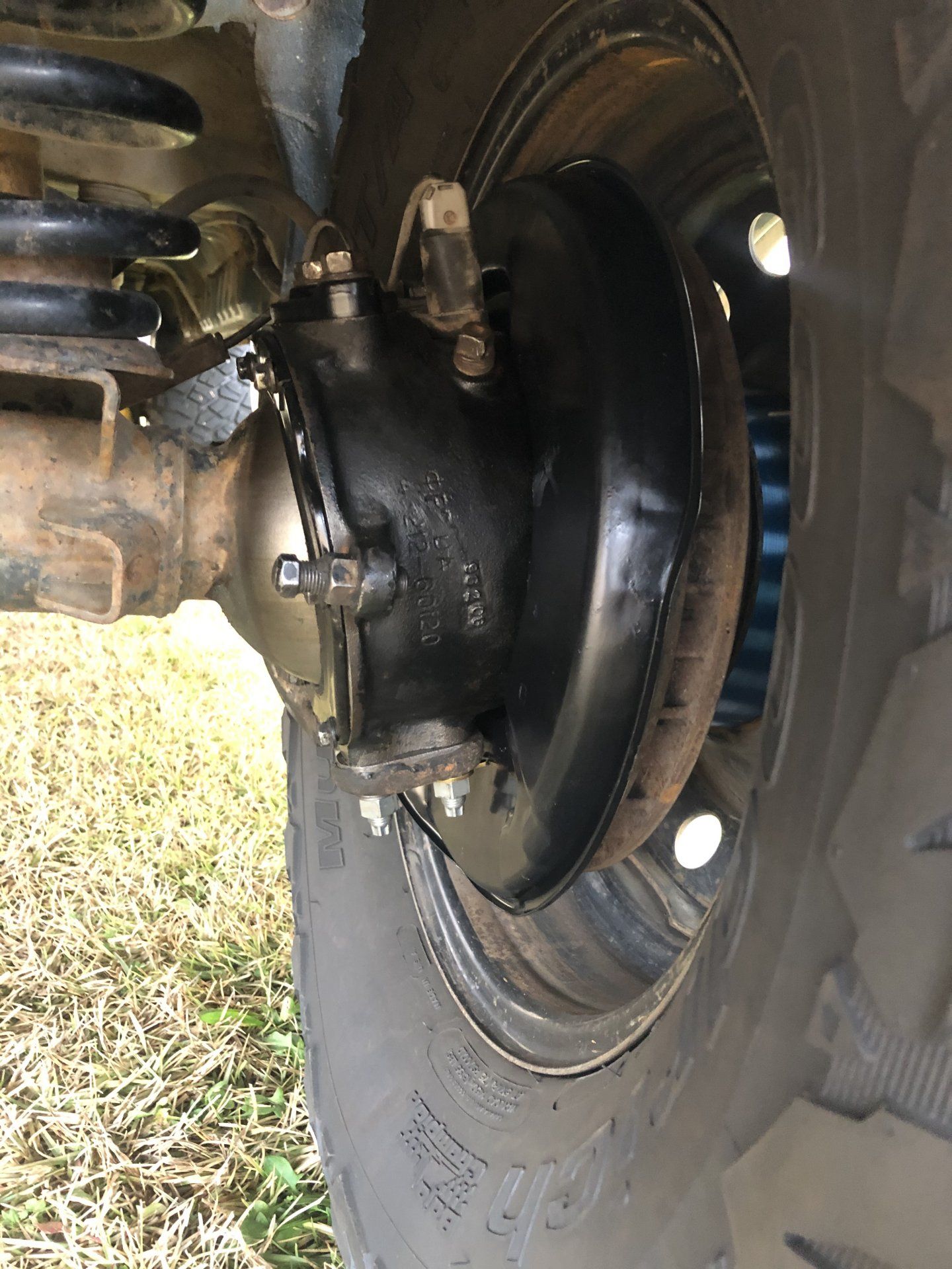

Need some assistance. 2000 100 Series.
The truck has a very strange pulsation when applying the brakes. I removed all 4 wheels and calipers are tight, rotors are all smooth and there is plenty of brake pad left. The pulsation does not effect the steering wheel. I did discover a loose brake line mount and some brake fluid around the connection point. The thing is the brake fluid level has not dropped in 10 months. I went on the 100 series forum and one guy only replaced rear pads and fixed the issue.
Questions.
1. Has anyone run into this issue before in 100 or other vehicle?
2. Could the loose bracket have allowed air in and causing the pulsing? See picture. I tightened it back up. It seems a little wet. Could that brake line be damaged at the spot and swelling when the brakes are applied causing the pulsation?
3. Anyone ever fixed anything like this with just new pads only?
In emergency stops it does as it should. Everything works as intended. Basically in normal driving, the brakes basically pulsate when applied.
Thank you.

For me, warped rotors has always been the cause of a pulse sensation when braking. If you already checked for that and eliminated that possibility, please accept my apology for missing it.

Likely you have uneven deposits on the rotors. I fix those with re-bedding the brake pads and the system scrapes away those high areas. Typically repeated (5-6) hard stops from 60-20 or so followed by a longer cooling drive.
" Despite the popular myth, brake judder is not caused by warped rotors. Judder is the result of a thickness variation in pad buildup on the rotors' surfaces. "
