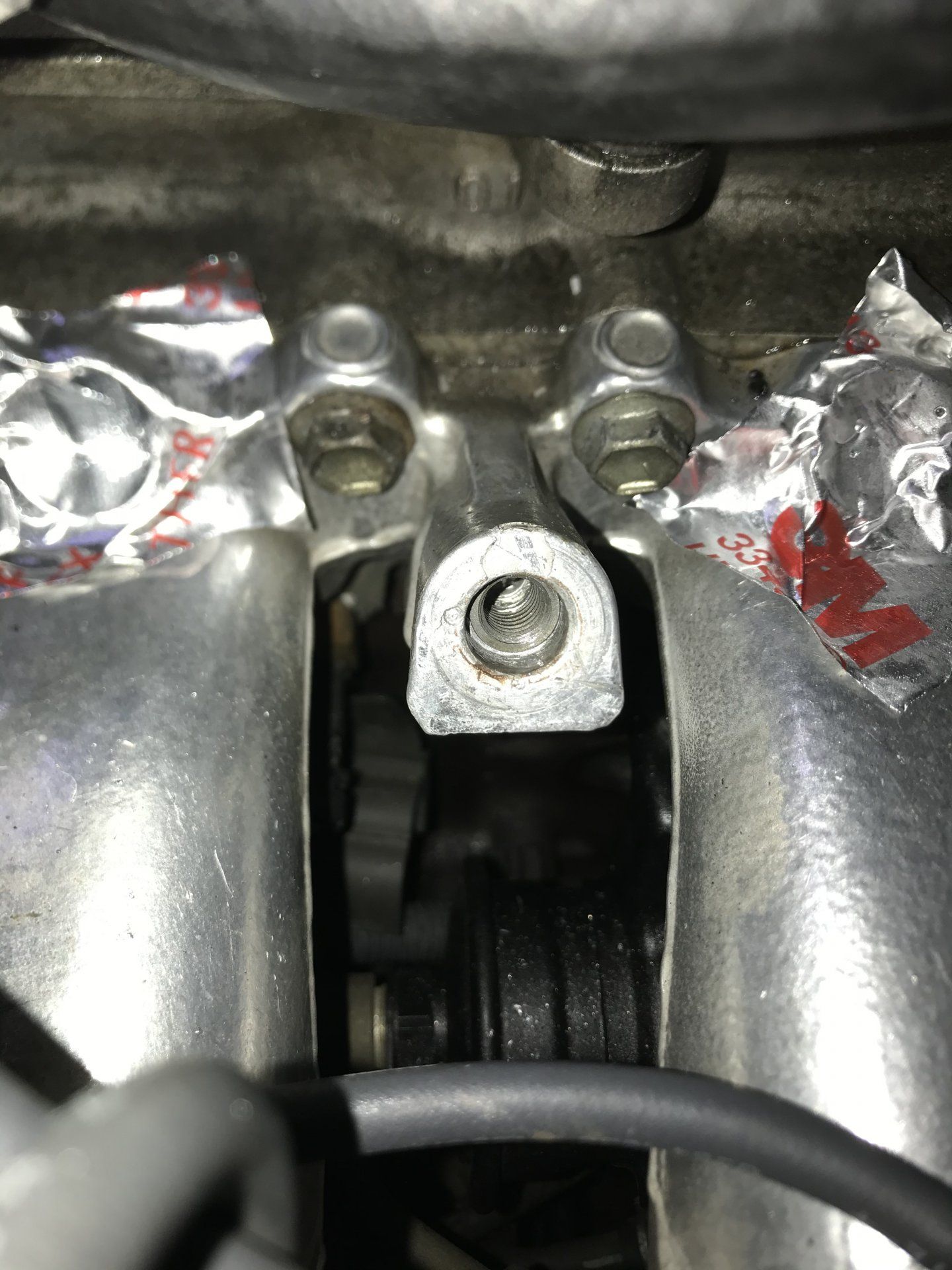

Looking for some Info/assistance here.
While replacing the fuel injectors on my 80,
I damaged 2 of the 3 bolt threads for the fuel rail, in the aluminum lower intake plenum/manifold. (pic below)
I thought I did it right, Kroil soaked the stock steel bolts then removed, chased the threads with the correct size tap, M8x1.25. Met no resistance when chasing the threads. Added some cooper anti-seize but upon tightening to 15 ft. lbs. as per the FSM, the threads gave out.
Must have been overtorqued at some point in its life.
Anyhow, looking for info on moving up to the next size...
I have an M9x1.25 tap but bolts of that size are nowhere to be found; local Ace, big box hardware stores, McMaster Carr. Plus with a step up to this size, the fuel rail boss would need to drilled out to accommodate.
The manifold bosses look like they have a bit of room to drill out and retap.
Perhaps switching over to a standard thread might bridge the gap between M8 & M9?
Thanks
i would recommend time-sert and use the factory bolts. you can purchase additional inserts apart from the kit. and even a guide to help get the tap started straight.

You should really use a thread chaser / thread cleaning tool and not a tap. MOST of the time you can get away with it, but sometimes you'll cut the existing material more than intended when "chasing" with a normal tap. I was just reading about this when working on my LS engine. While I have a an iron block where it's less of a big deal, lots of discussion popped up around this for the aluminum block guys cleaning out the head bolt threads on the LS blocks. @fourtrax nailed it, just do a couple heli-coils and it'll be stronger than factory anyway.
Got the Timeserts installed.
FYI - if anyone encounters this in the future, the timesert counter sink will not fit in the boss but the original threads were recessed a quarter inch so no need for it to sit flush.
The fuel rail spacer makes a great drill guide.

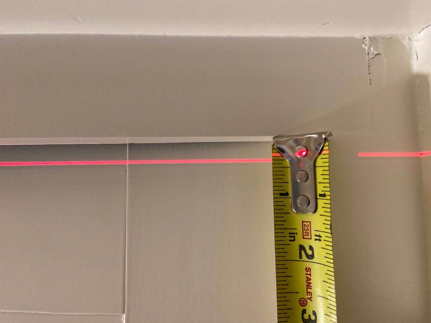

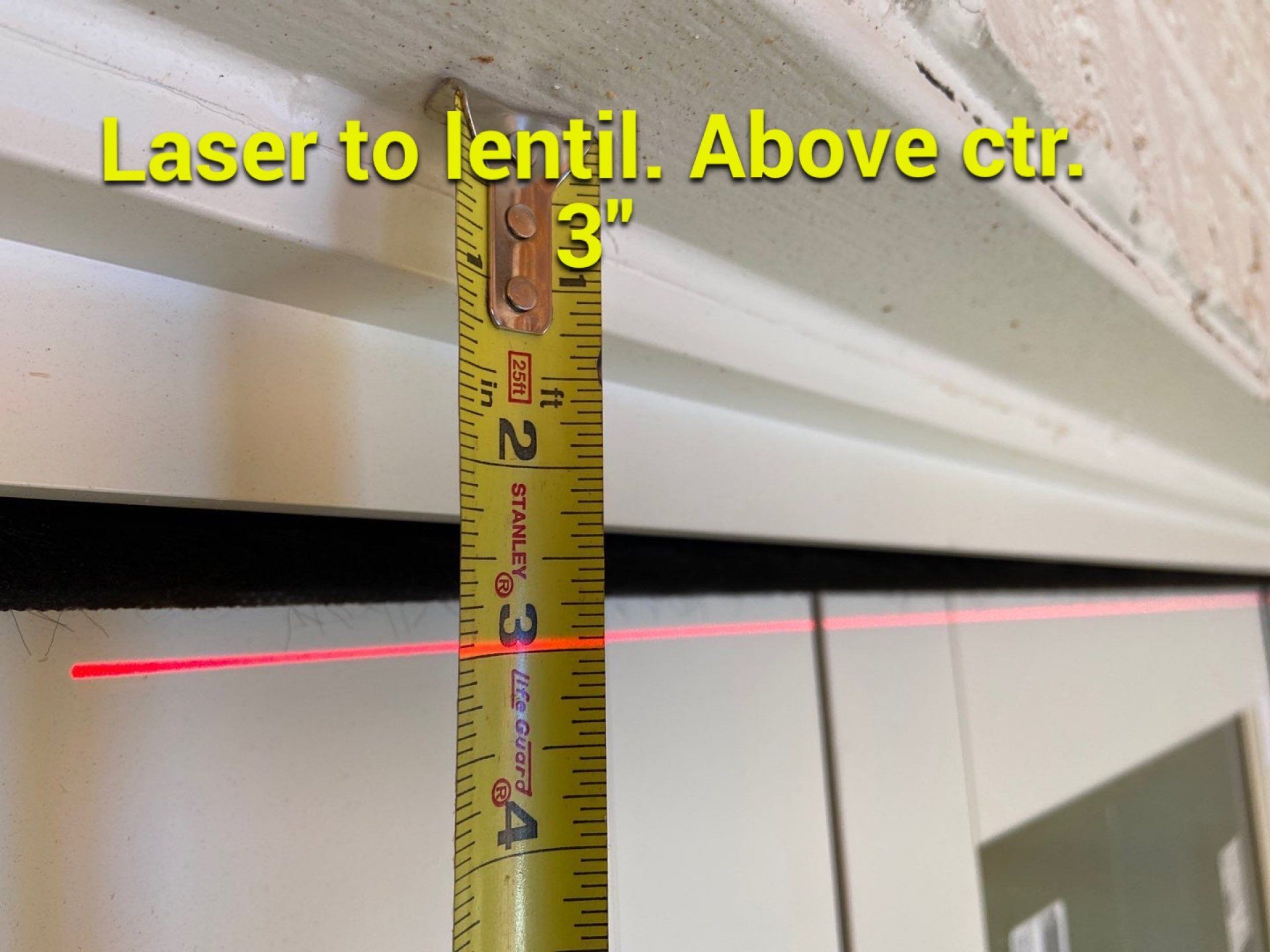

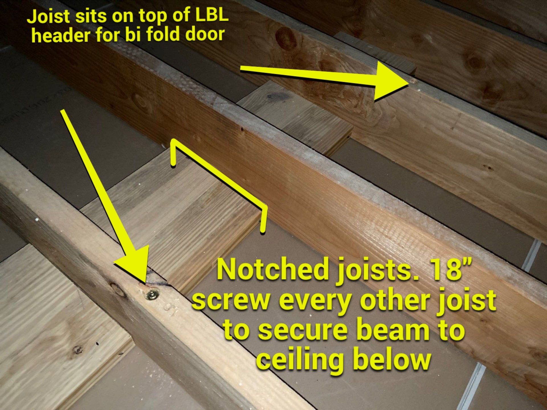

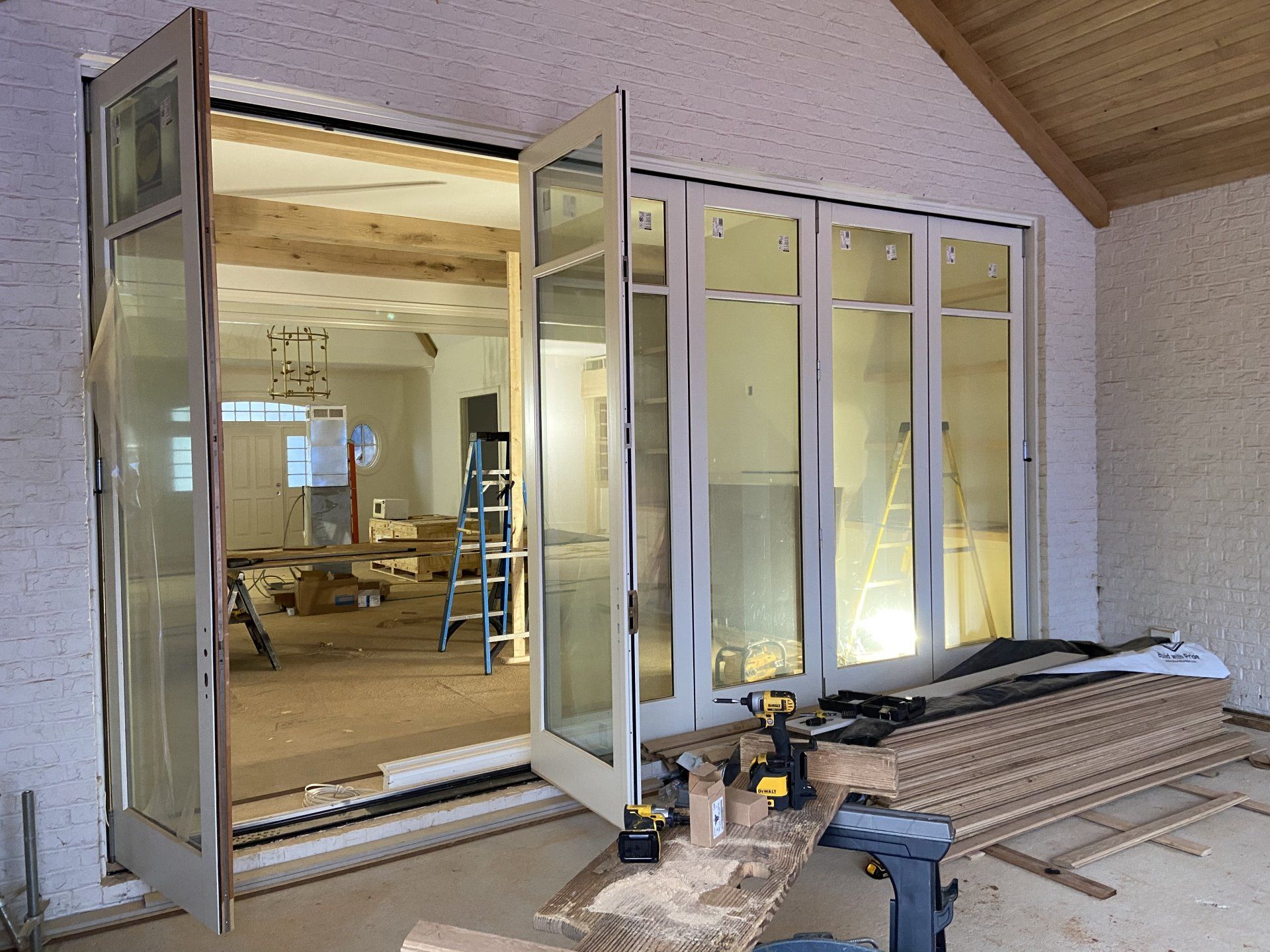

Pics of that project/door? Or the repair. Repair is yet to come. Diagnostics day which required working on door to get it to open first. Steel lentil has 1/4 inch sag over 18’ which builder says is normal so I’ll be back Monday to tear into casing and jamb extension to prove his header is sagging. Hard to believe a doubled up 2x28” LBL would sag. But then again they don’t seem to believe me adding multiple 1200lb beams to the ceiling could possibly affect our door. It’s always a product or install fault till you prove them wrong. 🙄

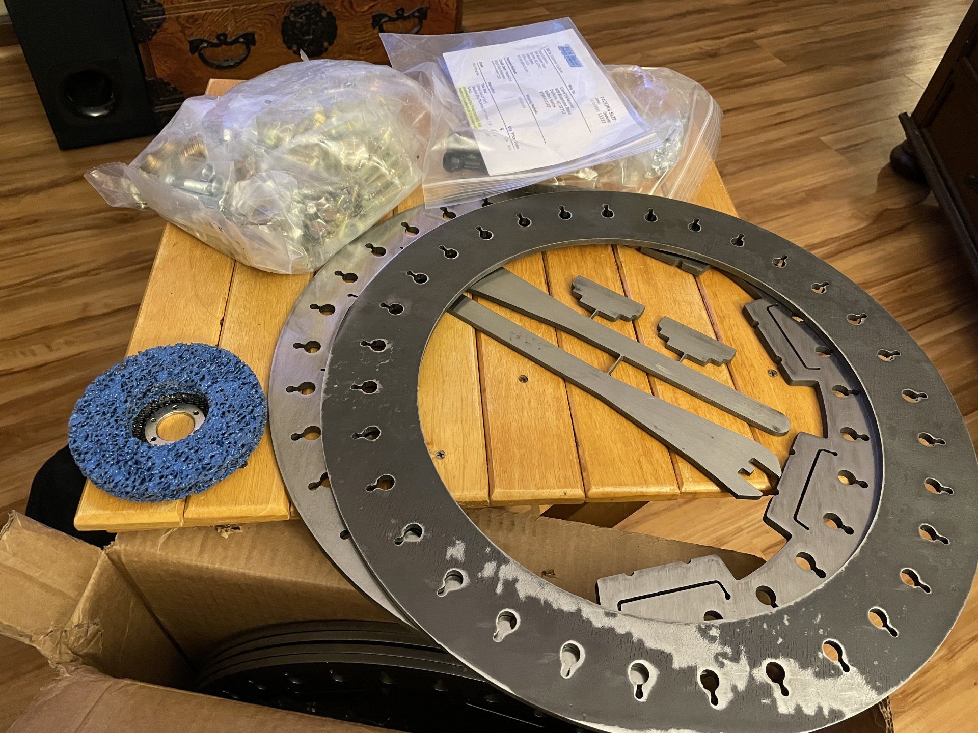

4 in the box, two on top. Are you doing double beadlocks or single beadlock with spares?
The two on the table are one inner ring and one outer ring, both needed for each wheel. That box just has the outer rings. So it’s five sets for the four corners plus the spare.
