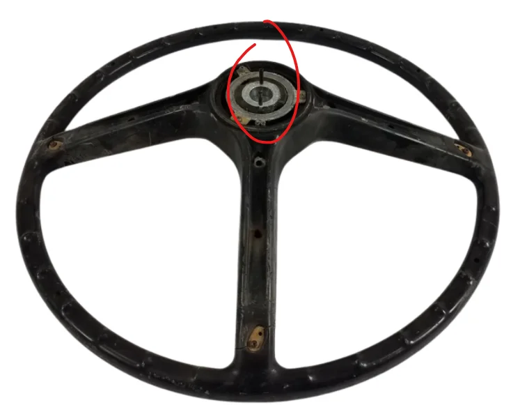

Pull your steering wheel and look for the tiny little roll pin that should be on the underside of it. There should be one...maybe two on a '77, that trip the turn signal back to the neutral position. I'll see if I have a pic.
edit: yep, 2. I'd wager the dimensions for a hardware store replacement can be found on Mud somewhere.
Fantastic. This is exactly what I need. Thank you very much for your reply. Without it I would have had to start all over again to try and figure out why the blinkers were still not canceling after installing the new switch and putting the steering wheel back on. My guess is that those pins are long gone, but your picture will help me replace them if need be.

I’m in the same situation. Did you find or make replacement pins?
