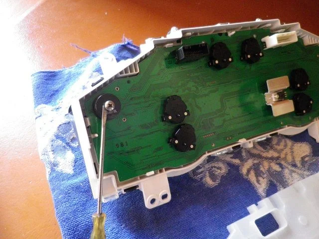

I disconnected my chime about 6 years ago. That doesn’t mean I don’t buckle up every time I get in the truck. I can easily turn it back on if I need to.
