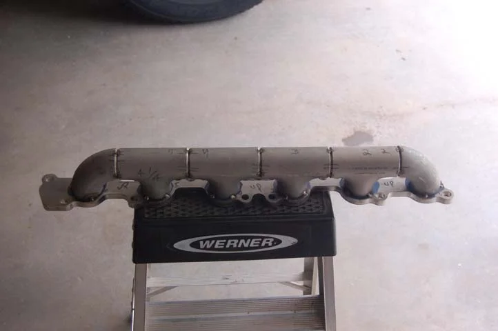

Attached is the over view of the manifold as it sits now. The elbows and "Ts" have been cut down to fit properly and chamfered for welding. As some will notice this is how another manifold was built recently.
The next series show how expansion will be handled. The manifold will eventually be cut up into three sections. The center section bolt holes are round while the outer sections are elongated. Hopefully I've done my math correctly when calculating the expansion differences at operating temps

Looks nice Rick. Did you go with stainless? I'm looking forward to seeing the flange fabricated.

precision. fine work
you probably already know the following:
be sure not to make any of your 3 cuts in the flange till all welding is complete as the flange will expand if you do.
have the flange surfaced after the cuts are made as it will be holding some tension after welding is completed and will flex a bit after you cut the flange. if you surfaced before the cuts are made the flange will not be flat

We talked about this. While I drew up the plans it's two other professionals doing the work. The manifold as it currently sits will be clamped to a 1" piece of steel during welding. Once the entire piece is welded it will be heated to 1500* to stress relieve it and then the two cuts in the exhaust flange will be made. The EGR passage will then be milled and then all three flanges, exhaust, turbo and waste gate will be resurfaced.

Looks great, and really professional. Gaps look perfect for welding. Much easier than trying to fit the 90* elbows. A little loss in potential performance isn't a big deal on a vehicle like we have.
Might be worth it to stress relieve the manifold after welding and before milling the flange. It might warp after a few heat cycles due to some internal stresses. Maybe not, but might be worth it if you hate exhaust leaks as much as I do.

Again, this isn't me doing the work, these guys know exactly what they are doing. All the joints look just like the one I posted. The reason for the sleeves is that they needed to be able to cut into the runner and weld it properly. They didn't want to just layer a bunch of passes over itself to fill in the void.

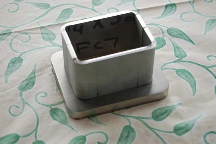

Attached are some pictures of the parts for the T4 flange. These are just rough parts and they need to be machined for final fit. The end result will be that the rectangle tube will be welded together and then slide into the flange itself.
So the tubing gets cut for the flange port. The sleeve is assembled and machined to fit the hole and welded in. Then the T4 flange is slid over the sleeve and welded into place. The same will be done for the wastegate however the sleeve is just a simple turning on a lathe.
