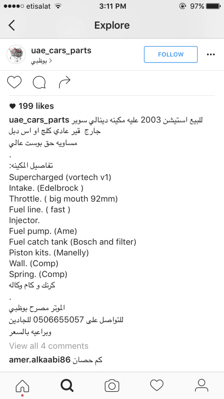

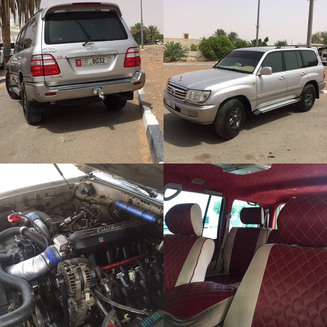

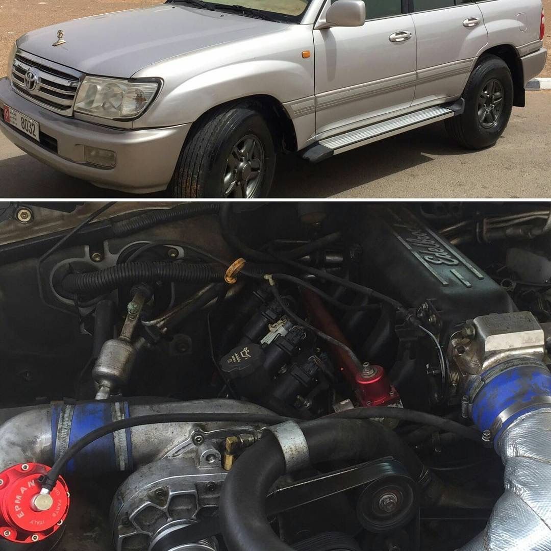

Spotted this ad on Instagram of a 2003 Cruiser with a supercharged GMC Denali vortech motor.
He's asking for $22k
EDIT: after looking at the pic a little more it actually seems like a centrifugal supercharger and not a turbo
