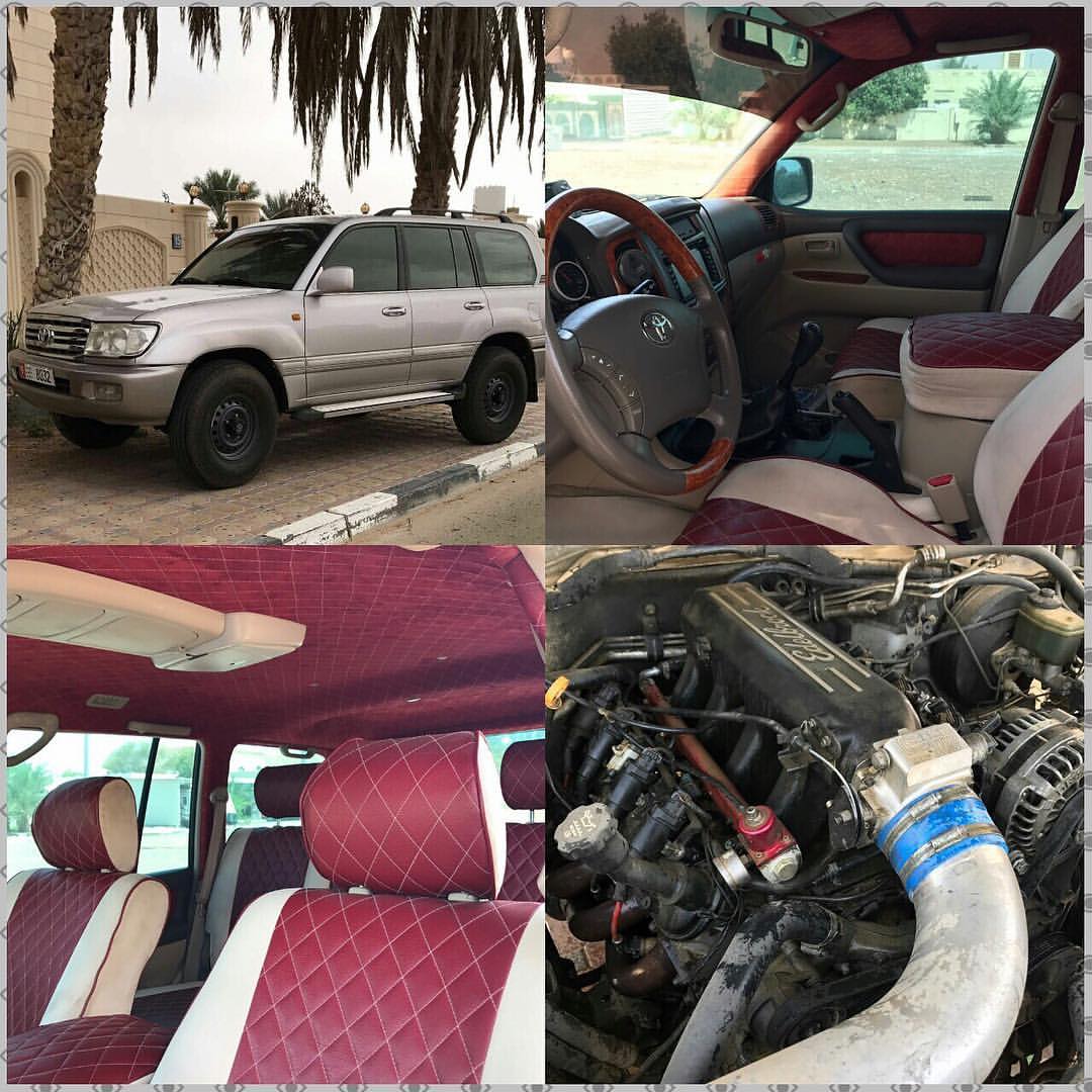

Turbo LS swapped 100 series

Apparently it's still for sale with new wheels.
$16k or trade with An SRT jeep
