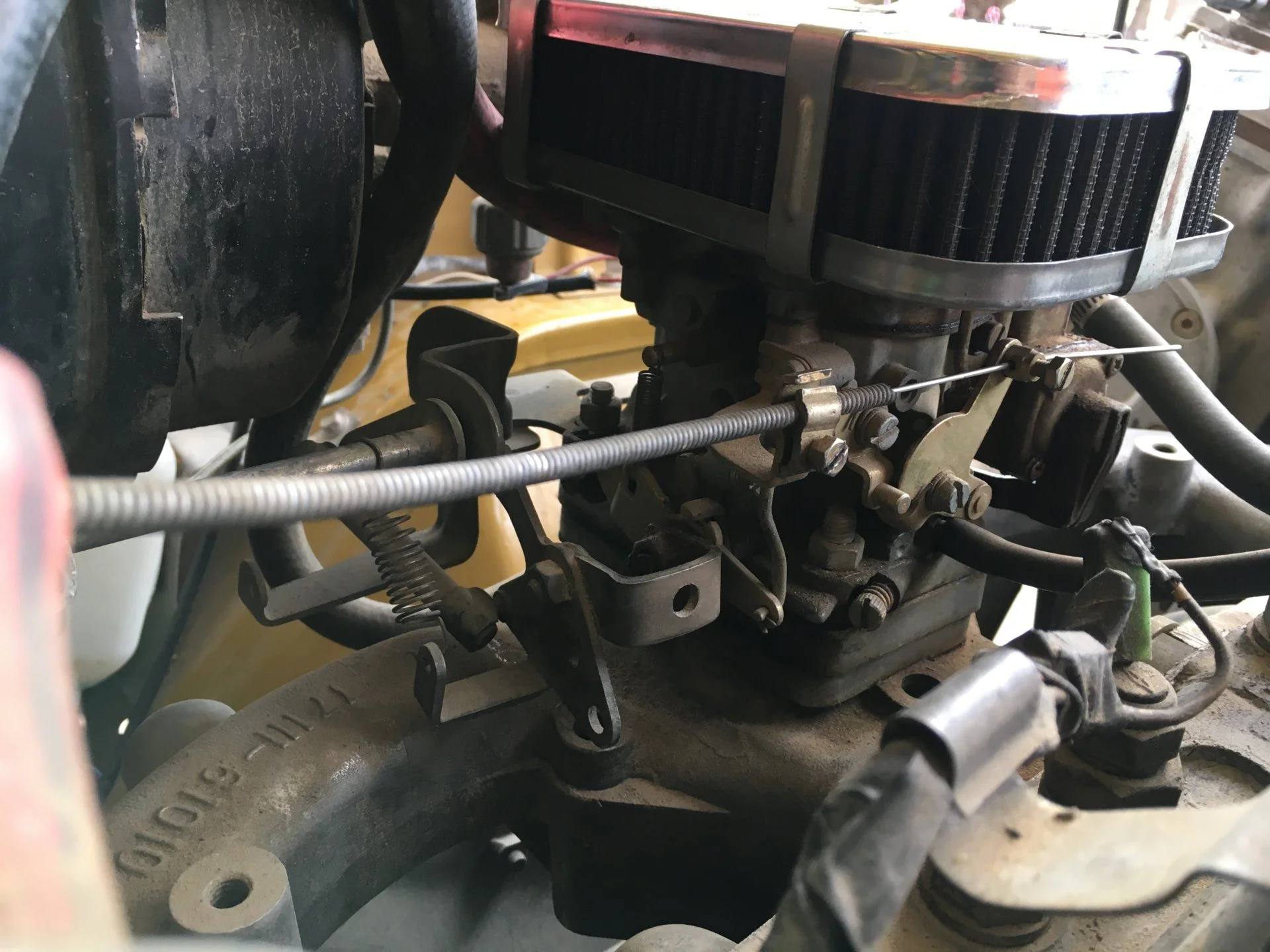

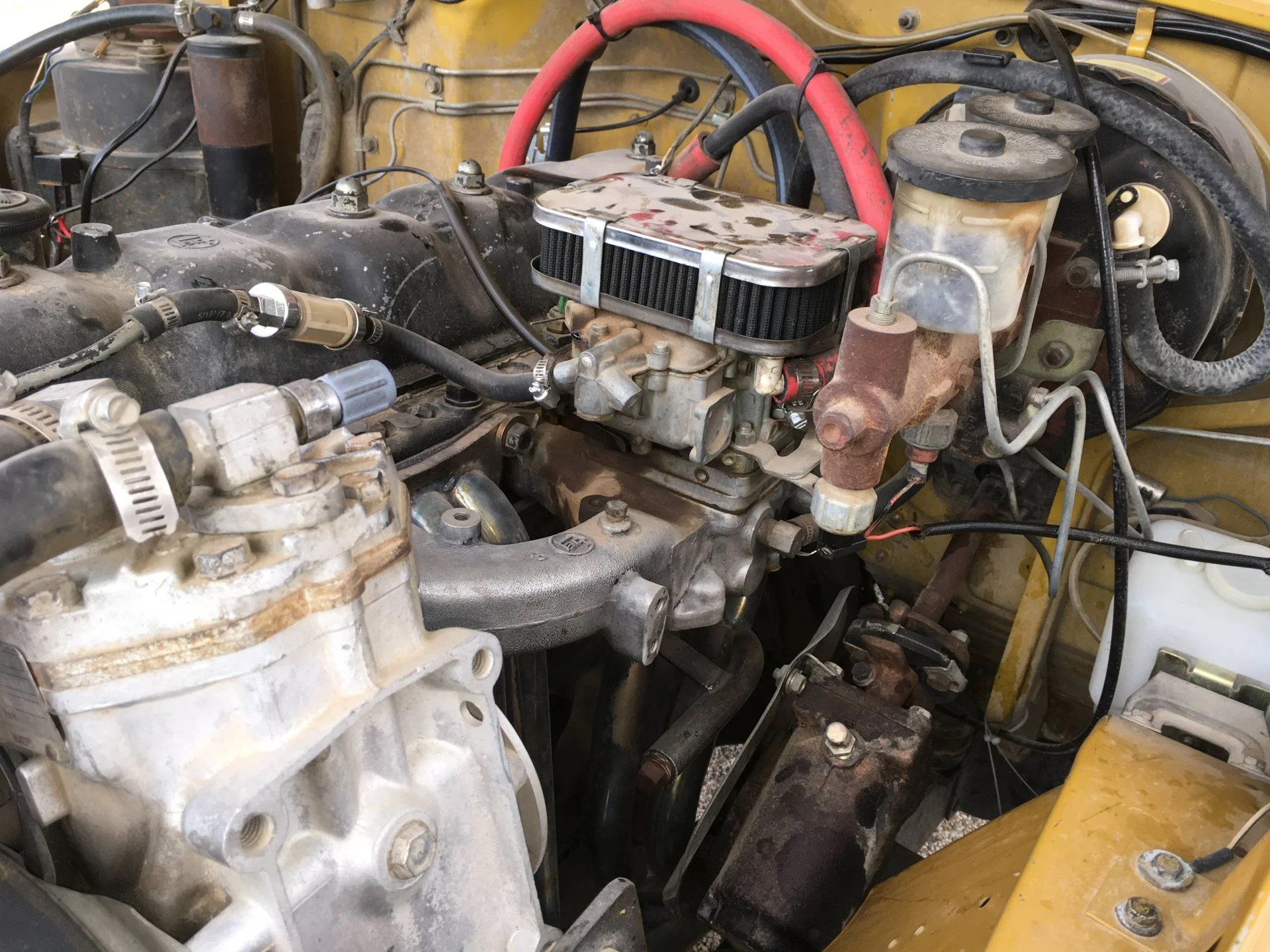

Here’s a couple pics, because pics are fun.

The primary throttle plate is likely too open at idle on these motors. If you time the motor with the vacuum advance line connected, then you will be running ported vac to the DUI-HEI unit, because the throttle plate is open by more than 1.5 turns on the Ilde Speed Screw. If you time the motor with the vac advance line disconnected, then you will be off at idle when you finally reconnect the line. Because the motor displacement is too big and you are at too high of an elevation, and the throttle plate is open too much to get the needed air for idle, but it still runs 'ported' vacuum.
I got an adjustable timing light from Harbor Freight. There is evidence that the previous owner of my truck was reading advance by placing marks on the harmonic balancer.
So, one option is running only centrifugal advance and static advance-twist on the distributor. The vac line is capped on the Weber, and you bump it up, at the base of the distributor, I forget how many degrees for your situation, but it is like 12* or 14*.
On my Nissan mini truck, my Weber DGV can't handle the elevation where I live. I run the truck up to 10,300' regularly. So I drilled a 1mm hole in the primary throttle plate, opposite the progression holes, and it gets enough air so I can keep the Idle Speed Screw no more than 1.5 turns in. It is dependent on elevation, and engine displacement, so an F or 2F might need two holes, one the primary and one on the secondary.
All of that aside, the only symptom of trouble, that you have is at more throttle. Changing your jets, or making sure that it is properly timed, is going to be important. Have you read your spark plugs for signs of lean or rich conditions?
I wonder if your accelerator pump diaphragm is cracked/ It looks kinda greasy at the four screws just to the bottom left of the fuel inlet line. They recommend changing these like as frequent as once a year, due to ethanol in our gas.

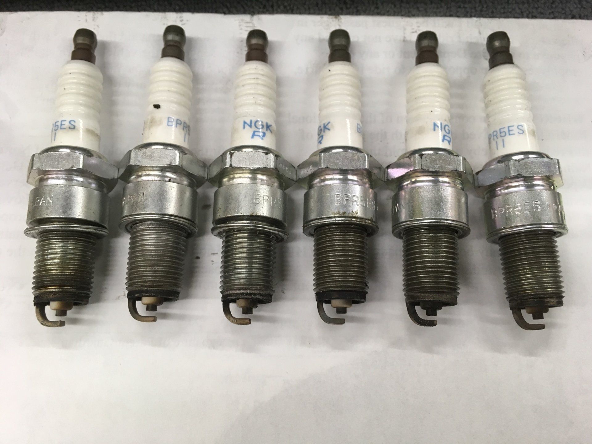

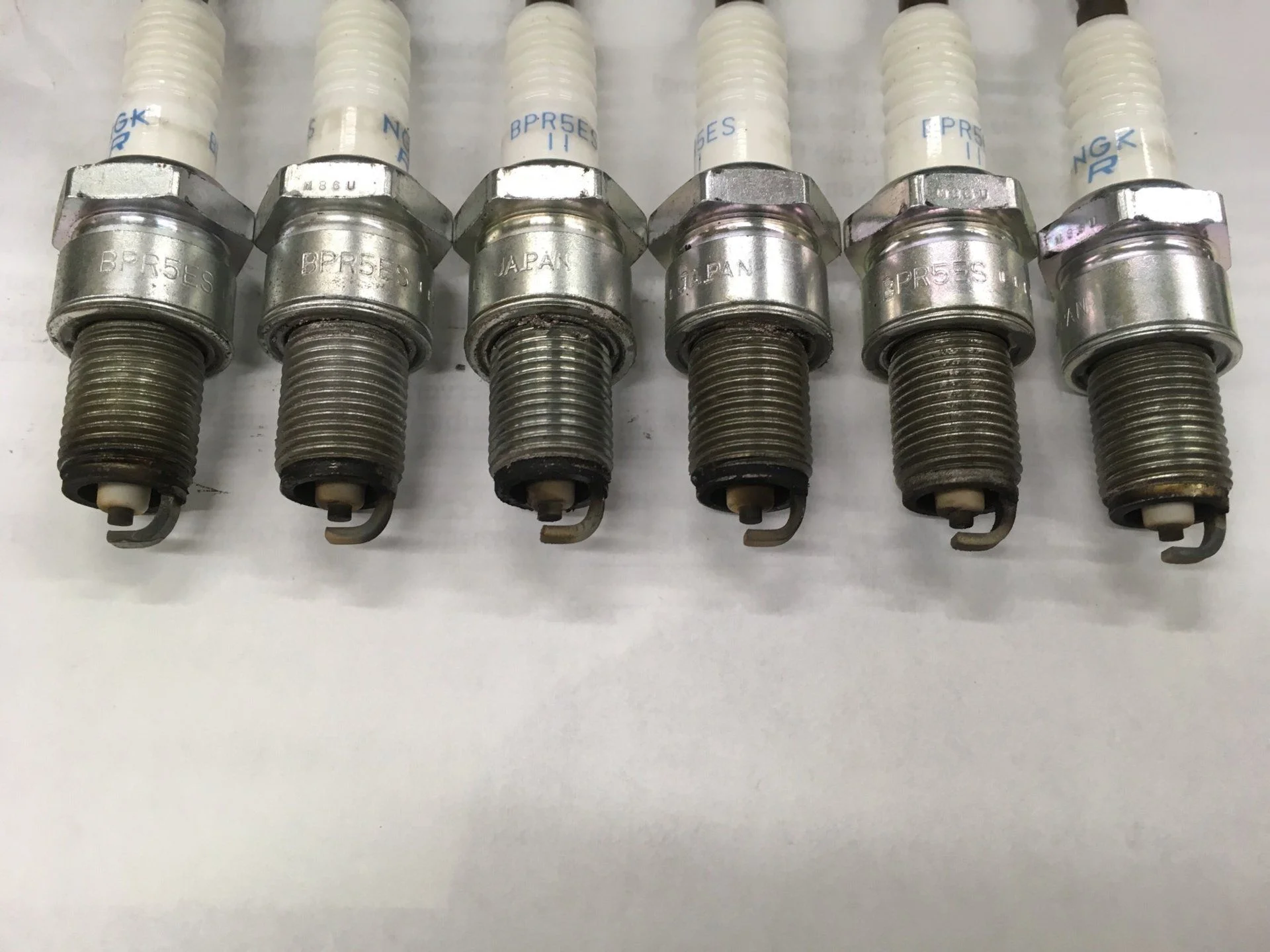

here’s a pic of my plugs.
Left 6-5-4-3-2-1 Right
They’re about a week old. Ran around the block a few times and then accelerated to where it falters and shut off the engine. Coasted into the garage and pulled plugs. Engine was probably not up to normal operating temp, but choke was off and running smooth.
Do you still have your old plugs?
Do you have dieseling (engine run-on) after you turn off the ignition, particularly when the engine is hot? Will running enough choke to barely get you at fast-idle reduce the faltering on the upper throttle range?
I don’t/haven’t had a dieseling problem.
I changed my plugs when I did the carb rebuild and timing. Prior to that it was running so different than it is now that I don’t thjbj seeing those plugs would relevant to the current set up.
I adjusted the choke so there’s a cm or more of throttle increase before the choke begins to close for a high-idle function. Leaving the choke in high-idle did not affect the stumble at the early/mid acceleration.

Squirting ether around, I found leakage in the stack of adapters that were installed to accommodate the Weber.
I will get some gasket material and re-make the stack with fresh gaskets. Is a little RTV or gasket adhesive recommend / discouraged?
