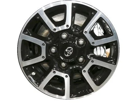

So I scored a set of 2019 Tundra off road rims and tires minus the TPMS sensors. I have new sensors (OEM) for the stock LC wheels which are getting snow tires mounted in a few weeks. The issue is the sensors for the LC (2010) part number 42607-33012 don’t look correct for the tundra wheels, if anyone is running the tundra wheels in the attached photo what TPMS sensor did you need? a OEM Tundra part or is there another work around?

I installed these Autel sensors in the same 18" Tundra wheels as in the OP.
I used the Autel Intelligent Technology Co TS408 Handheld TPMS Service Tool to clone my OEM LX sensors and program those IDs into the above sensors. Very simple to do, takes 30 seconds per wheel.
Thanks for the input. The issue was the sensors were sitting higher (away from wheel towards tire) and catching the bead a lot more then I liked. I guess I just have to be gentle and see how it goes. I appreciate everyone’s feedback !
