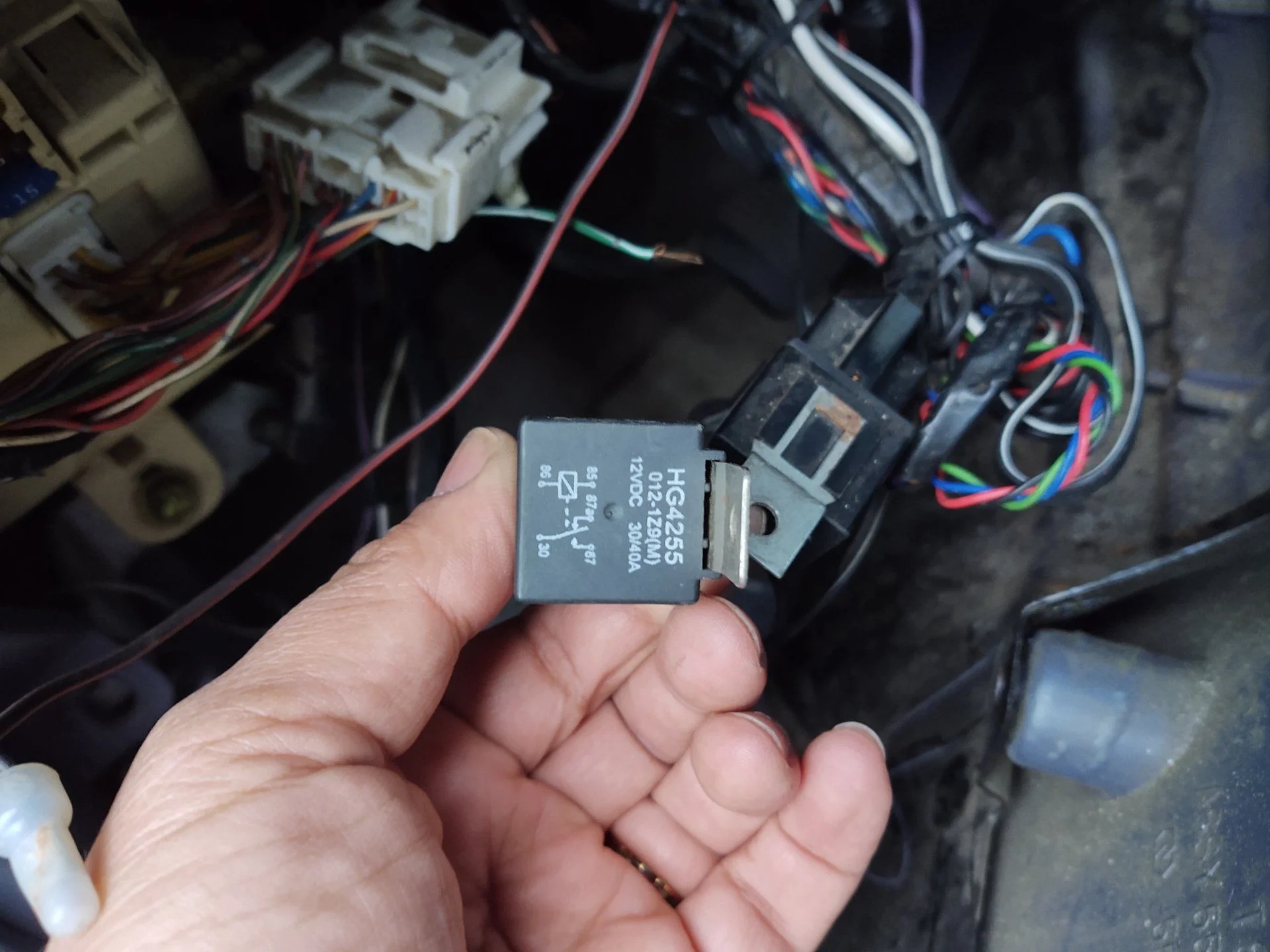

Looking around at the nest of wires underneath the steering wheel, there's a weird resister that I don't think should be there (pic attached).

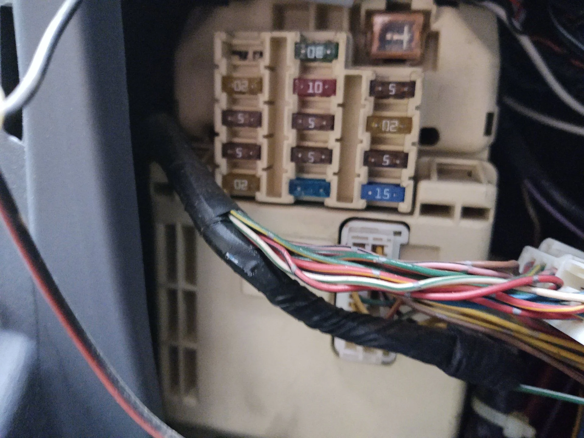

Also, one of the fuses is missing from the fuse box. Could either of those be implicated? The horn doesn't work, which makes me think that the PO disconnected some things, maybe because the airbag also wasn't working and would have thrown a code?
