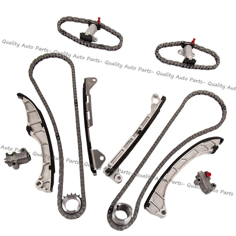

Sending myself in circles. I need a timing chain KIT for a 2015 Tundra with the 5.7. I can find individual parts but not the kit (We order a 4.7 timing belt kit here in AU with all the seals and parts required)
Does such a thing exist?
Prefer Genuine parts not chinese knock off's
Toyota itself rarely does "kits," though individual dealerships or OEM parts suppliers can build a kit for you. I don't understand why they do it (or don't do it, rather) but the last 5.7 timing chain job I did, I had to comb through diagrams to make sure I got everything I needed to do the job. And I still missed a few gaskets, and Toyota mislabeled a tensioner, and I ended up with two LH tensioners....the whole job is tedious. From parts to doing the chains. It sucks.
Call or email cruiseroutfitters.com (new website is cruiserteq.com). Kurt and the guys there are fabulous resources and likely can source all the parts you need, if you don’t mind the extra week or two to ship to Australia.
