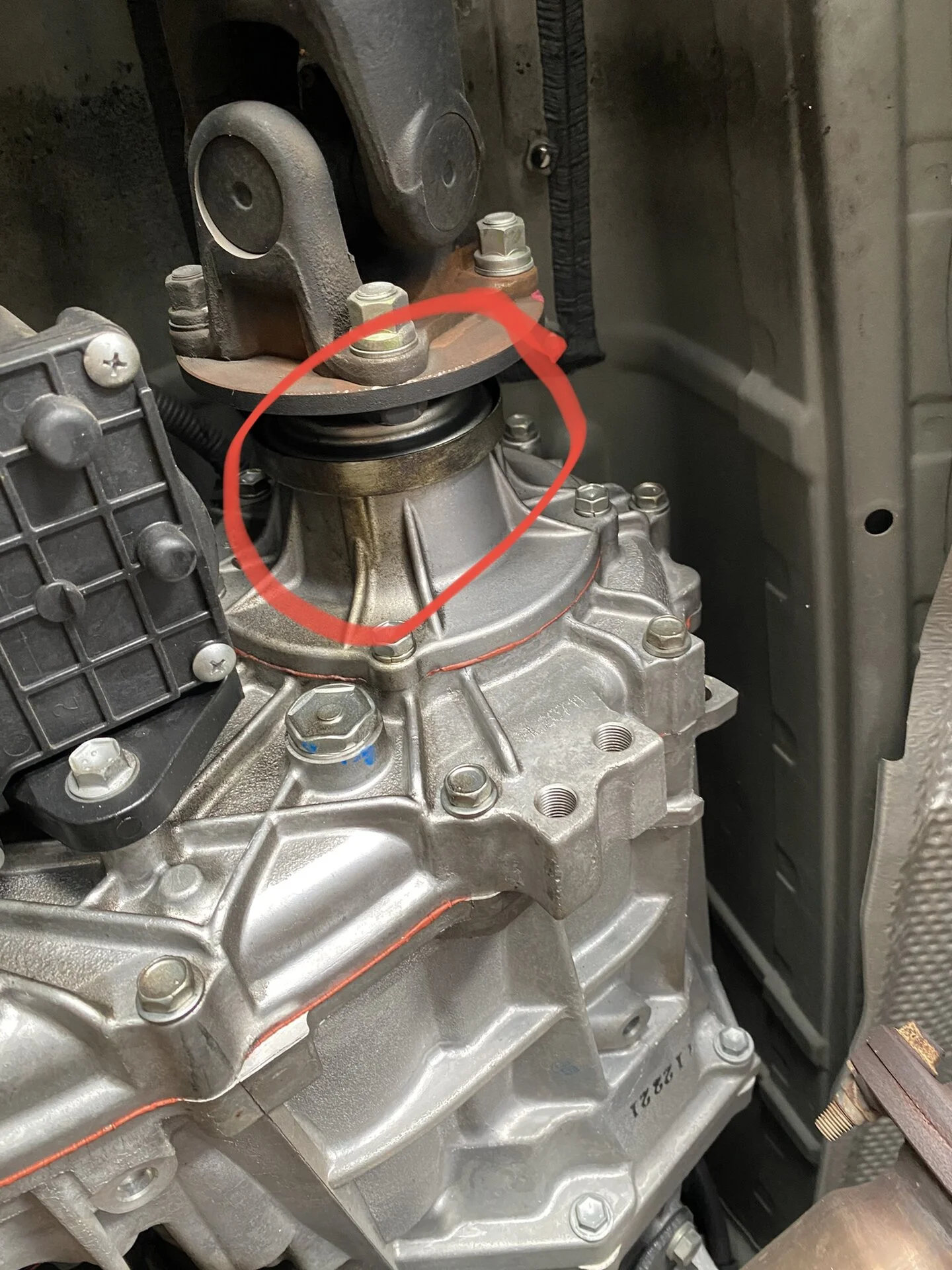

I have this exact issue on the output shaft. I planned to top off the fluid and keep running it. The issue was identified on a 2018 at approximately 38k miles and the vehicle currently has 50k miles.
Is this tech tip something the dealer ship will cover?

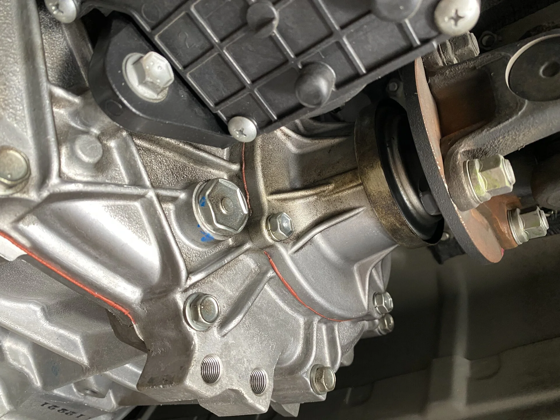

A few photos after wiping off the excess (one small accumulation point). I have not noticed any drips on my garage or concrete driveway so it is minor seeping at this point.
Assuming it's still under warranty, they should. And especially if it's leaking enough to leave drops in your garage!!
+1… if still under warranty you could have them check it out. This could also secure coverage on affected part after warranty if it becomes more active leak than a weep or seep in the future.
