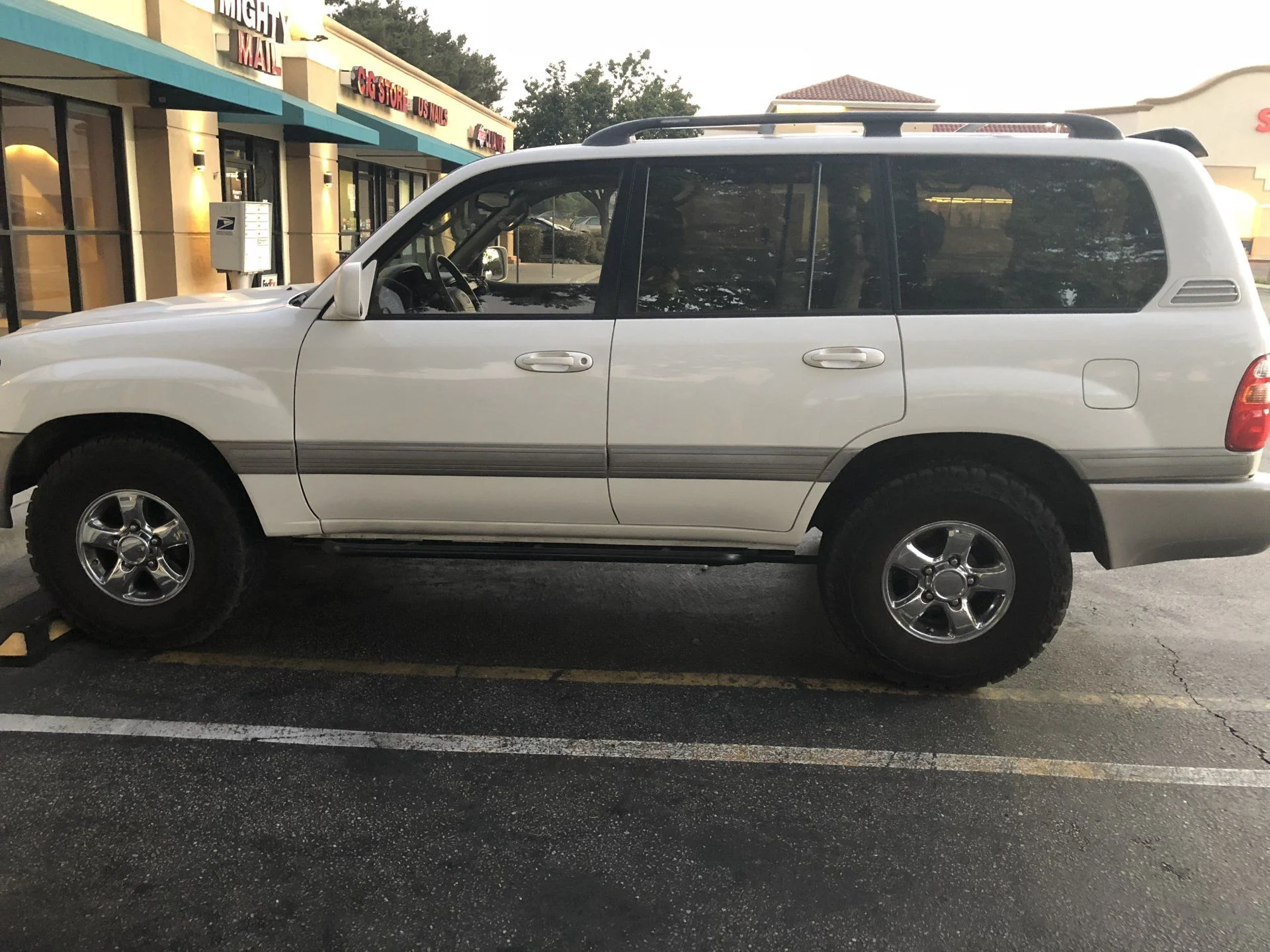

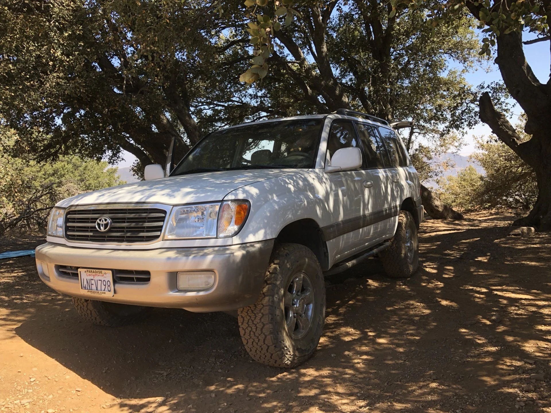

Here it is the day I brought it home.

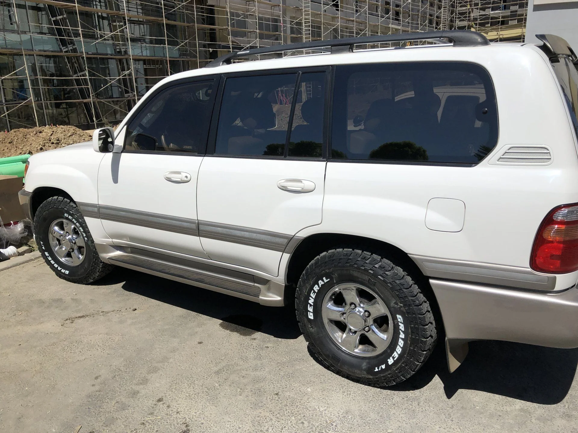

The tires were bald so I quickly had a set of 285/70/16 General Grabber ATx’s installed. They came highly recommended by my friend who owns a tire shop.

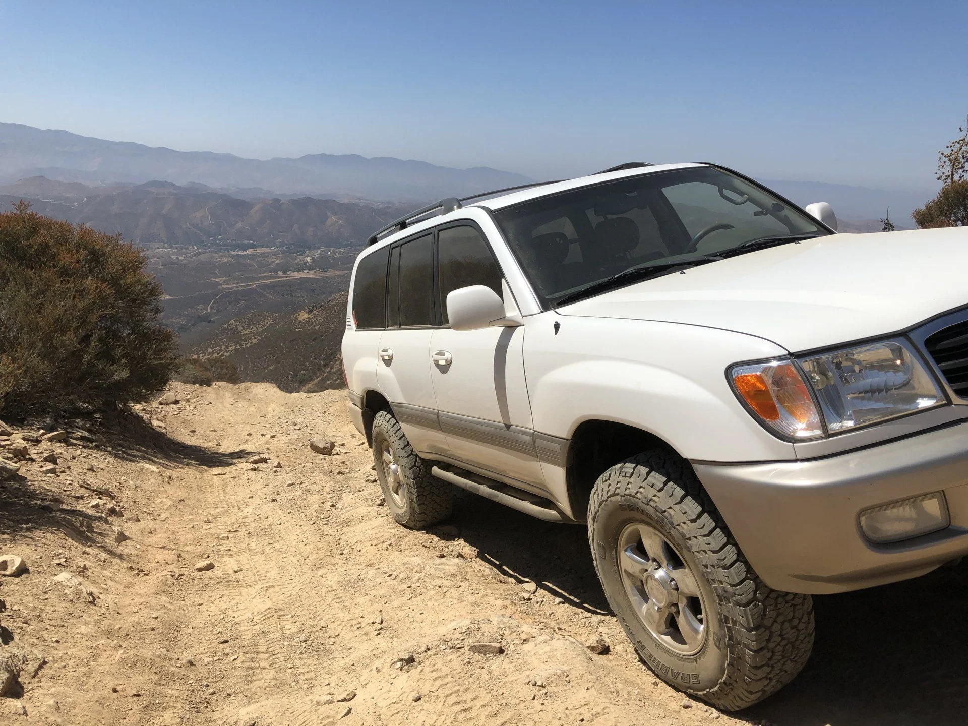

I immediately took it up some of the steepest dirt roads I could find and it did extremely good. Except I got high centered on the running boards so it was time to loose them.
After a quick trip to lake Arrowhead on some actual trails, I realized I need sliders, and that the white letters are not going to stay white for long. Any clawing up against rocks and they were permanently turned black. So I had them flipped around during my first tire rotation. And I had a local fabricator make me some sliders. They came out shorter than I expected, so we’ll have to work something out with that. But this is how the truck sits right now.

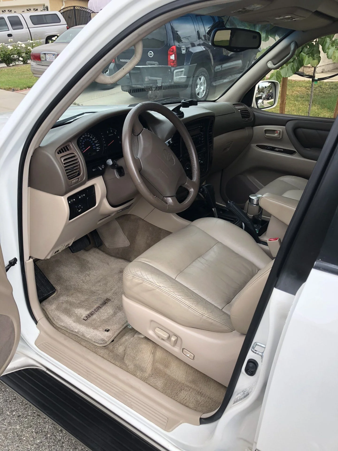

Love the truck and progression. What are the black things on the seatbacks? Have 2 under 2 and these look like they're very useful.
Awesome! They are just seat protectors. They stop the car seat from rubbing the upholstery and stop any food bits from falling through the cracks.

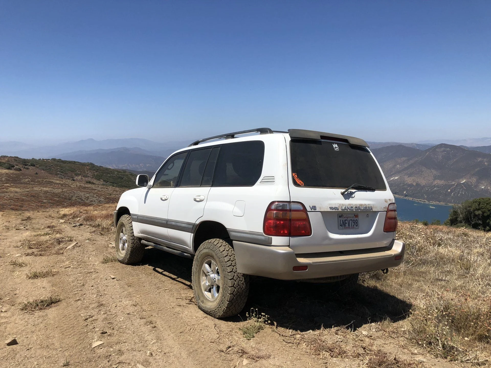

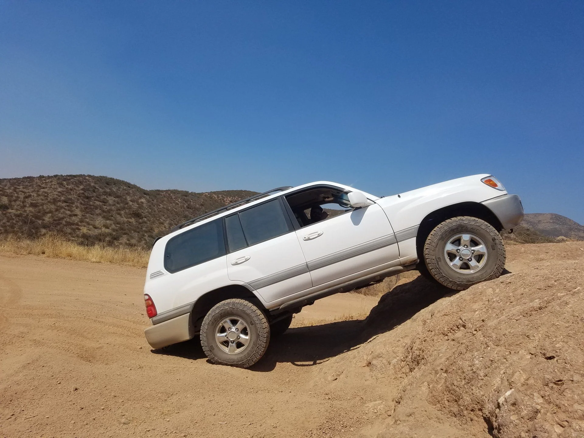

I got my lift kit installed. Had some trouble along the way, but @reevesci was very helpful along the way. Very thankful I got the kit from him.
We took the truck up to Santa Clarita to show my wife and our girls what the truck can do. They all loved it.
The tires performed great. I ran them at 18psi the whole time. They seemed to have great traction. Pretty much anything on this trail I pointed it at, it went up.
Also, ran into a group of Land cruisers up there. One had some cooling issues. Nicely built rigs. If it was any of you guys, hit me up on here. I’d love to go wheeling with you.
