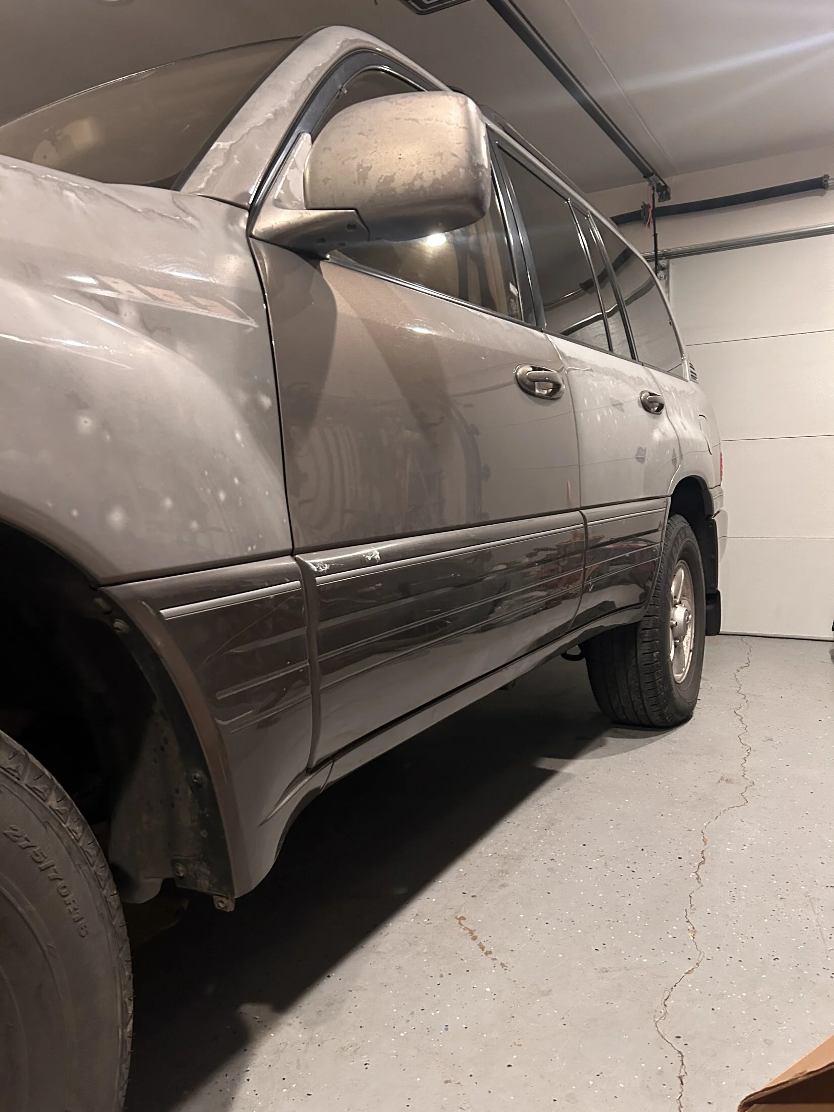

Have some BFG KO3’s in 285/75R16’s arriving this weekend and just took off the sidesteps this afternoon. I figure I removed about 40 pounds in sidestep weight and another 50 lbs of dirt that had built up inside them. :p

Took off the sidesteps today… safety glasses were a must as I took off 40lbs in sidestep weight and 50lbs in accumulated dirt and rocks. 😅

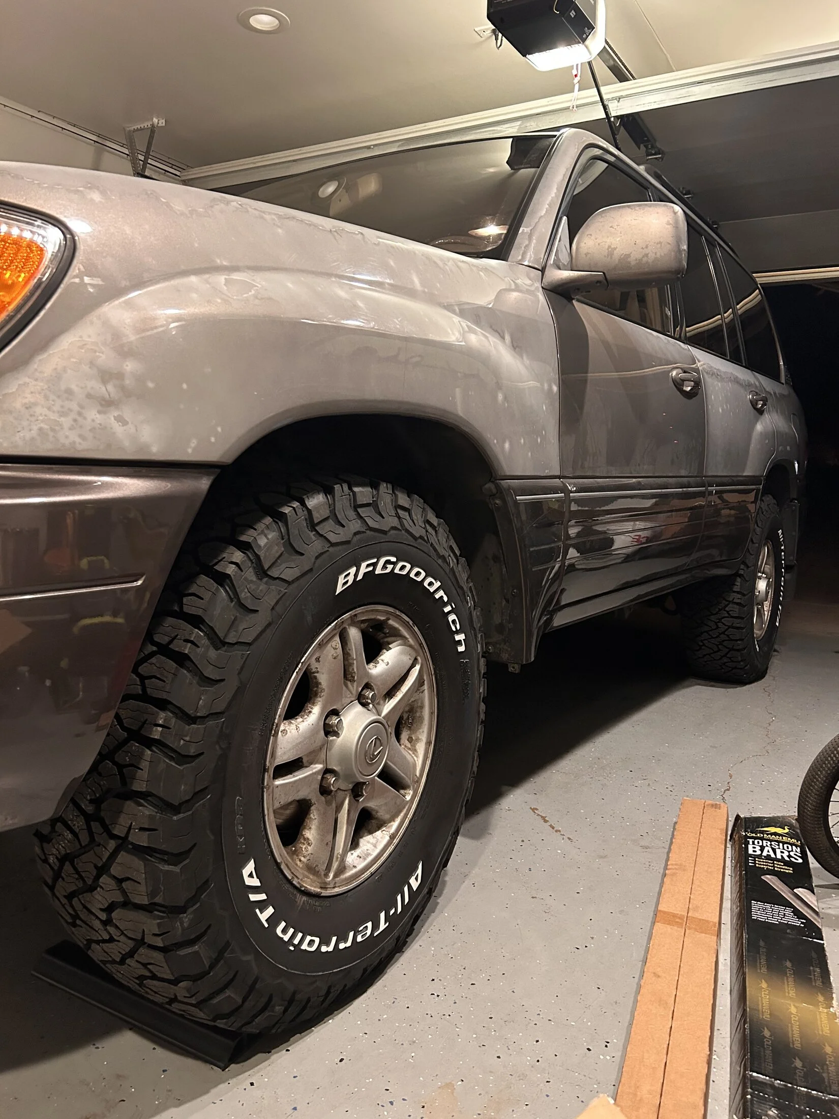

Last weekend I disconnected the AHC and installed OME 2865 springs and OME torsion bars and OEM shocks all around. Got the torsion bars dialed in to within 1/2” of where I wanted them and then slapped on the 33” KO3’s today. The ride height was magically spot on after the install!!! Can’t wait to get out in the dirt with her… got some more cleaning up to do on the underside and want to remove all the AHC components along the frame. Sliders are next…

Haha I was unwilling to spend 4-5k to bring the system back to life. The globes were bad and it rode super rough. Also wanted more weight carrying capacity for a high clearance bumper down the road so the standard suspension was the way to go. It’s rides fantastic now with the 33’s.
