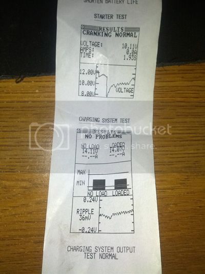

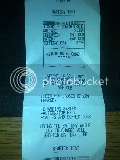

Last week I replaced my broken antenna mast but when doing so I killed my battery from all the ups and downs of the antenna. I didn't have much time or options so I went to a local auto parts store and got the lowest priced battery that fit the min spec's for the vehicle in the computer that had - 650CC. Worked great but over the next few days I noticed a slower than normal cold start time...3-5 seconds sometimes. (newer starter) I also noticed my headlights get brighter when I rev the engine which I then thought could be an alternator issue possibly. It has been cold here...around -5 at night and 20 during the day.
Anyways, I went back to the parts store and they did this battery test and said pretty much they don't know what's wrong with it but the battery is good and the alternator doesn't look bad but there is some draw/pull on the system. I did have BestBuy hook up a Navi/CD player but that was 7 months ago and never had any issues until I messed with that darn antenna mast! He suggested I just wait it out and see if I have these issues as it gets warmer but I'd rather get the issue fixed. Should I take it to a mechanic for an alternator test or just get a new alternator or a higher CC battery?

It doesn't sound like you have a battery issue. The battery is ok unless you plan on running a lot of extra accessories. Due to the changing headlight brightness, you might want to get the alternator checked to, hopefully, eliminate it as a problem. If you do have a draw, as it continues, it will take less and less time to drain the battery. The extreme cold doesn't help either.

It kind of sounds like an alternator if the head lights are dimming at idle. But your truck is charging at 14v, which is good. Things I would check, the circuits like the previous poster mentioned, your battery cables, terminals, and ground, consider you might have a pulley or AC compressor seizing up (wouldn't explain dead battery, but maybe the dimming lights). You mentioned you purchased the minimum required battery, what size and brand did you get? I suppose it's possible it could still be a bad unit, even with good readings. Were you having these problems before the antenna repair and battery replacement?

Another important question, is the battery losing voltage while parked? You can test it with a volt meter after it's been driven and then again after it's been parked for a while.
Being minimum capacity and sub zero temps I'd get your battery on a good, smart charger and let it do its thing. If you installed a maintenance accessible wet cell then you should charge to the correct temperature compensated specific gravity. That's the most accurate way of assessing the health of a conventional battery. Don't rely on the alternator bringing an undercharged battery back to its full capacity. As mentioned by others, ensure your terminals and chassis ground are clean, no corrosion and tight and when testing the terminal voltage be aware that the measured voltages will vary pretty significantly depending on if the battery is warm and the vehicle has just been driven compared to cold and been sitting overnight. A warm, just driven battery will have a float charge and will give a higher voltage reading than when the float charge has diminished (overnight sitting or run the lights for a couple of minutes) so you can be seduced into thinking your battery is fine/ok when its not. Chuck some jumper cables or a starter pack in the back too ;).

I would look at your battery cables the drop at startup could indicate the starter trying to pull too many amps due to a bad connection.
Then I would look at your alternator. I don't like those ripples in the output. I don't know for sure what normal is but 36mV seems excessive. It can say its within specs all day, but I will bet your voltage regulator is working overtime to keep it in spec.

Couple things.....any chance the antenna motor/wiring from the R&R work is draining the battery? Can you easily unplug that motor wire and see what happens. It's challenging to test a battery with the short term tests at auto parts stores. Those tests don't catch slow (overnight) battery drains from internal defects. That could cause your symptoms. New batteries fail, especially if they have been sitting on the shelf for a while and are sulfated. What's the date code on the battery? All things considered, I suspect the new battery or the antenna motor, since those are the things just replaced.
