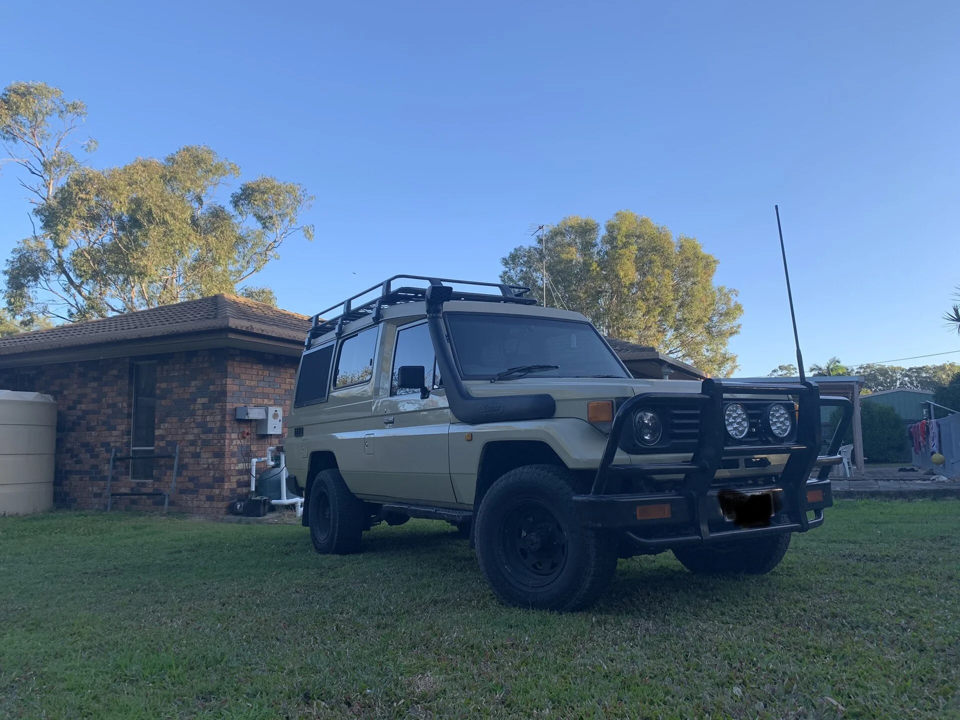

Looking at doing my fitout pretty soon and want to make living in the fitout easy and worth it. That being said I want to be able to cook and clean inside, so my dilemma is wanting to clean inside using water. So currently I’ve got a 40.5L poly tank under the car in between the rear chassis and secondary fuel tank. I’ve already got a pump and inlet and outlet mounted via the Thornburns utility panel on the driver side rear. So I won’t be able to utilise that pump for cleaning inside as I currently use it for external use. My idea was hopefully utilising a T piece before the pump going to the inlet, and off that T piece using a foot pump and pumping up to a faucet as such and do a temporary collapsible sink. But only issue with that is the foot pump I was looking at can only do a 1.5m head which I will be getting close to that limit. Mostly my issue is if anyone has had a similar situation or even better ideas at all I’d be open to suggestions. Cheers legends!!
