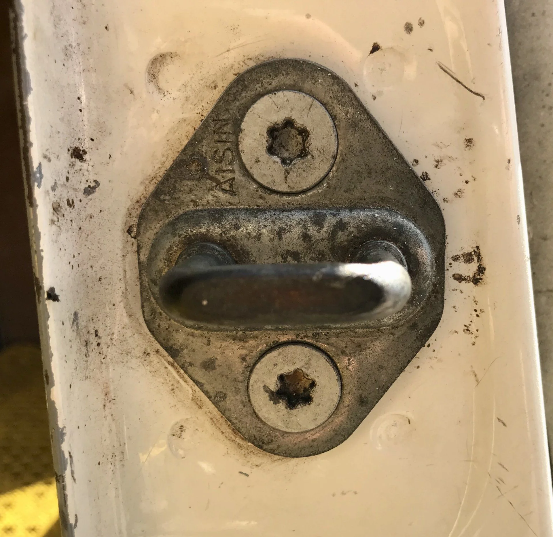

ok, so i took a small step to try to solve this problem. just adjusted the doohickey on the larger door that the smaller door's lock mechanism hooks onto (I know, my mastery of auto parts terminology is awe-inspiring). the smaller door doesn't have to travel as far now to engage, and much less force is required to shut the thing.
the drawback is that the two doors are just a bit out of alignment now when shut. i think the weatherstripping is still sealing all the way around, and we'll see how it fares in the rain in the coming days. the photo exaggerates the gap because i took it from the side, it's not quite as bad as it looks.
if the disparity is too much, i might have to adjust all the strike plates and thingamajigs on the big door side. hope i don't have to, since one of the lower doodads has these big phillips type screws that won't budge. anyhow, happy sunday everyone and wish me luck.
