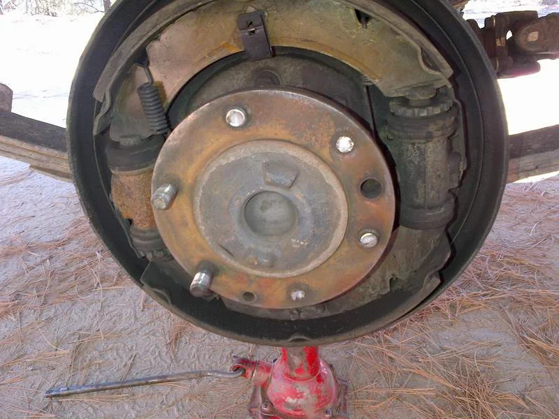

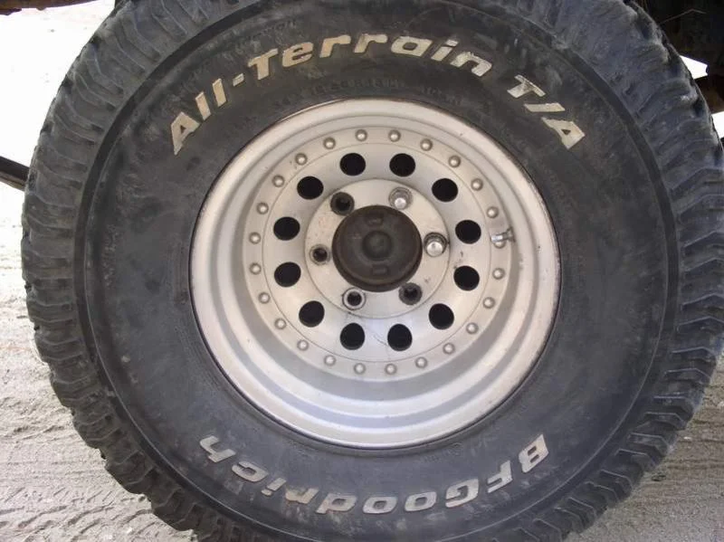

All of a sudden, after turing a sharp U-Turn (hairpin) after the bumps, I heard this Helicopter sound... Hmmmm...
Drilling / Pounding out those 4 studs was a nightmare... A buddy came up with a truckload of tools & equipment (generator, drill, grinder, etc.)
We finally got back on the road right about sunset...

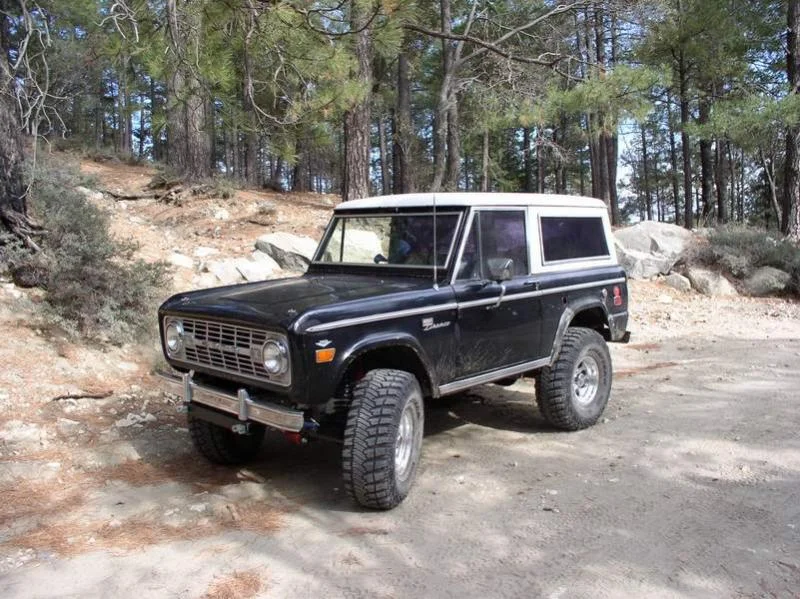

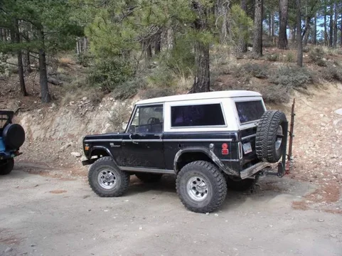

My Buddy has a great Bronco...

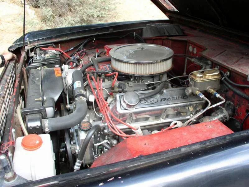

Anyway - we spent a lot of time "preparing for the work to come", i.e. hanging out, drinking beer, eating, and enjoying the beautiful day, while supplies were mobilized from Tucson. Here's a couple pictures of his rig...

Those lugs are a beast!! I spent an afternoon couple of years ago trying to bang out 1. Big ass headache!!! Glad you were on the highway when those things went. Glad ya had a buddy available with mobile tools. Glad a got back safely. Happy Trails!!

I am seriously considering getting rid of these aluminum wheels and going to steelies....

I had 3 of those bust on 2 wheels before. I've since replaced them all and keep spares in the rig. :hillbilly:

PS> I did learn a good lesson on keeping spare studs / lugs in the toolbox...
Curious you didn't replace them while the axle shaft was still in the axle? Never had a failure on the road so always did them at home. For trail replacement I would carry a good hand sledgehammer, couple of brass punches and deep socket. Deep socket more for protecting the threads while seating the new stud.
