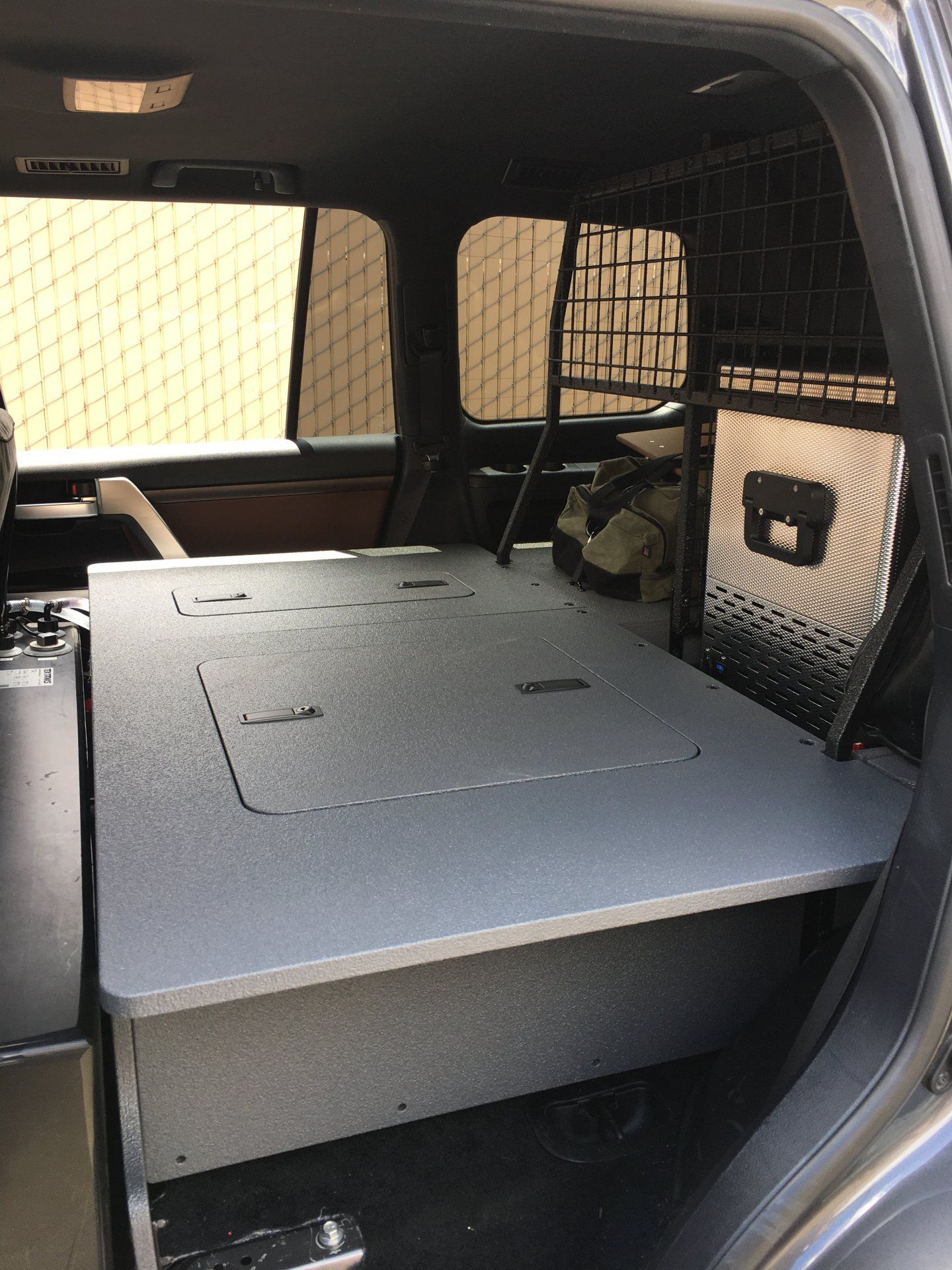

Hey guys,
A recent PM conversation prompted me to post this for your consideration. We are finishing up the prototype of a fridge-half only system for the 200. Even though we've had plenty of requests for this system, I was hesitant. A few years ago I had quite a few requests for a half system for the 100. I made it and the sales were poor to say the least!

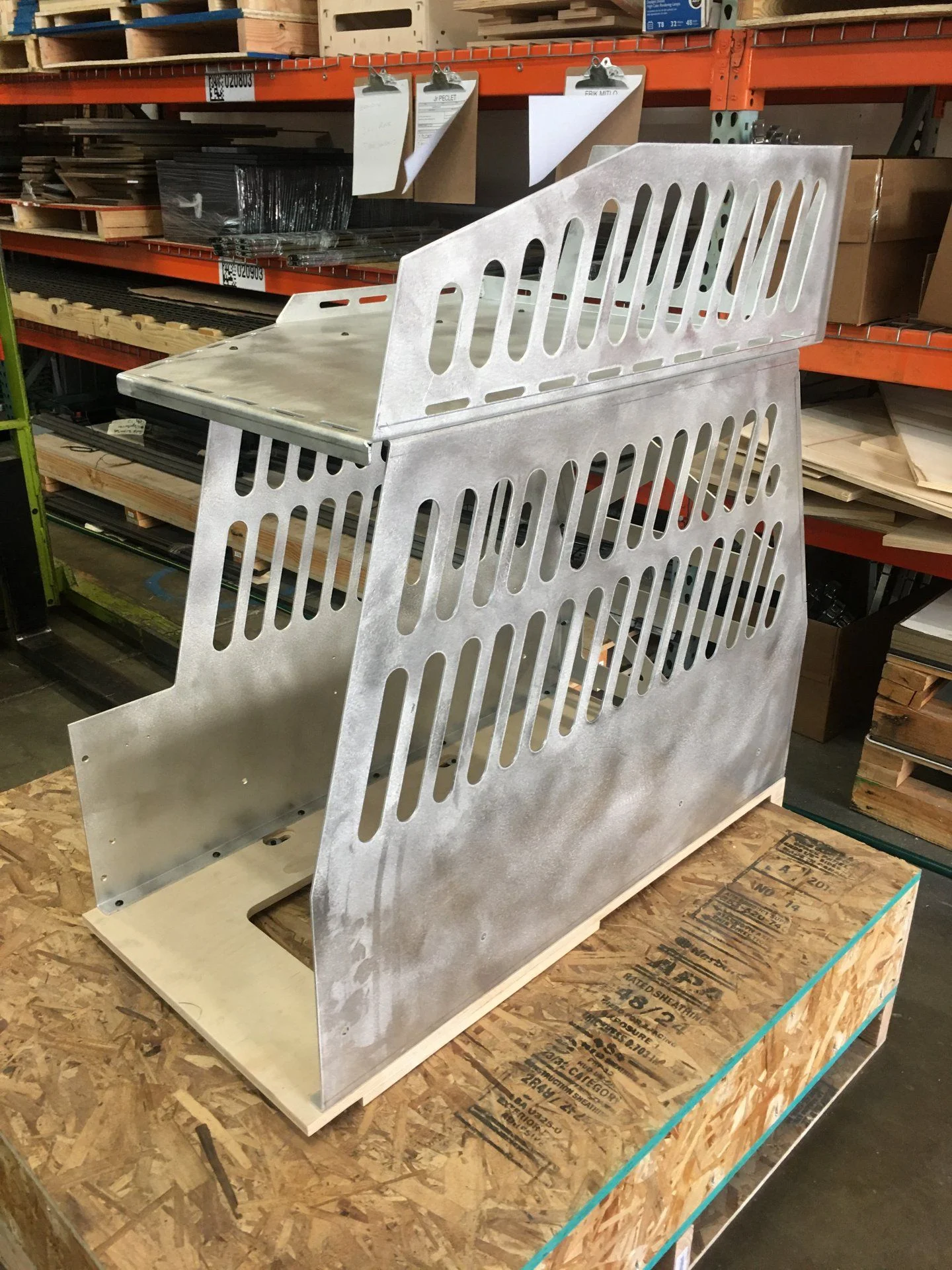

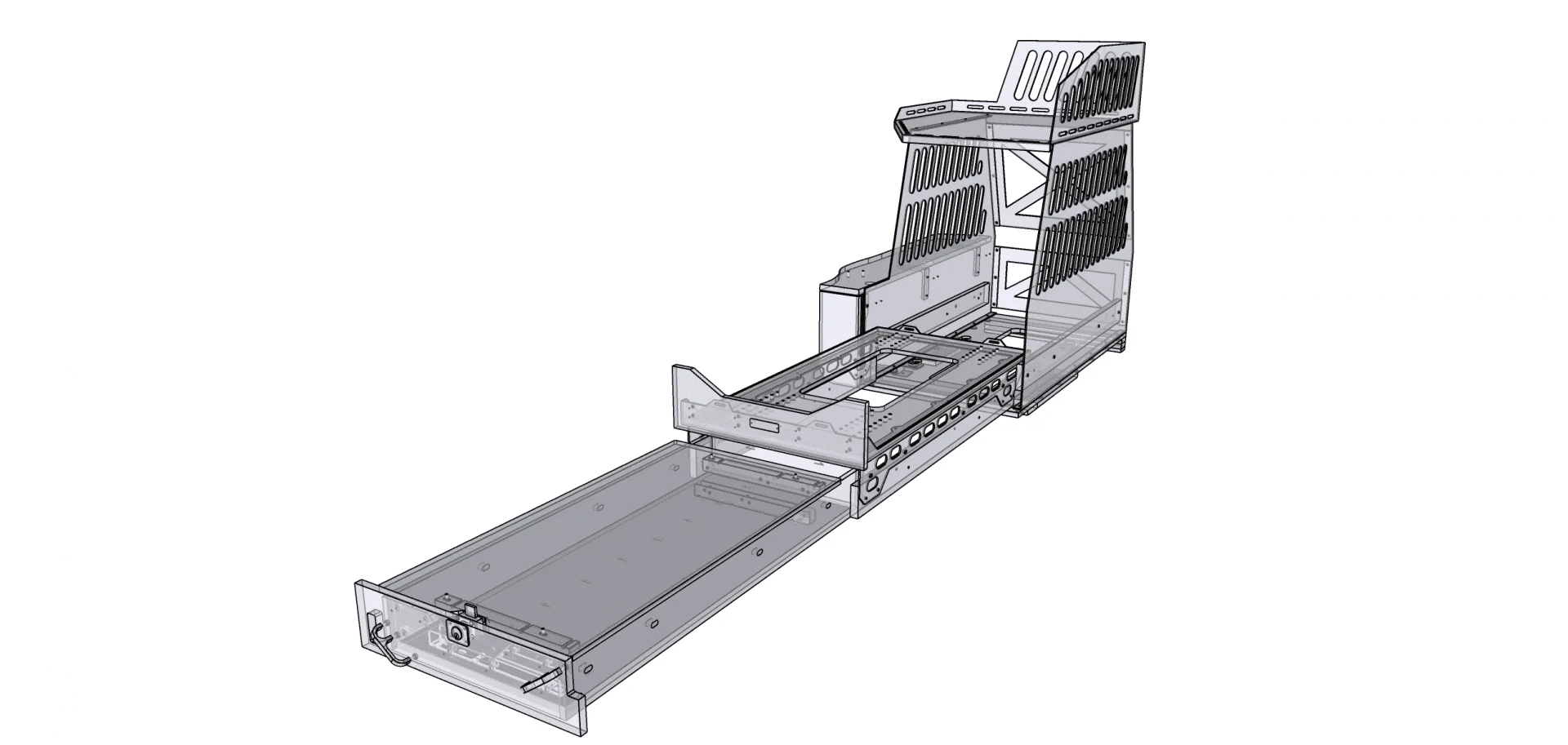

This system had some decent design challenges. You see, the 200 is actually 2.5" narrower between the wheel wells than the 100. This puts the fridge half of our regular Alpha well past the midline of the vehicle. So, for those folks who need to run one of the 3rd row seats we needed to do some magic to get a decent sized fridge to fit.

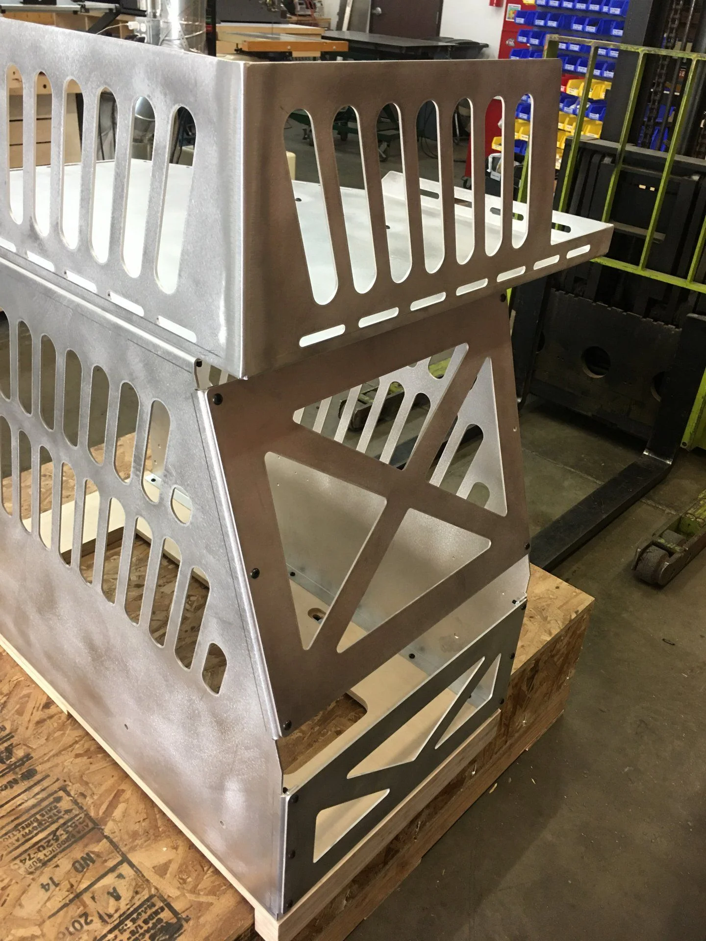

For the walls and shelf we switched to 1/8" laser cut aluminum plate. We lowered the drawer slides to be nested next to the shallow drawer with some tricky bits. As you will see, both the locking slides for the fridge slide and the shallow drawer are accessed at the shallow drawer level. This allowed us to keep 19.75" of fridge area width, minus some mounting hardware that will protrude into the space.
The shallow drawer will run our newly standard stainless lift-hinge setup. I will post updates as we get further along. I'd love to get your feedback!

Hmmm........the bugaboo for me and drawers/slide has always been that I have keep the right side of the cargo area available to occasionally re-install one 3rd row seat. My LC is currently being used by my son's family on vacation but when they get back I'll measure my rather wide fridge to check on exterior width with its "jacket". This could be interesting.
Very cool! While I don't have any intention of reinstalling either of the third row seats I am exited to see a narrow fridge design since our camping style is well suited to a modestly sized fridge or cooler. I have been mulling over a drawer system for a while and the only thing keeping me from ordering the Alpha is that the divider is past mid-line and I need more space for two Huskies (they are okay snuggling up).
Sure I could go with the Beta, install a drop slide and retrofit a barrier but I really like the lower CG of the Alpha and having a shallow drawer with the new linkage-actuated Richlite surface. So....is there any chance that this new design could transform into a "narrow-fridge" Alpha system?

This will still put us in the 18.75-19” range, but that’s about as much as we could get without cutting plastic.

Not sure. Actually, another announcement I need to make is that our latest 200 Alpha has a wider fridge area, not narrower. As time passes people want to install larger and larger fridges. The new version accommodates the Dometic 75 dual zone which is popular. However, I was able to make the fridge area 1” wider without losing any space in the large drawer. But going back to an even thinner fridge area (and the R&D that goes with it) seems unlikely. I can do custom work but try to discourage it- it gets costly.
I would definitely discourage a drop slide setup in your case. They are very wide for what they are. You’d most likely have less space than an Alpha.
Another note- any drawer system that covers the wheel well area will give your pups more room (floor space) than the floor itself. I’m sure you know this, but it is a discussion I have a lot.
