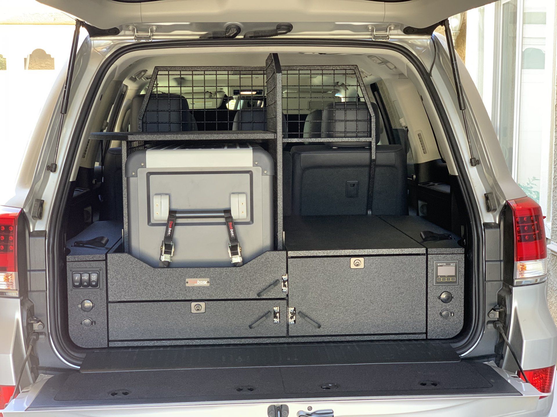

Actually, another announcement I need to make is that our latest 200 Alpha has a wider fridge area, not narrower. As time passes people want to install larger and larger fridges. The new version accommodates the Dometic 75 dual zone which is popular. However, I was able to make the fridge area 1” wider without losing any space in the large drawer.

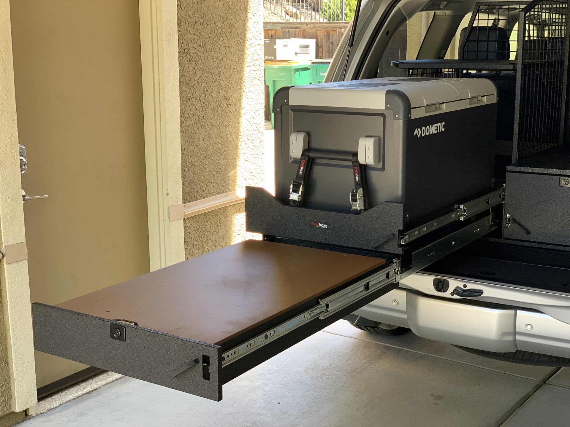

Since you are announcing other things in this thread... may I present the Dometic 75DZ in the Alpha:

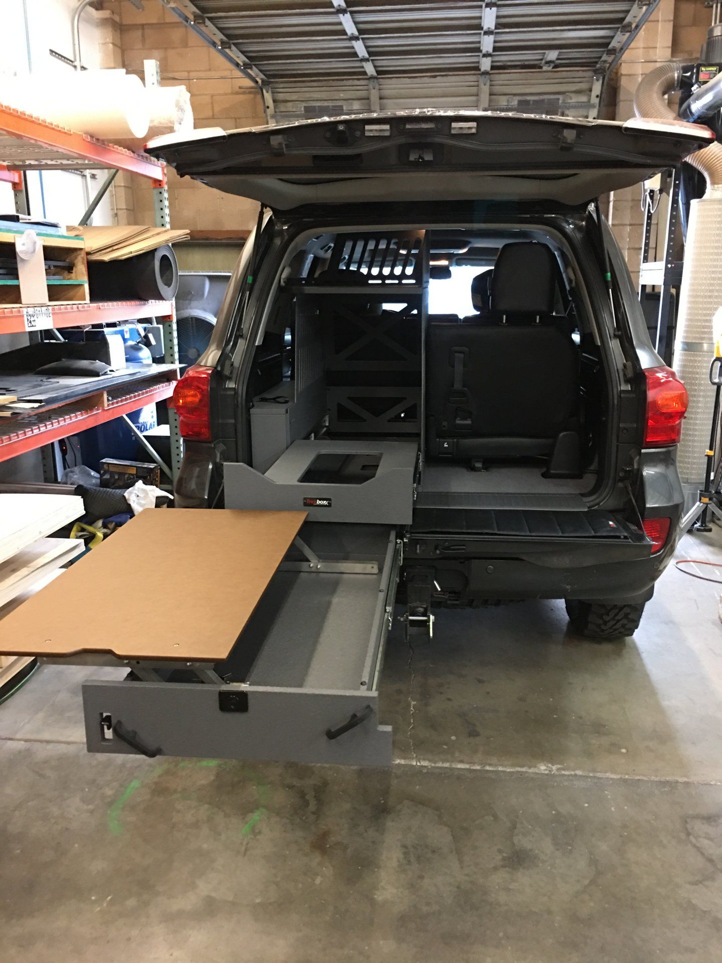

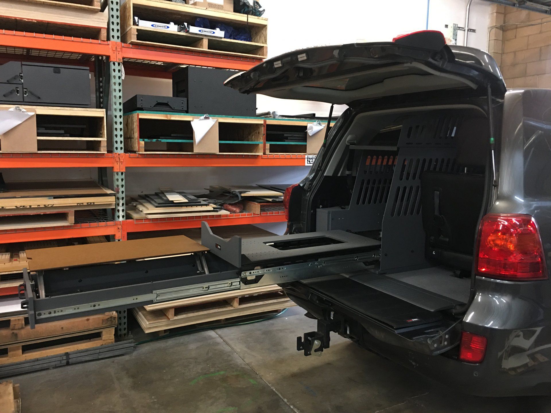

Thanks. But to be honest, the aluminum may look cool but so far I'm not loving it. The original is much more rigid. I'm going to re-work this one to gain some lateral stability.
Everything is a compromise. A "narrow" fridge version would really only mean an inch or two max, and a lot of sacrifices have to be made- higher cost, less rigidity, much smaller work surface and shallow drawer, no shelf adjustability, and less intuitive latch setup (shallow drawer opens with latch on left. So far this one is looking at being around the $3750 price point, and not much margins at that.
I highly doubt I'll use this design in my regular systems. They are bomber and I think worth the small sacrifice in material thickness to gain the above benefits.
Having said all of that, I could see getting what you want with the above system and a larger separate drawer on the right. Wouldn't be too hard to bolt them together and would make a somewhat larger sleeping setup.
Thanks for the feedback David. Yes the lack of height adjustability for the shelf is a sacrifice and depending on the fridge could leave quite a bit of wasted space below the shelf over the fridge. I can see how the rigidity of the walls would be reduced especially at the open end where it has no bracing. If using a fridge that leaves a gap on top a simple solution might be to install brackets into the corners above the fridge for some triangulation. But in spite of these trade offs a larger right side drawer and sleeping platform are very appealing. Thanks again.
