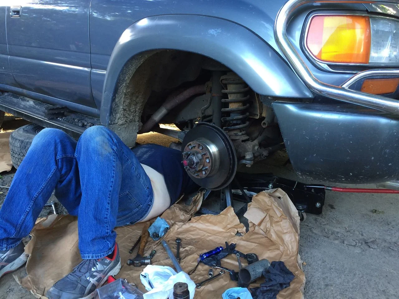

Oh.....and pull up your pants while working under the truck!:eek:

Oh and .. about pulling up my pants, the picture was taken by a friend at a bad moment, i was bitching about the darn 14mm of the front DS that were over tight like hell, in a less then spacious place. ;) -- rest assured, all the white stuf you see is my northern winter white belly, not my ass
