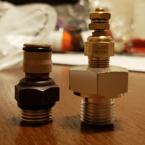

I pulled out the factory temp sensor (for the over-temp light) and found an adapter to work in this location.
The factory temp sensor thread is an M16x1.5, so I picked up an M16x1.5 to 1/8" NPT adapter. It turns out that it is really common for people to install LS motor aftermarket oil pressure sensors.....which coincidentally use the same threads, so they are readily available. I picked mine up from Amazon for $10.
The gauge I used was the Auto Meter 4357. This comes with an 1/8" NPT temp sender.
After getting it shipped to me, I found out that the adapter was a little too tall for the gauge that I ordered:
The hex portion of the adapter was also a little too big in diameter and was interfering with the factory fitting:
In order to make the adapter work, I had to grind down the end a bit, grind down the hex, and tap the NPT threads a little deeper. Final depth was .370" from the mounting surface. I put the factory O-ring on the new adapter. Those of you with fab skills could do a much cleaner job, i'm sure.

Yes, this replaces the factory sensor in the trans line. Also, the depth was ground down to .370" on the adapter, so that it matches the same depth as the original sensor. This means the reading is accurate, and doesn't interfere with fluid flow (any more than the OEM one).
