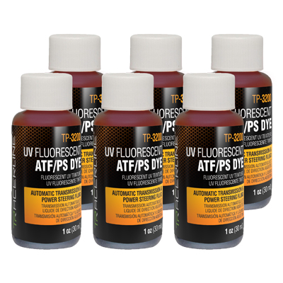

I would clean that area off well, then closely monitor the leak, starting from the power steering pump and transmission cooler lines to ensure it isn't being blown back from further forward.
Or, try this:
