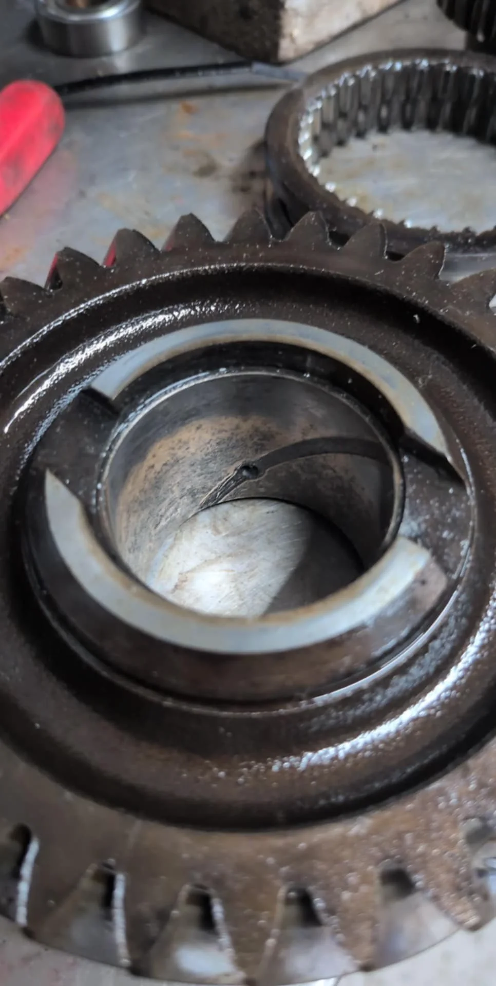

Came across that rebuilding my transfer case ... If anyone knows we're I can get some to replace the worn ones that be great ....
Marlin crawlers sells a set but it says 38mm ... My idler shaft is 38mm but these bushings float over a 40mm shaft so I'm a bit confused and I rather not have to make them in the lathe since it's soft material and pretty thin....
90999-73079 is what you want. The 38mm on Marlin's site is refering to the transfer case idler shaft
