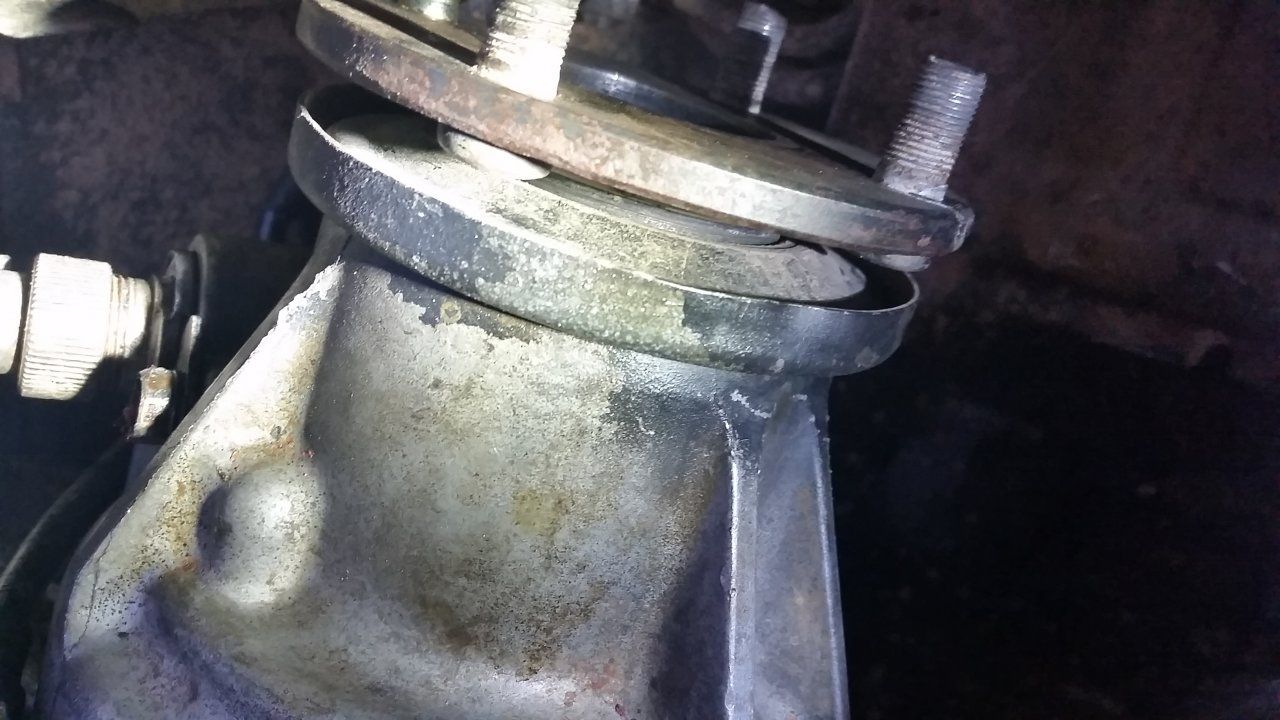

This is how it should look.
A snall hammer and a couple flat head screw drivers should be all you need to pop it back into place. Pay close attention that you
A) get the inner half seated properly.
B) ensure there is no contact with the outer half.
Put the xfer case in nuetral and drop the shafts...or get the wheels off the ground so that you can spin the rear output shaft to make sure nothing it's loose or touching the other half of the high hat as you put it.
Job done, thanks for the tip. Small pry bar, gentle leverage and it just eased home like it was a brought one.
No more clanging, cheers.

Did it look like this?
That's what happened. Did the same thing, pry it back in gently with a screwdriver. it worked!
