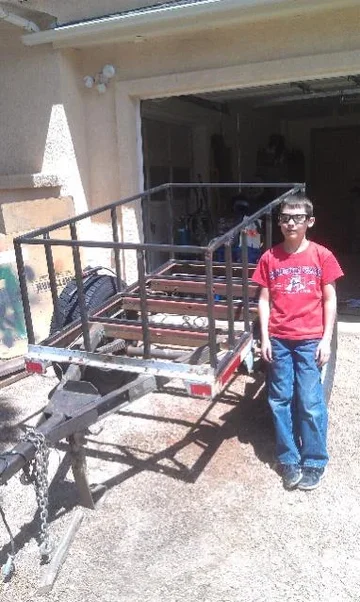

Finally got to work on the M-416 I got years ago. I decided that the tub wasn't salvagable - at least not for a camping trailer with any hope of fitting a tight lid. It will do for firewood & such.
So I'm building a new box for it. Pic below shows it setting on the frame. About 1/3 of the welds are burned in, the rest is just tacked. Have a frame for the lid done also. I'm happy with how its come out so far. Was pretty proud of how square it was - until I laid it on the frame and saw how much that is racked!

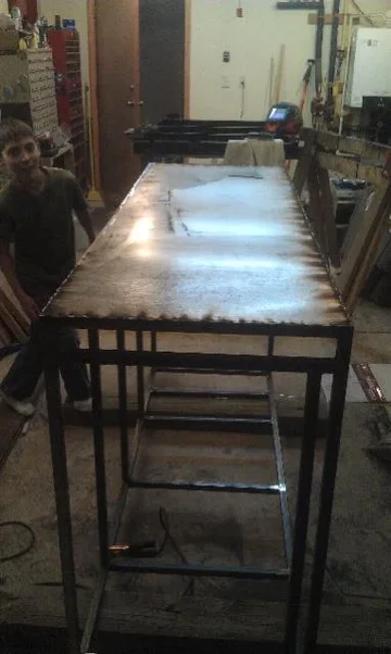

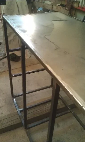

Got the sheet metal yesterday, and got the first piece on today. For this first piece I decided to weld the entire edge. It looks pretty good, but I definitely have to switch to the technique Luke mentioned earlier - this takes forever and is going to kill my gas. I may be in trouble on gas anyway - anybody have a bottle of C25 around? I'll return it full next week.
I think I was pushing the duty cycle on my welder also. Last bit was really ugly.
Didn't take any pics, but 4 out of 6 panels are on! First one has more waves then the ocean, but the rest look pretty good. I'm back to fully welding the outside edges - just like the way it looks better, and I've gotten much better with the welding. Tighter, cleaner, less heat, faster, etc. I guess laying down 30' of bead will do that. I also gave up on the weld-through primer that I tried on the first panel. I used it out of concern for rust between the frame and sheet, but I just can't get a decent weld with it. I think it works ok with bigger wire/hotter welds on heavy material - I used it on my trailer hitch project. But not on the sheet metal.

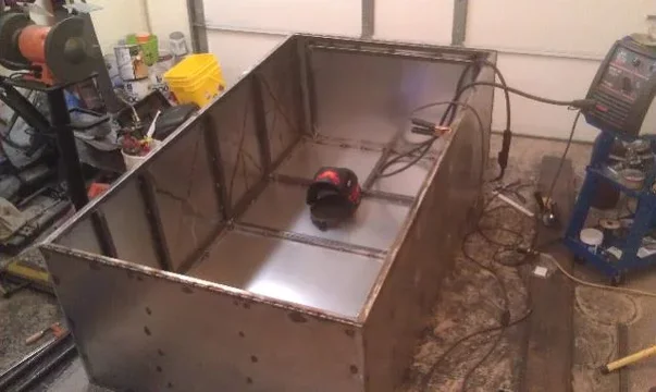

I haven't been very good about keeping up with the pictures, so here's a few before I go out & get to work.
A few of the tub, including the lip I added for the gasket around the tailgate.

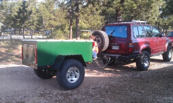

Ready for the road
