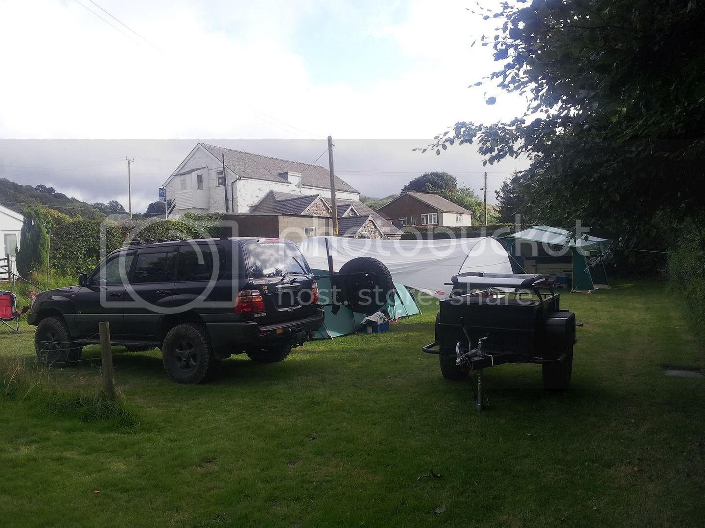

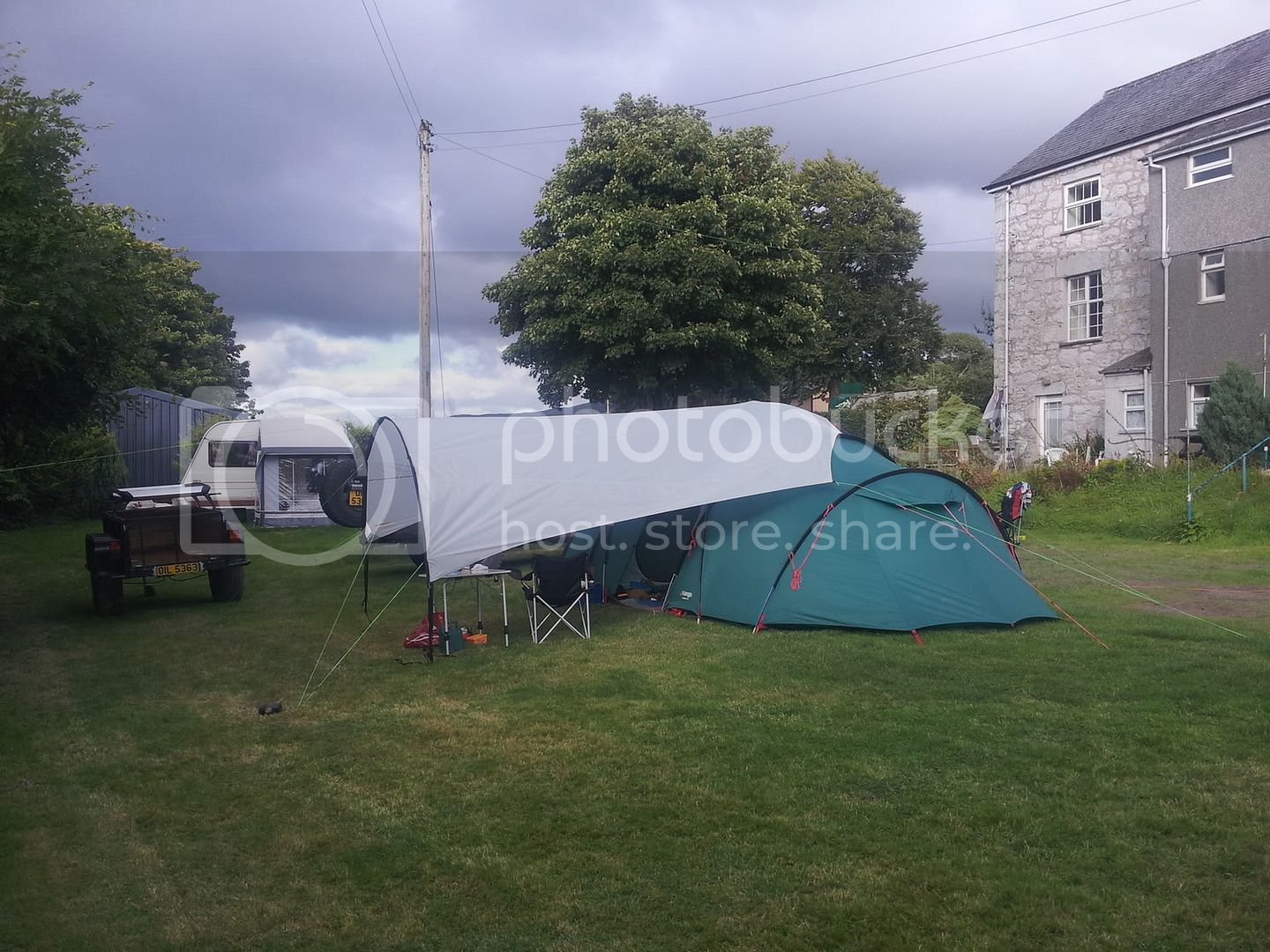

Our camping set-up for the long weekend... The tent is pretty good & packs down to a good size but its a bit of a phaff to put up & there's not a great deal of living space for wet days & six of us so I hope to replace it with an JetTent for next years camping season. The Coleman tarp did well though :cool:
I spy a trailer...

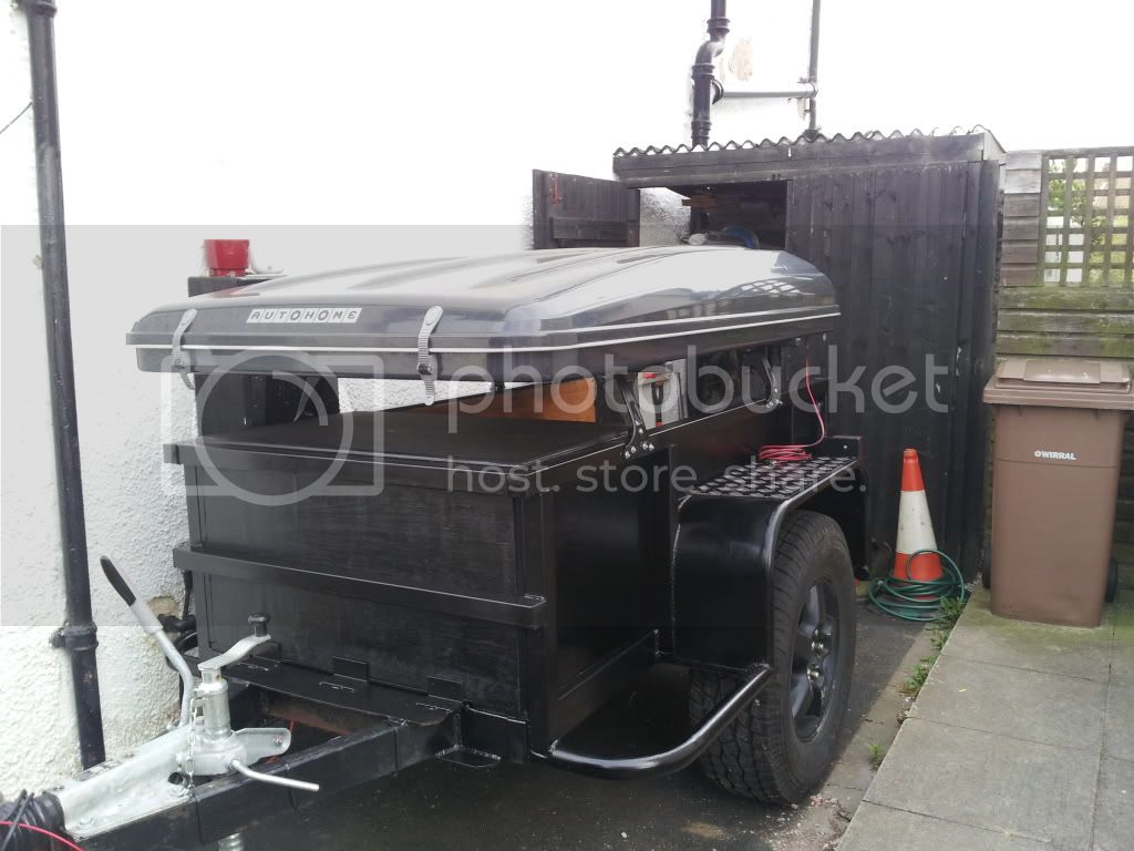

It had my Airtop tent fitted before the trip & I put that Thule rack on top rather than haul the Airtop around; dinky little rack :rolleyes:
I managed to keep rain off our kit with a cheap tarp for the journeying but that won't do for an extended trip.

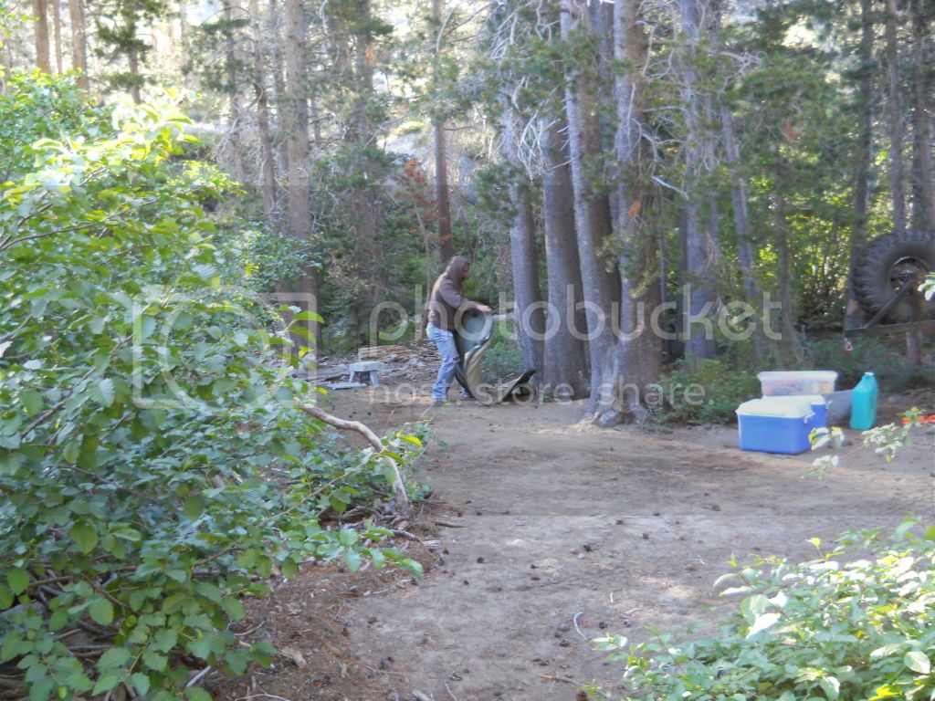

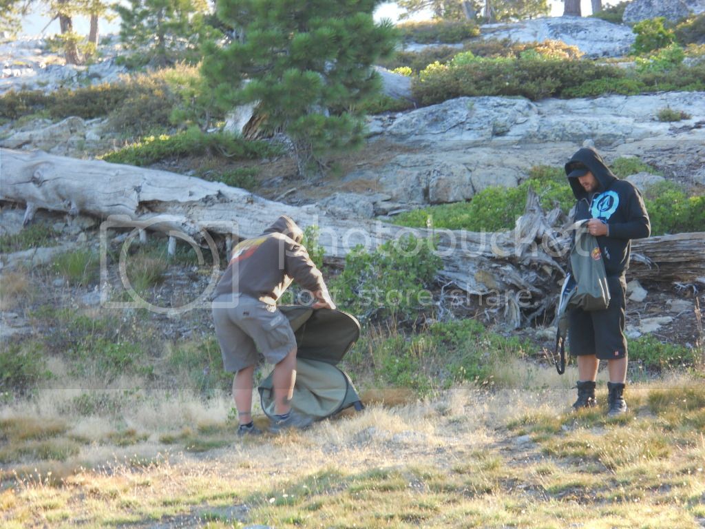

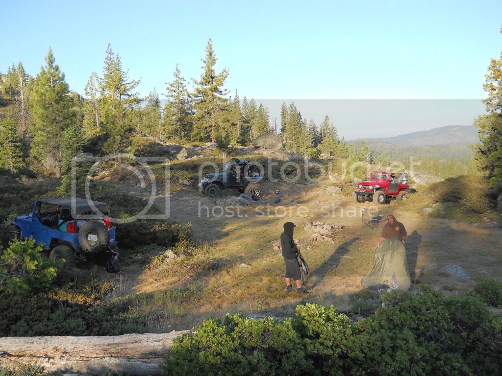

Both those sites are about as far as you can get from a farm yard.
The first is on top of a ridge in the Sierra Nevada Mountains, the second is in the middle of one of the toughest 4WD trails in N America.
Here is another view of the first site
Notice that the battle of the privy was raging.
Here is another view of the second camp
