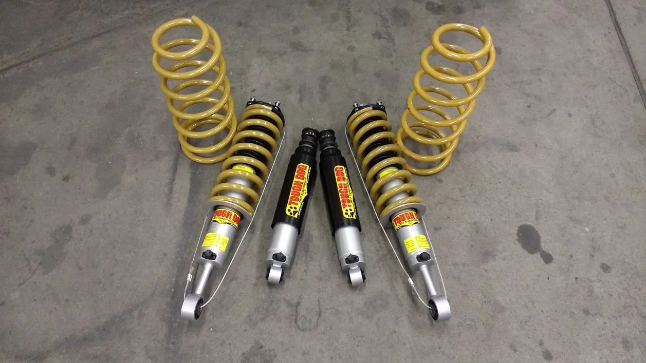

Finally receive the suspension yesterday. Thanks Jason and Austin from Sherpa off road for the group buy.
I Install it this morning. Took about 9 hours total. The kit was installed in about 4 hours but the passengers side was assembled the same as drivers side. The adjuster is facing inside instead of facing out. Not a big deal. Took extra 15-20 min doing the no spring compressor spring removal and flip the Strut 180°.
The worst thing is trying to adjust caster. The alignment tab folded over and render the cam bolt useless. Have to come up with a few different methods to pull the front adjuster bolt inside for more caster. I need to get total chaos beefier alignment tabs. I have to pull is inside using ratchets strap.
No real test drive yet. But initial impression is very good. Damping are properly matched to my truck. With KDSS help the sway I set the front at 5 and rear at 4. The load range E 255/80r17 Toyo Open Country II seems to feel a lot smoother over expansion joints. Tough Dog recommend 4-6 for highway driving. 1-3 off road and 7-9 when heavily loaded or towing.
I got 1.5" even lift up front. 21" from wheel center to top of front fender opening.
Rear are 1" taller but this was based from my truck that PO put in StrutMaster coil spring conversion. I strongly believe they are at least 1"taller than stock. 23" from wheel center to top of rear fender opening. Even height left and right. No KDSS lean.
