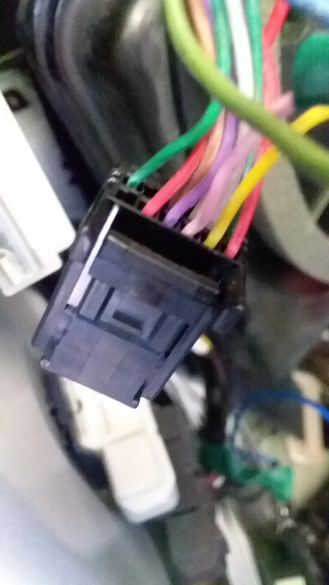

I did the tpms bypass for the 460 and what I went by was the guide that said the yellow wire gets bridged to the pink wire on the harness.
I did that and added a switch between them so that I could toggle it on and off if I swapped highway tires for a long trip etc.
When I switch it to disable, it actually comes on intermitantly and actually looks like it corresponds with road vibrations. No other system sensors are triggered.
I soldered in two leads coming off the yellow and the pink wire. These go to a toggle switch. I swapped the switch and even used a jumper wire. so its not the switch. It's not the soldered lines as I had them crimped and switched to solder and no difference.
It would possibly be an issue with the factory harness plug into the tpms module but it works fine when in factory mode.
Is the pink or yellow wire the best choice for a 5v signal? Could it be the signal is intermittant?
Is a different wire a better option?
I tried the red wire as some said pin 5 and 6 where pink may be red. Still no dice. Still comes on and seems spotty.
Will solder a connection and try again on red.
I'd suspect a loose harness plug but tpms works fine when not bridged. Just cant seem to get a good signal, for the switch.
Is it spotty if you're just to jiggle it in your hand under the dash? Or is it only spotty when you're driving.
Spotty when I'm driving, but can't see it when I jiggle it.
I did the red wire and my check engine and 4lo light came on. Threw code P0500 - speed sensor.
I think that red wire may be the speed sensor and it was thrown off.
I'll have to do some multimeter work. I didn't really want to bridge the circuit permanently

Sorry guys, I'm an idiot. I spent all that effort to grab the wrong red wire (speed wire)....
I looked at it so many times and still assumed I chose the right one.
Humble Pie is a bit bitter, but I'll eat it.
"What does it feel like to be wrong?" = "Same as it feels to be right."
Wired it in 1 min (waited 1 min for iron to get hot) and its good to go.
