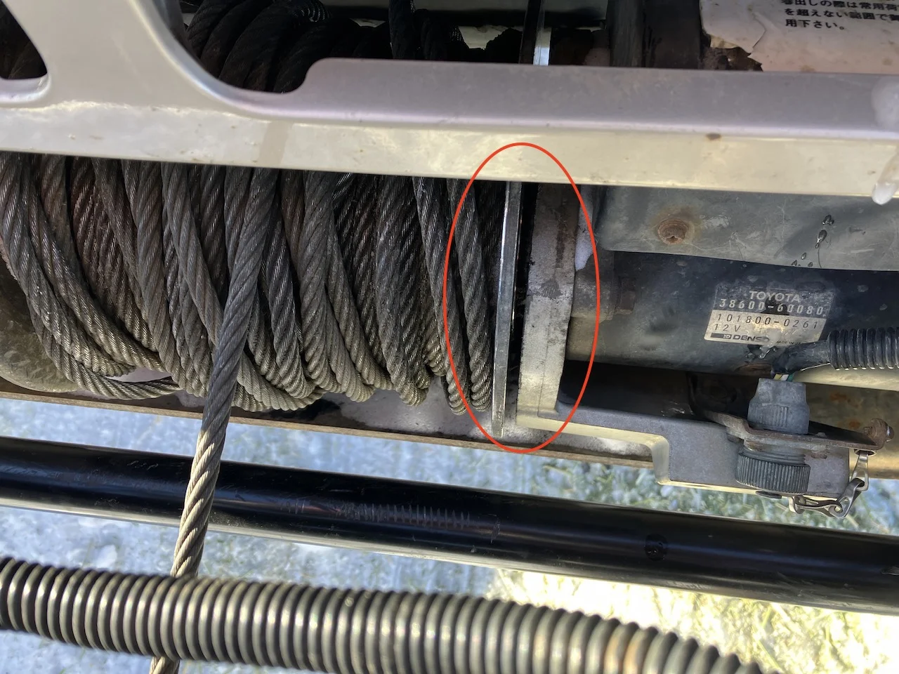

While winching a plow truck out of the ditch last weekend the winch cable jumped off the side of the drum and fouled on the motor shaft between the drum and motor housing. It took about 20 minutes of working at it with screwdrivers and pulling on loops of cable to get it un-jammed so the cable could be spooled in. This is now the third time I've had this happen, twice with the original bumper/fairlead setup and now once with my ARB bumper and aftermarket fairlead. Has anyone else experienced this? I would like to come up with a solution so it can't happen again. For reference this is on a 1991 LJ78 with the factory 12V winch.
Here is where the cable jumped off and wrapped itself around the drum shaft. The cable wrapped about 3/4 of the way around the shaft and was pretty well jammed in that little gap between the side of the drum and the motor housing.

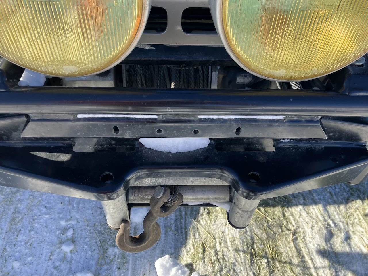

Another view of the current fairlead setup. I have noticed that the winch drum is not centered between the frame rails, it is offset by about 1" to the LH side, which might explain why it likes to jump off that side.
I have the exact setup on my 76. I had wondered about the slight off-center situ after using the factory plate and welding it to the ARB bumper. I did not want to drill holes and weaken that plate in order to center it. And it IS pretty close... just not ideal.

Good point on the snatch block, I should really pick one up to have with me anyway. Normally the cable is properly and evenly spooled (it was when I was pulling the plow truck). I don't think there is clearance between the frame rails to center the winch, but I may be able to offset the fairlead on the bumper to match the winch drum.

Ah, yes, I could not remember if there was enough room to move the winch over, and you just reminded me that is not a possibility. I suppose modifying the ARB where the fairlead attaches is another option for sure, I am just reticent to start hacking into it! Though to be honest, it could be reversed anyways with some steel, welder and fresh powdercoating...
