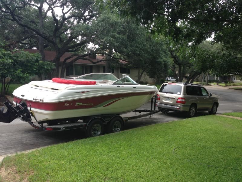

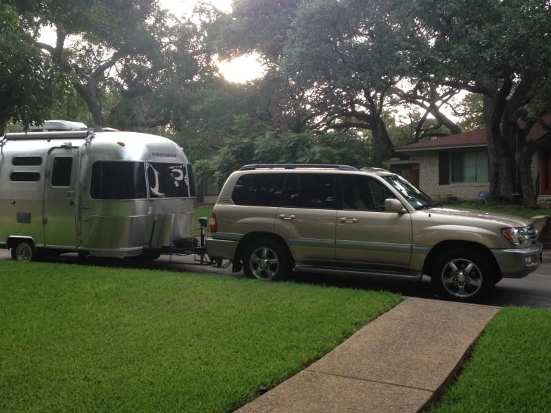

I tow a lot more than 5k on the stock hitch. Never had a problem. I'm not saying you should, just saying I haven't had an issue:
