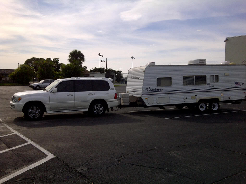

Towing difference is night and day. We have a 4500# travel trailer (no slideouts) and our 80 would struggle over 60mph on the flat roads of South Florida. 4-speed transmission didn't help either.
Ended up buying a 100 with the 5 speed. Tows our trailer great the few times a year we go camping BUT like most on here have stated, if you tow often, I would look elsewhere.

I towed my Lexus IS300 for a track day (~3450 lbs) + U-Haul car carrier (~2450 lbs) and it towed this combination effortlessly. Granted it's not as brick like aero as a camper. That's 6000lbs on my '06 VVTi LX470 which is only just under it's 6500 rated capacity.
I was able to hold 70+ mph up pretty good size grades with ease and still be able to accelerate. This is on 33's as well. The AHC held the load without issue. And everything was more stable and effortless than I could imagine. Based on that experience, I don't think I'd hesitate to tow something even larger/heavier.
Guess if someone really wants to tow a significant load with the 100, the premium of an '06/'07 model with VVTi may be justified.
